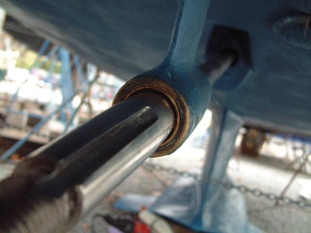

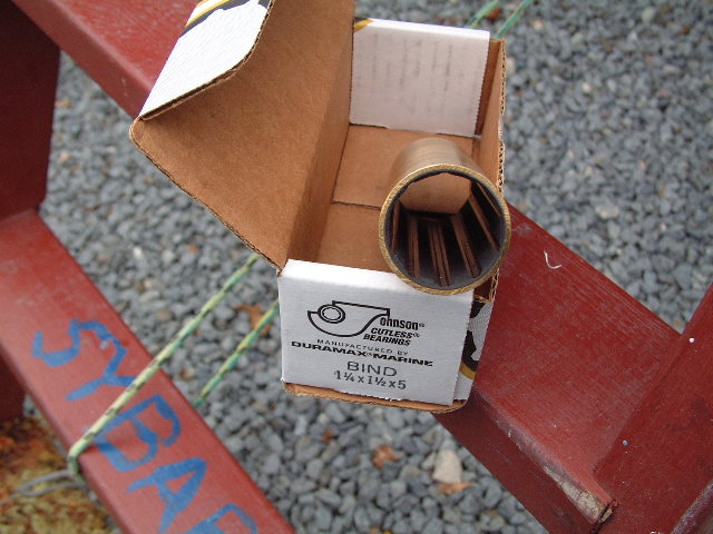

Relax, Frank, the shaft-in-place will work fine. I had my yard do this a year ago. I removed the prop for them and I supplied them a new bearing because they could not get one in a timely manner. I removed the prop because it was an AutoStream feathering unit and they were not as knowledgeable as I was with the removal and replacement. Pulling a standard prop and replacing it afterward should not add more than one additional hour to the total job.
Total shop labor was 1 hour each way, about $170 plus I paid $50 for the bearing.
The pictures below show the new bearing, the yard mechanic pushing the new bearing in place, and the final result.
