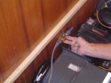

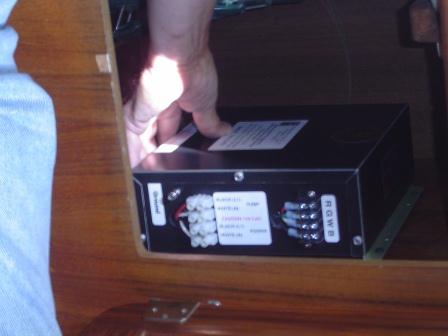

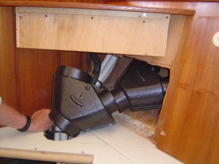

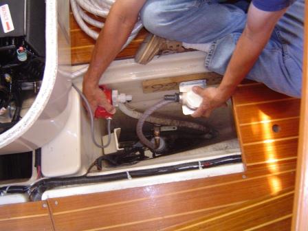

Bustedrudder,
I am not an expert at all about this but I did install a/c in my boat two years ago. I leaned on Rich Stidger for a lot of the preliminaries - especially the location of the thru hull intake for the a/c. You can see where i located the strainer and the a/c pump in one picture. Below it in the keel sump is the thru hull for the a/c. In other pictures you can see the location of the main plenum, the electrical box (under sink). The a/c water outlet is in a direct line with the grey object (condensator). I ran air vents into the rear cabin and forward as well. I'm not sure that I would run the vent to the aft cabin if I had it to do over again.
David
