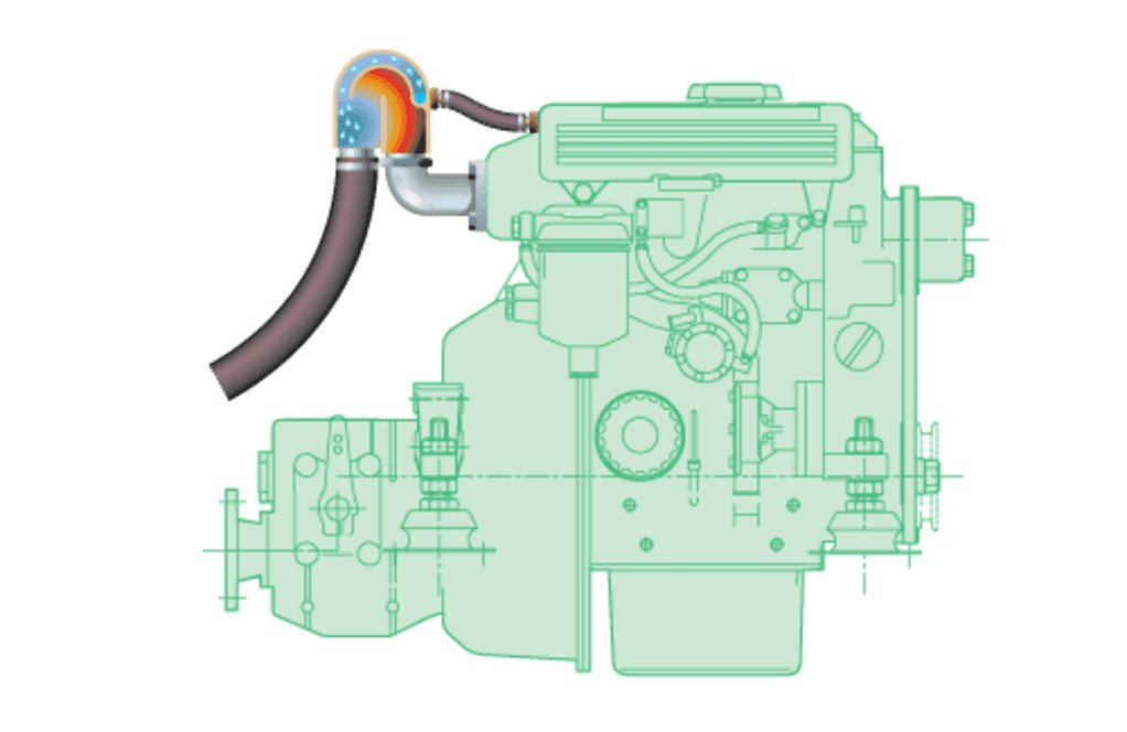

It is a high rise mixing elbow like this. My temperature increase is at the first 90 that points upward

I wonder if it could just be because that spot is in between the fresh water reservoir on the manifold and the raw water injection. The distance from both cooling sources might make that a hot spot. My 3ym30 has a simple 45 degree pipe instead of the elbow so I can't really shoot it to compare.

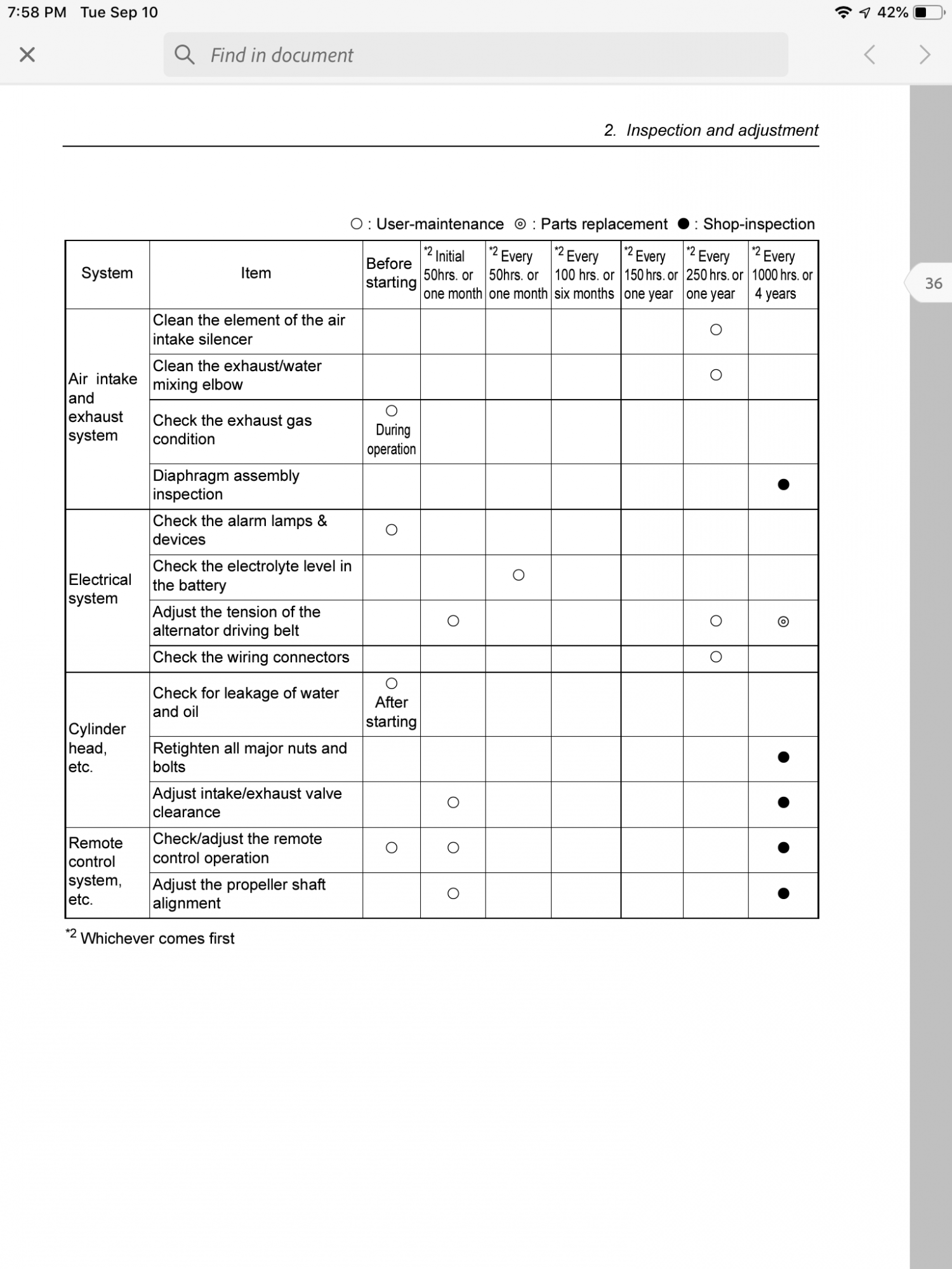

You have to take them apart every 50 hrs to check and clean. Start with taking the water inlet fitting apart and look in that hole to see if clogged. The unit threads apart so no gasket material is nessary for removal
Really? Many (most?) go 500, 1000 hours, maybe more, without a problem here. Where did you get 50 hours from? You realize you're saying that HALF the oil change interval you should be taking your exhaust system apart. Ha, ha!
By the book, the 3YM30 exhaust mixing elbow is to be cleaned every year or 250 hours whichever comes first.
