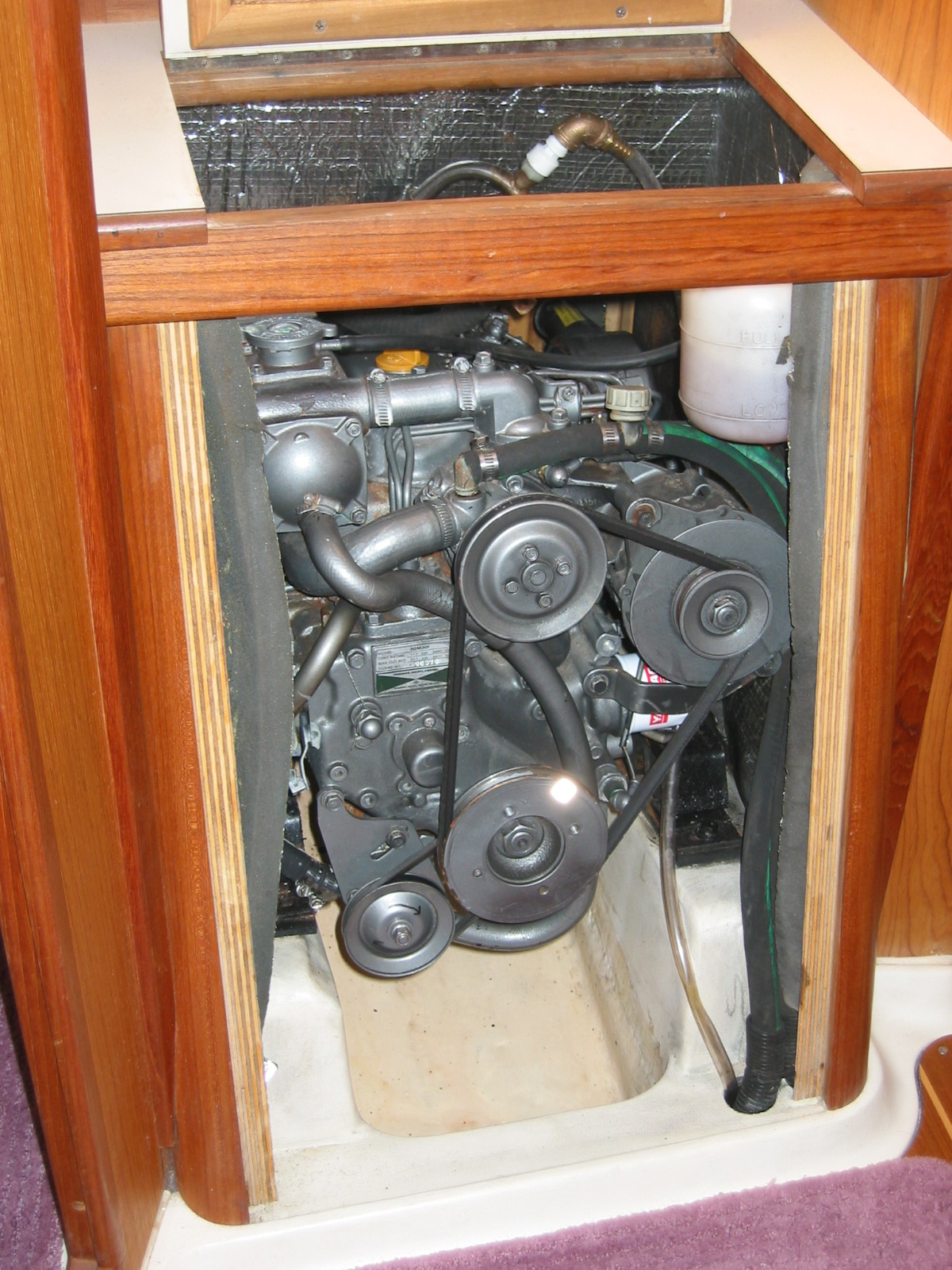

I don't know about how your engine is installed or how much front engine access you have on your Beneteau so take this with that in mind. On my Hunter 340 the front of the engine and raw water pump are easily accessed ( see photo). To service the pump and change out the impeller, the whole pump can be easily removed using the two engine pump mounting and adjusting bolts. Once out of the boat the pump cover and impeller are easily serviced. Re-installation and belt adjustment are quick and easy as well.
