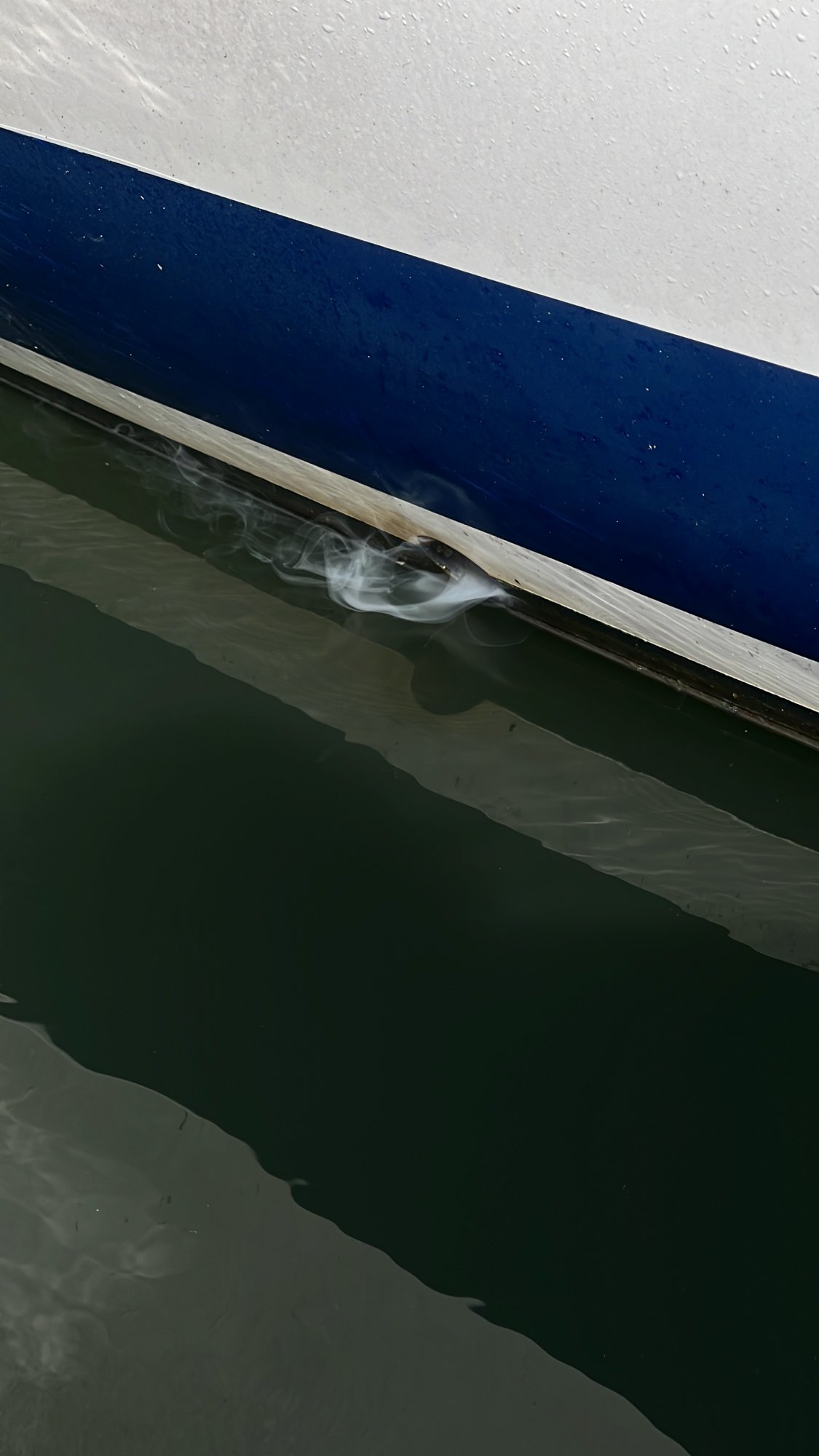

You didn’t mention any smoke after the last set of repairs. If that was the case and you’re also not seeing much unburnt fuel on the start attempts that leads me even more toward lack of fuel, like from air, rather than excess fuel or bad fuel spray like from bad injectors.
Feb 16, 2021
467
Hunter Legend 35.5 Bellingham
I did see some whispy white smoke hovering around the exhaust port after each failed attempt. See pic.
