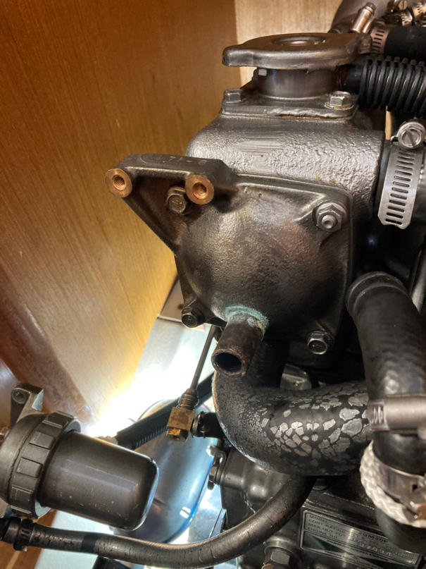

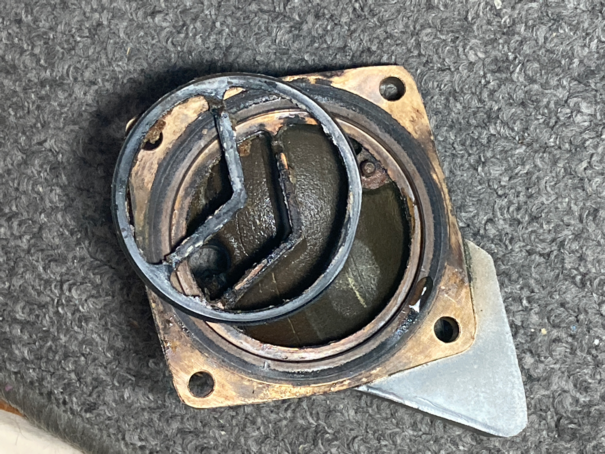

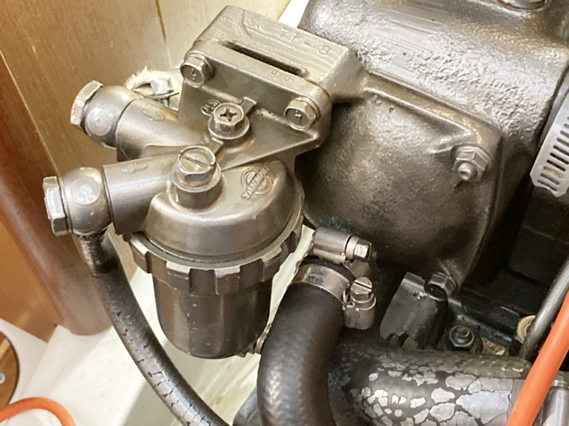

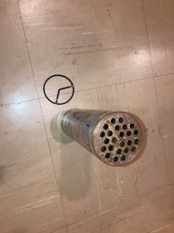

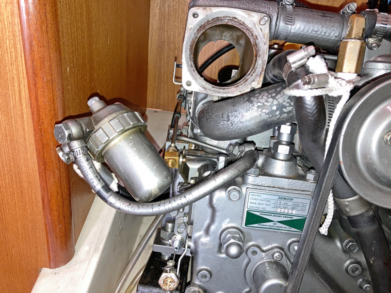

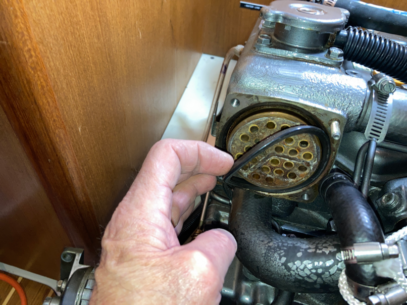

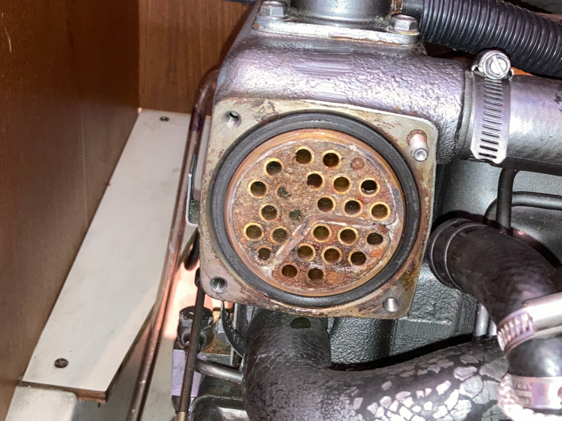

I'm afraid all of the above bad news is quite true. But fear not, going into the heat exchanger is not all that bad. I did it a few years ago during the winter.
Here are a few shots of what you'll find inside. Mine is the 2GM but the layout is similar and the 3GM may include a few extra tubes thrown in for good luck. Scratch mark everything so all parts will go back in exactly as they came out.
You will need the the one gasket which for the flow return and the 2 large "O" rings. The most important parts of the whole job is to clean all gasketed surfaces to shiny metal and lubricate the 2 "O" rings with a NON-petroleum grease such as SuperLube. This will ensure they will slide exactly into the correct position. If they are not perfectly seated, this will allow flow between the sea water and the coolant :yikes: :yikes: :yikes: which causes a loss of sleep at night.

The big o-ring cover seal is Yanmar # 24311-000700.. The gasket that seals the tube sheet to the cover is Yanmar #128695-44070. Ya need two each.. You may be able to re-use the old ones but good to have them on hand..

Nice info @Ralph Johnstone. His HE looks clean. Mine was crusty with evidence of corrosion.
The bits of vane’s missing from your impeller may be found lodged in the HE tubes, or may be stuck in one of the hoses from the pump to the HE. Check the full path or you may find yourself repeating this task.
I found a small wooden dowel made a decent tool to clear each of the tubes.

I used a gun cleaning bore cleaning tool with a 22 caliber brass brush attachment. Fit perfectly and allowed me to clean out barnacles & built up crud easily & effectively on a 2GM20F Yanmar. Solved my overheating problem on a previous boat.
