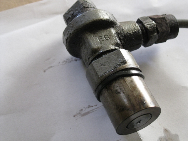

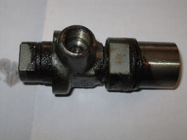

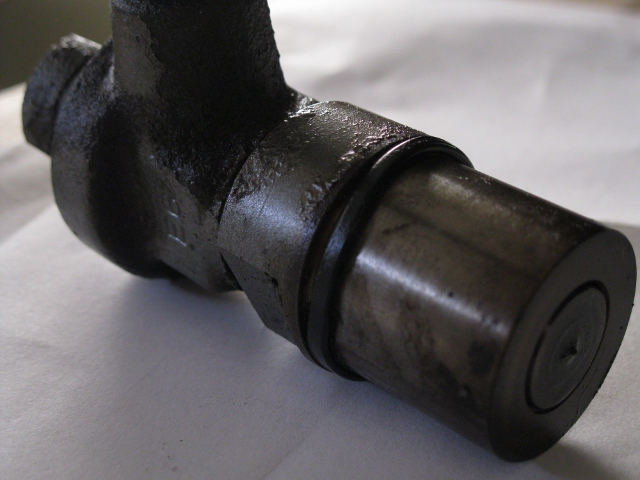

The engine is a 1991 model that had 960 hours on it in 19 yrs. I put 300 on in 2 seasons and it was always a bear to start. Like Stem to Stern says, get used to it.It ran well otherwise. A few good tips from you all here helped alot, like full throttle and a little heat on the intake side ofthe block on cold mornings in the off season. Have had the injectors removed and rebuilt by NW Inj as they are likely the originals. One of the PO damaged the no3 and it likely has not been off since. The mechanic got it out and NW was able to save it. Pressure tested low on all injectors at idle. 330 or so.
My question,
I assume the gasket slippage is from the removal, not a bad owner install, would you concur?
Is that stain on the side of the injector blow by? Poor install?
Injjector No3 is strip and stain,
no2 stain,
no1 appears clean and firing well.
The picture start with the no3 2 pics , no2 2 pics and no 1 , 1 pic.

Is your engine also hard to start after running it for a while, shutting down for some hours (like while you are day sailing), and then starting up to go home? Have you looked at the quality of your fuel and (1) ensured it is "fresh," (2) has no water or bugs in it, and (3) has a minimum cetane rating of at least 45? A lot of diesel fuel sold these days is only rated at 40 cetane and that could make starting more difficult. I assume you have good compression, clean primary and secondary fuel filters, and unobstructed air going into the engine....
May 27, 2012
1,152
Oday 222 Beaver Lake, Arkansas
Are you saying compression was 330 PSI? 960 hours in 19 years, thats only 50 hours a year. Lack of use and poor service could have carboned up the rings. MMO may help, or run a can of Gunk Motor Flush in it just before an oil change (directions on the can). Then put some hard hours on it.
Over propped could be killing it though. And its not enough to just throttle back, too much prop has the engine working too hard across the whole range. I would check it out and correct it if thats a problem. You want the engine to reach full rated RPM, not be lugged down. Make sure your using a trusted tach

I'd say you are overpropped, you should easily hit 3400RPM with that engine. Some folks would run at that as cruising speed. I have the 2gm20f, same injectors, on a 12,000 lb boat and running a 14 X 11. I had it repitched to that on recommendation of the Prop Shop in Lynwood, Wa.
I'm curious to find out how much it cost to refurbish your injectors. I've seen new ones at about $130, I can't verify that right now. New operating injector pressure is about 2800psi.
