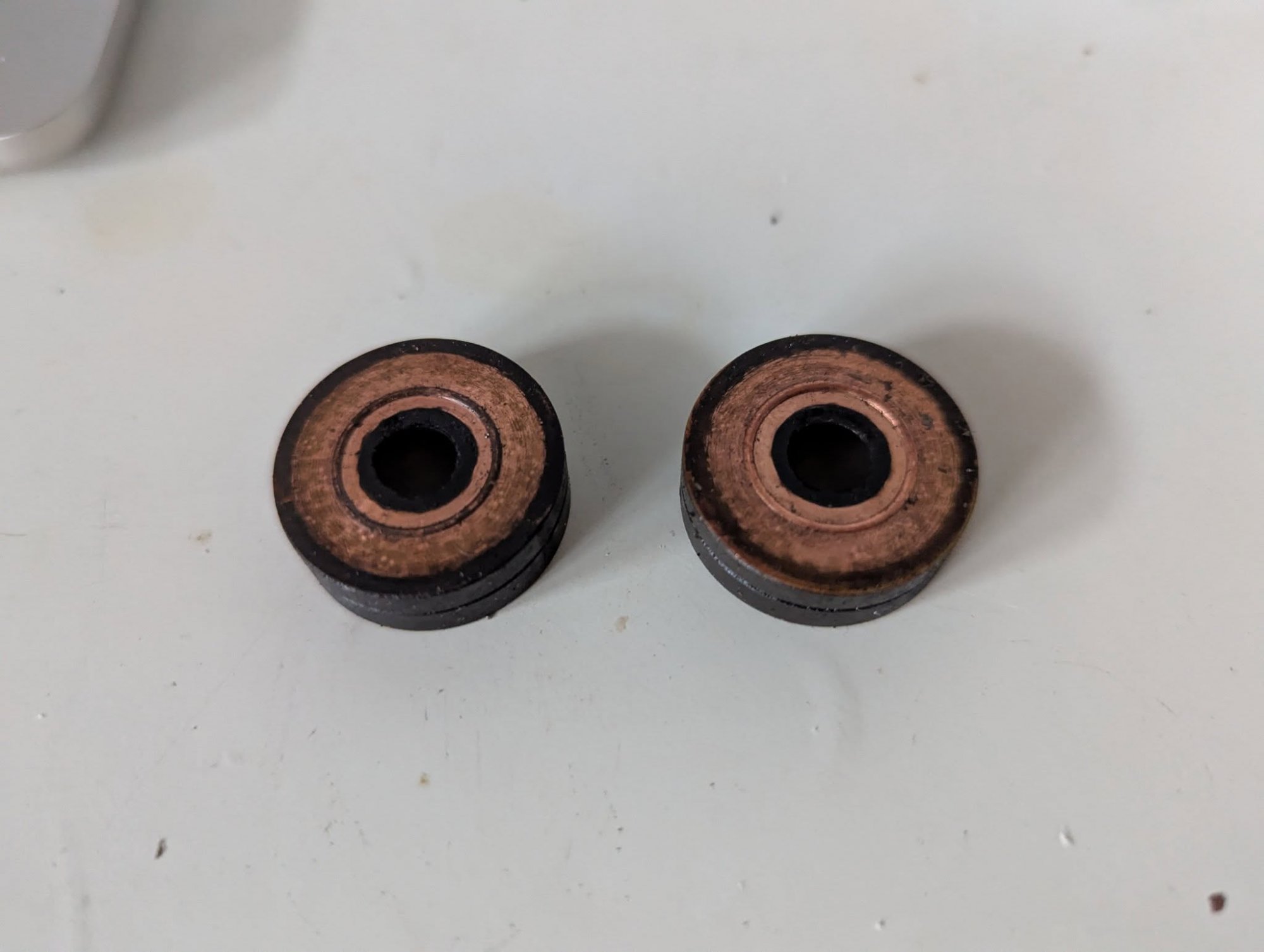

The injectors are with the shop and getting rebuilt. I showed them the rear chambers and they advised me to replace the heat isolators & copper crush gaskets.
The problem is they are so stuck, that they became one solid piece.
Can I separate them from the rear chamber or do I need to buy rear chambers as well?

If the raw system was filled with anti freeze, it is possible to suck it back from the waterlock into the combustion chamber. Just make sure it is winterizing antifreeze - not your permanent coolant.
As to the 'chambers' your photo shows 2, but there should be one for each of the three cylinders. The chamber is actually in two parts per cylinder. Your photo shows the upper part. They are one piece, they do not separate. The lower part is not likely to come free from the bore. Anyway, take these uppers to the Yanmar dealer and they will provide gaskets for both sides of those parts. The parts themselves are completely reuseable, once you clean the old gasket material from the surfaces, thus the new gaskets recommendation. Oh - be sure to use the O ring at the top of the injector stack so as to keep moisture out of the injector bores. One last tip - coat the injector bore lightly with anti seize when you re-install the injectors and the upper chamber. I use the Nickel formula - or ask the injector servicer what they recommend.
