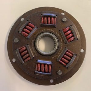

I do not know the specifics of your engine & transmission. I do know I have heard a similar noise before my engine & transmission were rebuilt. In my case it was the transmission rebuild and the install of a new Damper Plate that resolved the issue.
The springs were old and sloppy. Here is an image of a damper plate.

Thank you jssailem. From your photo of the dampener plate and my past automotive career…now I have confidence of what it is so I’m not going to worry about it for now. I will just maintain the engine idle a slight bit above base idle…until I have the chance to disassemble and replace. Of course I’ll bet once I get back to the boat with my mechanics stethoscope ….I will have 100% confirmation that you are correct. Thanks again
