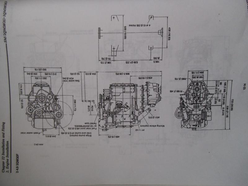

One twist I just leaned today is that the 3GM is actually a 3QM30F that came from a Tayana 37. Is it worth the trouble? I got to look at the pros and cons.
1,090
If its a 3QM rather than a 3GM, then it might be an easier swap? The engine mounts should be the same "width" as your 2QM but the engine will be about 5 1/2" longer WRT the mounts. And the 3QM30"F" is the factory fresh water cooled version. If you can stuff it in there, it seems like a viable option to me.

I've got a Yanmar QM series manual on my boat which I will be visiting later today. I'll take pictures of the spec pages and post for the models so you can determine dimensions and weight.

Here is the 3QM30F dimension schematic page from my service manual. I think you will be able to zoom and read all the info. If not, let me know and I can eMail it to you.
I thought my manual also covered the 2QM15 series, but no. Certainly the 3QM30 is larger in all respects to my 2QM20, except the width.
