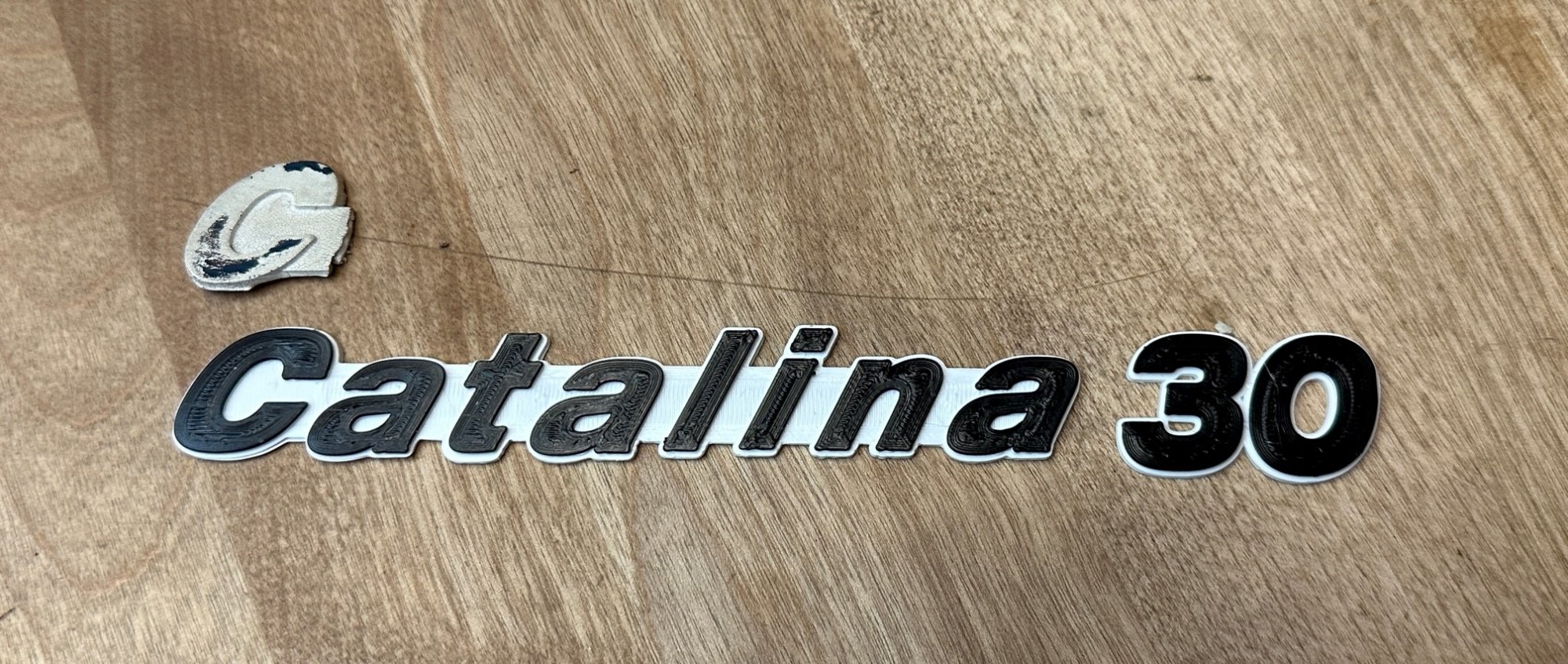

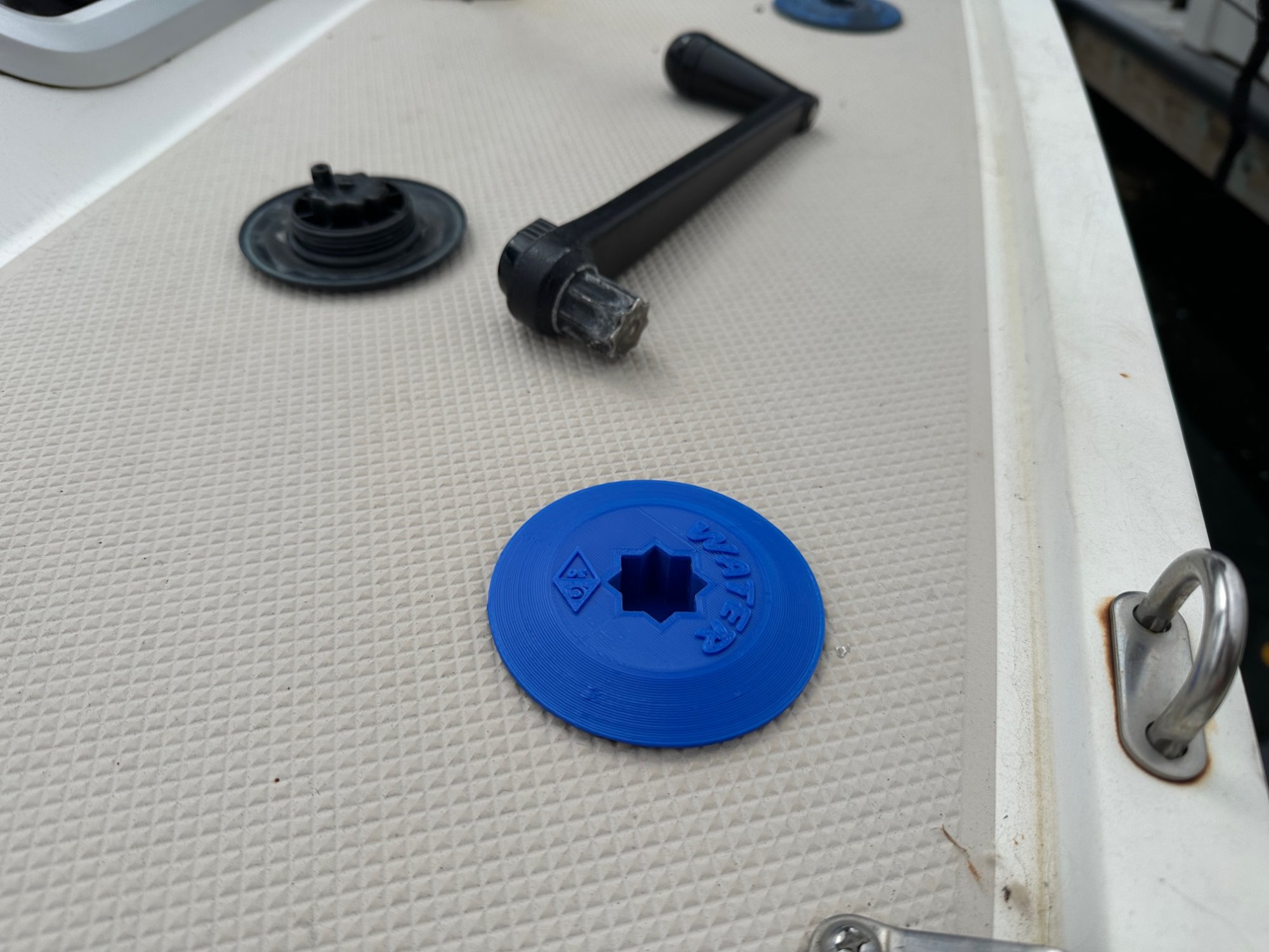

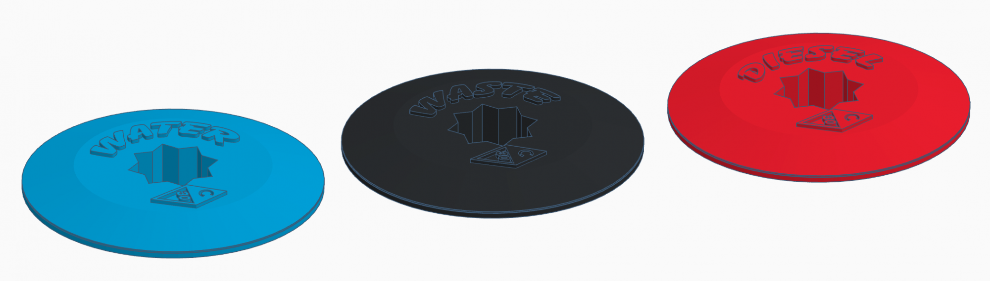

I was asked to see if I can make printable versions of the things.
I wanted a spare cap for myself and some logos, but I did a little more...
So, if anyone else is interested, I'm posting the links to the files I made.
I've tested the caps, they work on my boat with the proper O-ring.
PLA warning! - It's water absorbtive! Seal it well with something if you want to reduce the chances of contamination. (clear coat, etc)
PLA is fine with fuels. ABS is stronger but less resistive to fuels. Nylon is probably best for this sort of thing, but I don't have experience printing in Nylon. I made these as TEMPORARY spare caps.
The older logo is really really close, but I didn't put the bevel that the original has.
This is the logo I was after anyway, and it's good.
