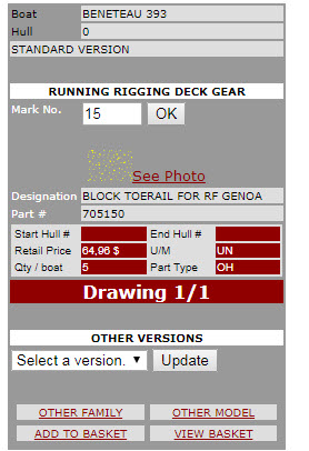

Part # for entire block is 705150 on Beneteau Spare parts site $82 ea
That doesn't seem right. Those things aren't worth one percent of that ! They are essentially junk.

Expensive Junk then maybe (smile) -- but ya that is the price in the Beneteau spare part site - be thankful you aren't looking for a replacement pulpit or keel. I have ordered some unique Bene parts from them -- they are knowledgable and quick at shipping.
