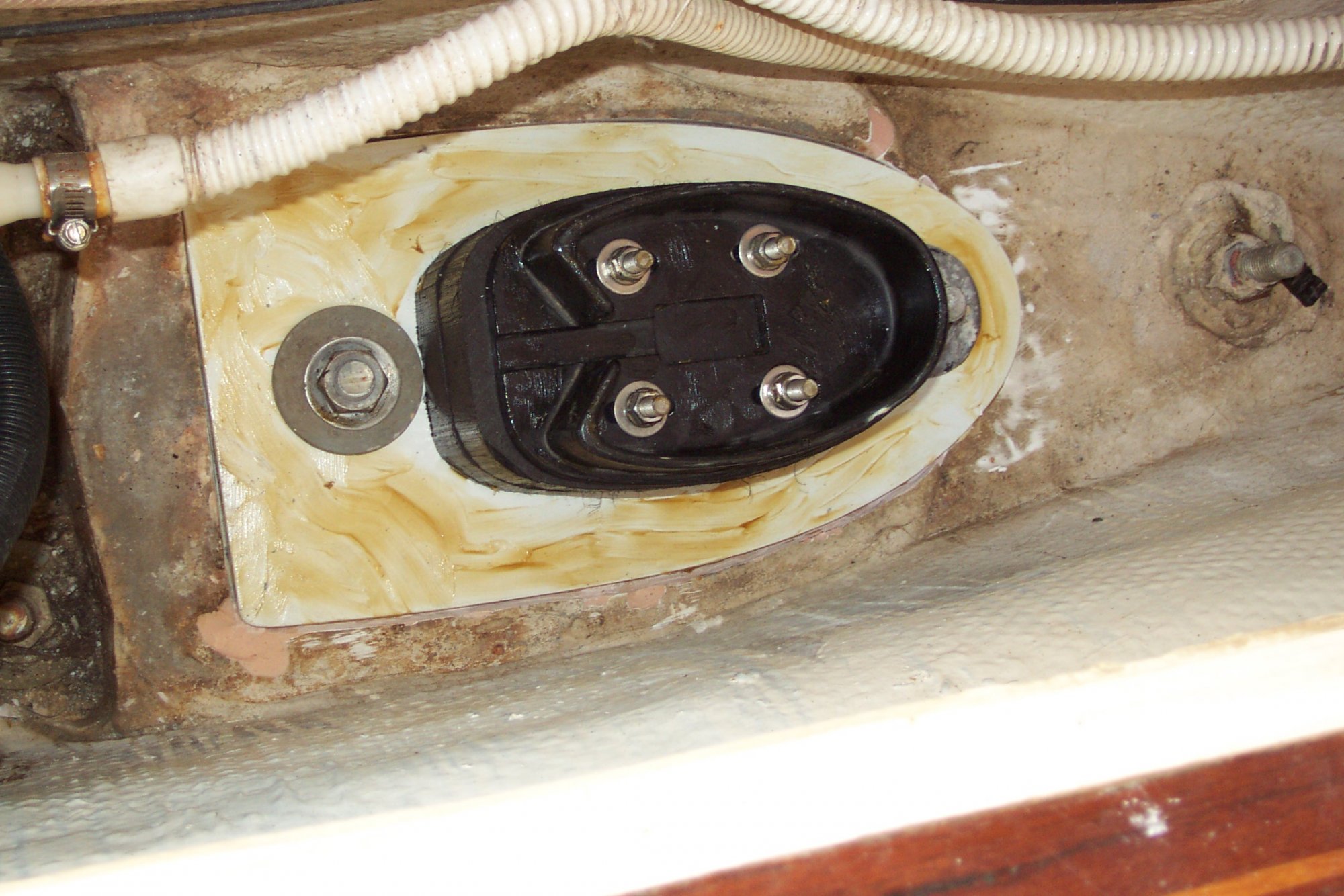

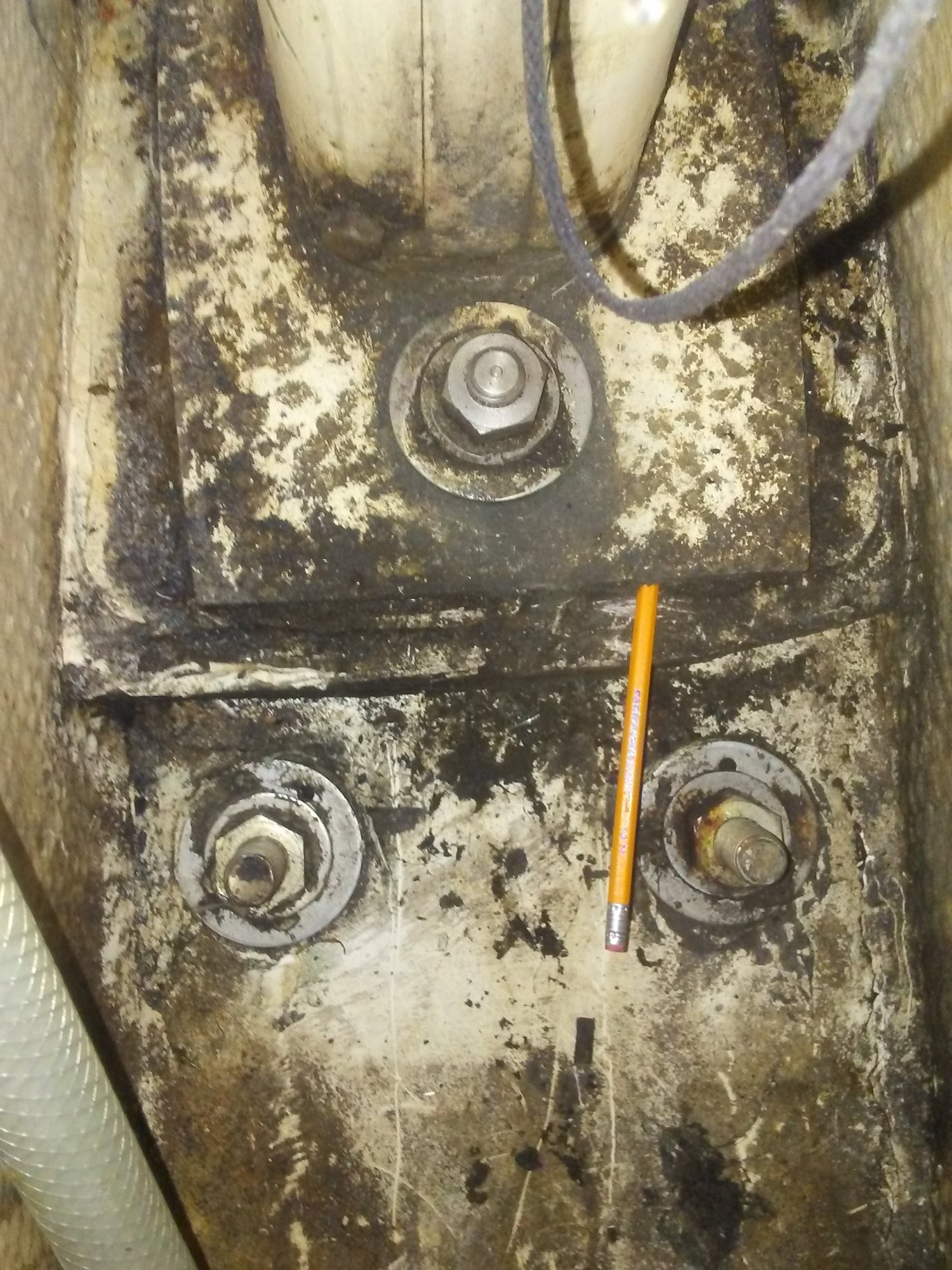

What is the base made of? Ustepped the mast recently on my 1982 37C. After removing the step and base plate I discovered the top of the actual base in the bilge had large depressions and the base plate did not sit flush on top of it. I intend on completely replacing it. In fact I have already removed it. I chipped it out with a chisel. I'm glad I did because it also had moisture inside of it. It appears to be some kind of poured resin, pink-ish in color. Maybe chockfast? Does anyone happen to know for sure or has anyone replaced their base before?
