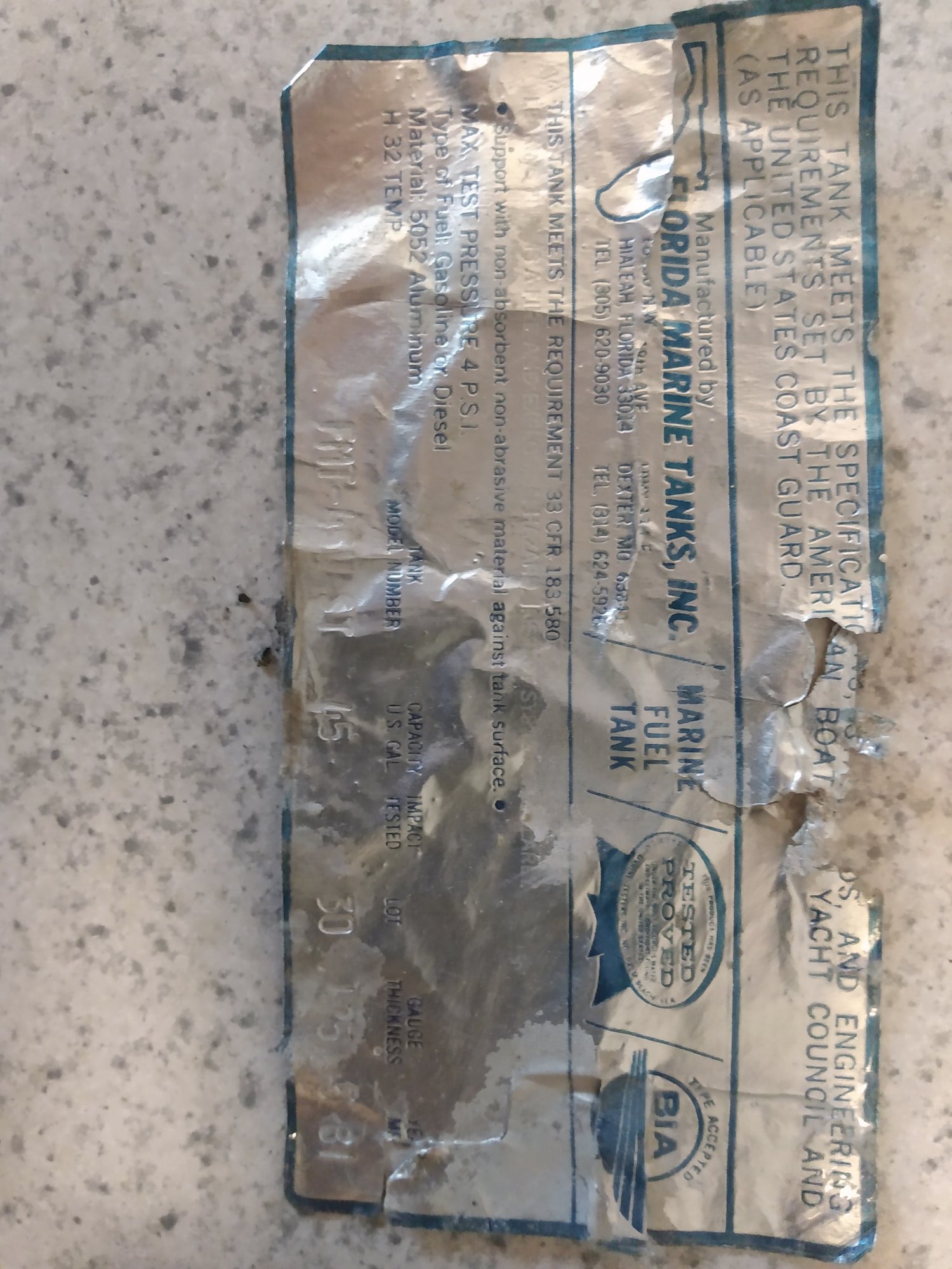

If you remove the cushion and the plywood panel under it in the aft cabin, the entire top of the diesel tank is revealed. Somewhere on the top of the tank is a builder's tag. From my less-than-reliable memory, the tank on my H37C was built by Florida Marine Tanks and was 38 US gallons (nominal capacity).

I'm not interested in getting into a ruckus about H37C tankage - heck I don't even own the boat anymore - but I refer you to a site by another former owner who completely tore his 37 apart and rebuilt it (his website has probably never been seen by most of the newer owners): Rainbow Chaser. Gene Gruender worked on all the tanks and found the fabricator's tags on each tank: The water tanks are 45 US gallons each - not 50 gallons as Hunter stated - and the diesel tank is 38 US gallons, not the 44 gallons that Hunter listed. I highly recommend that any new H37C owners thoroughly read Gene's site and also José Guidera's website about his restoration of S/V Bonheur.

Mine is an 82 37C there is a tag on the fuel tank that says it was made by Florida Marine Tanks and it is 38 gallons. Yours should have one also unless someone removed it. ABYC standard required it and it was required to say the material it was made from, the capacity, that it was rated for fuel and what it was pressure tested to.
