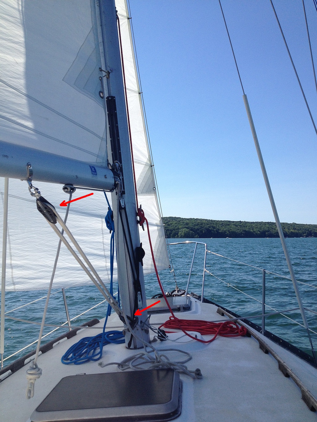

I've attached a picture of our 4:1 dual block attachment. None of my halyards or vang line come back to the cockpit, but I assume your rigging would be made similarly. The arrows highlight the two blocks, one on the boom, the other attached to mast base.

@Manny ,
Good morning! That's a peculiar situation, and I've found it interesting that the majority of used boats that I've sailed/boarded have missing boom vangs. Often times, new sailors will remove them because they either have no idea what they're for, or they think it's unnecessary and don't need it. If the blocks are there, then you've got ninety percent of the work (and money) taken care of; however if they haven't been used for a while, I would service them with WD40 and make sure the bearings in the blocks are still functioning properly. Also, make sure the blocks that are there are the right ones; the block on the boom should be closest to the mast, and the lower block is either attached to the cabin top just behind the mast, or directly onto the mast toward the bottom facing aft. If they're the right blocks, then all you've gotta do is run some line through the system! OH, don't forget to check and make sure there's a cam-cleat for the line at the bottom block where the sheet exits the block system. I once sailed a Capri 14.2 that had a boom vang with no cleat!
8,050
Beneteau 323 Annapolis MD
Some arrangements have the cam cleat at the boom end so you can cleat/uncleat from the cockpit. In post 5, it looks like you'd have to be on deck to cleat the vang- but maybe it's just not a clear picture? My vang terminates in a cabintop line stopper, so cam cleat is a moot point for me. YMMV.
