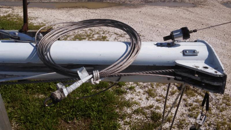

Thanks for the detailed instructions, but my mast configuration seems to be a bit different. Besides all the stays and shrouds you described, I have 2 more at the masthead.
As you’ll see in the photo below, on the aft side of the masthead, there are 2 sheaves (one for the main halyard, and I assume the other is for the topping lift), and 3 pins with wires attached. There’s a larger hole (with pin and wire removed) where the backstay was attached, and 2 smaller holes - to the left of the backstay hole is a pin (still in the hole) with the wire attached that’s sitting on the mast, and to the right of the backstay hole is another smaller hole (with pin removed) that had a similar wire attached to it.
Any idea what these could be for?

Its been a couple of years since I had the mast out, but in my recollection, the big pin at the aft side took a SS strap that had the back stay pinned to it and the smaller pin (inboard) has fixed wire topping lift attached to it. The other end of the topping lift secures to the end of the boom with a short length of rope. The second sheave, next to the main haliyard is not used on my mast.

OK, let me give you some background on this which may help explain my confusion. After I bought the boat, I hired a rigger to prepare her for transport to my marina in NJ. When she arrived, all the standing and running rigging was still attached, but coiled up and taped to the mast. So, considering the attached stays and shrouds, I’m assuming they were all used by the PO.
The standing rigging attached to the mast includes:
  • Masthead: Forward - Forestay with turnbuckle; Aft - Backstay with turnbuckle; 2 smaller wires with eyes
  • Next down: Sides - 2 shrouds (1 each side) with turnbuckles
  • Further down: Forward – Staysail stay with turnbuckle; Sides - 2 wires (1 each side) with eyes
  • Just below Spreaders: Sides – 4 shrouds (2 each side) with turnbuckles
So, a total of 3 stays, 6 shrouds with turnbuckles, and 4 smaller wires with eyes. What I’m trying to figure out is what these wires with eyes are for. They’re not for a topping lift, as that is on one of the sheaves on the aft side of the masthead. Could 2 of them be running backstays, and the other 2 for some type of lazy jack? And if so, which 2 are for which purpose?
Now do you see why I’m confused!

The running backstays are indeed just wires with eyes. When attached to their tangs, which are at the same height on the mast as the top of the inner forestay, they end up about 4' off the deck. This allows you to shackle a block & tackle on each lower eye and clip the other end to the toe rail. The length of the running backstays means they could not possibly be used from the masthead - they would be too short. The other two "wires with eyes" have me puzzled; perhaps the upper strop of a lazyjack system (as you guessed). Then they would have a block shacked to them and the two parts of the lower jack would run through the block from two points each side of the boom...just thinking outloud, as I don't have them on my boat.

Hi Rainer, think that you have it now. I posted some pics in "Mods" awhile back that might be some help: http://hunter.sailboatowners.com/in...&cat_id=38&aid=7938&page=article&mn=37-cutter . I do, in fact, use that aft sheave for the topping lift. I installed a spare halyard and attached it to the topping lift. There used to be a pennant for the staysail boom, like a topping lift. So you might find a fitting about the same point as the staysail forestay. Also in the pictures you can see that I have a block on a forward bale that I run my gennaker/drifter halyard through.

Jim is right about the two wires where the inner (staysail) stay is located. They are the running back stays. Of the ones at the masthead one could be the topping lift which is typically fixed at the mast head on the small pin closest to the mast and adjusts at the boom. The other one that runs over a sheave could be a rope to wire halyard. Does this one exit the mast near the deck level?
On my mast there is nothing attached to the small pin furthest from the mast.

Ed, I have only three exit plates on my mast and only two of the four sheaves at the masthead have halyards on them. The jib and staysail halyards exit port side and the main halyard comes out starboard side. Was it common on the earlier boats to have a topping lift run through the other aft sheave (beside the main halyard)? My topping lift is a fixed wire attached to a smaller pin inside the backstay. I am just wondering about differences in the rig over the years...

No Jim, mine was same as yours. I added a halyard on the front for flying a drifter and a spare halyard on the back. Since it was there I decided to attach the topping lift to it. This allows me to adjust the topping lift regardless of where the boom happens to be. So maybe I had to add two exit plates? I think that is right. I will check tomorrow, first time to boat in three weeks. :(
