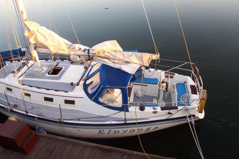

Assuming you have a Hunter Cutter 37 like mine in the picture, that leak would be manifesting itself on the port side aft of the jib sheet winch.
I have no experience of leaks in that location. When I had leaks in the chain plates and coach roof they showed in the cabin but who knows where water that gets above the liner will migrate to.
Possibilities for the point of ingress would be the scupper, right above the i in the name, or the stanchion base, or the toe rail, or the deck fill which shows up as a black dot aft of the portlight.
If this is an HC37 suggest you post into the Cherubini area so other owners will see it for sure.
