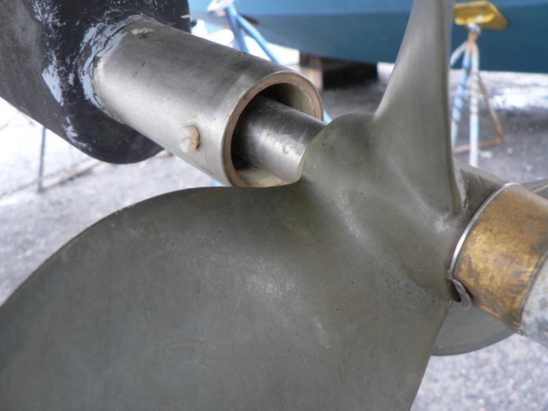

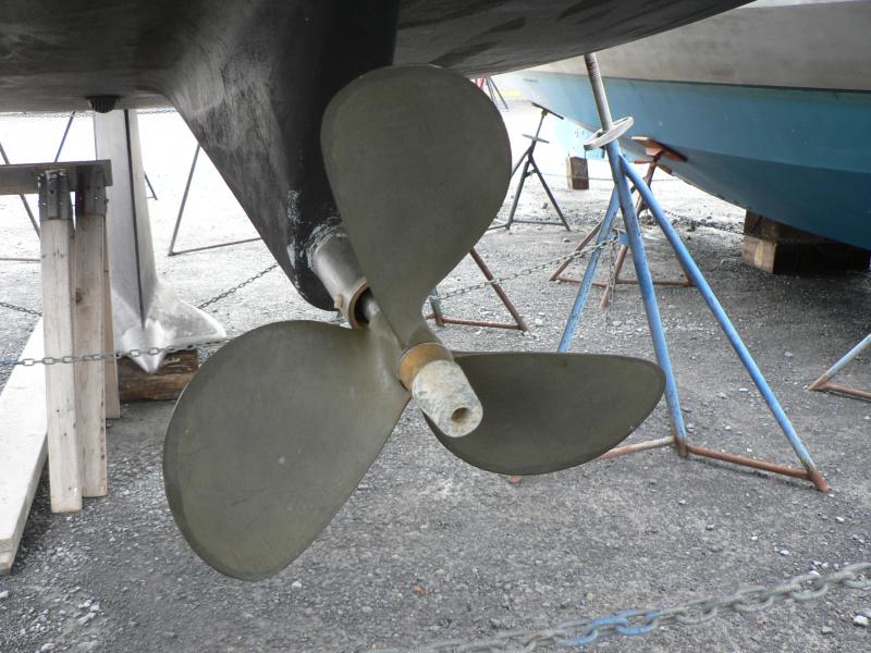

Advise on the bearing and the prop
FYI - There are threads on this forum about how to replace the cutlass bearing. I did mine from info I got from this site last spring. Do it right and it will take about 1 hour to replace. Where the thread talks about putting it in the freezer first - they mean it. It will make installation easier.
On the folding prop issue. I installed a VariFold prop on my B331 last spring, the results are amazing. It costs a lot but it was so easy to install and the performance is fantastic. You would not be disappointed.

Hi james,
Thanks for the info, will search the site. Did the VariFold reduce the prop walk? Did you install a 2 or 3 blade? I have a lot of prop walk and getting out of my slip is tricky.

I installed the 3 blade varifold, the variprofile although slightly cheaper would have been too close to the leading edge of the rudder. The difference is amazing. I have NO prop walk and NO vibration when under sail. I can stop the boat on a dime and at one point this summer I actually parallel parked the boat in a very tight space with many onlookers. I even amazed myself. I am a happy customer. It comes fully assembled, calibrated and tested from the factory. The installation is dead simple. It took longer to get the old prop off. I also replaced my cutlass bearing while I was doing this. Can't recommend it enough. You won't be disappointed. FYI - I back my boat into my slip, again lots of control.

FYI - There are threads on this forum about how to replace the cutlass bearing. .
I have searched (just to prepare myself when that magic time comes!) but haven't found any. Where are they? I can only find threads for removing a cutlass bearing from a p bracket, nothing for the beneteau skegs.

Do an advanced search on cutlass bearings for Beneteau owners, it's there, I found it tonight again. It was early last May..
It is not a difficult job, just takes time and patience.

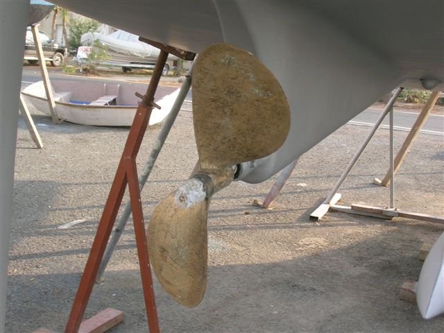

Hi James
Prior to replacing your propeller were you experiencing prop walk, my 361 will turn in reverse nearly 50 deg without moving the wheel. However I have learn't to use it to my advantage.
