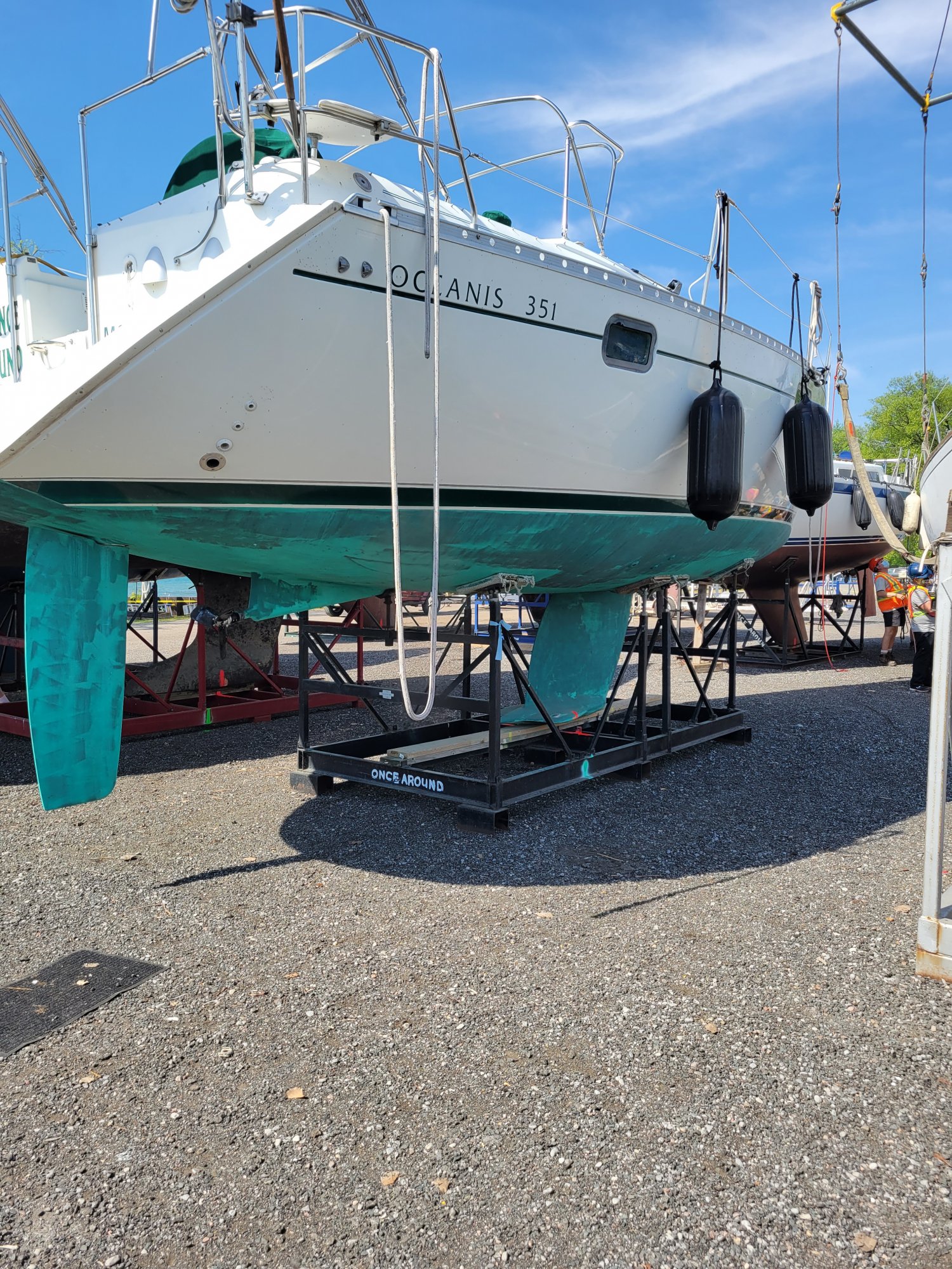

Beneteau 351 WYC Whitby
Did my 351 which shares hull with 35s7 and I would believe you would have to dig a hole /trench. My boat sits in a cradle with the cradle suppported by 8 inch feet for hydraulic trailer pickup and movement. I had to dig about an 6 inch deep trench by 2 ft long x 6 inch wide to drop rudder and swing it out. And you can see how far my rudder is off the ground
