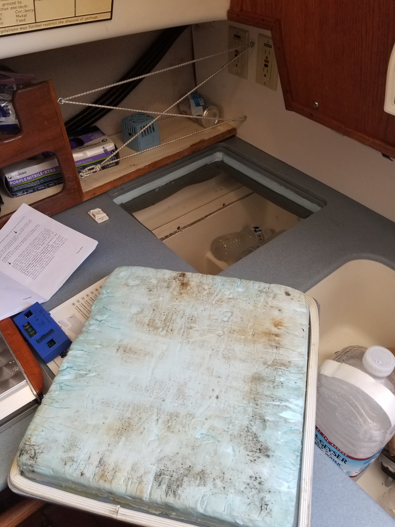

Awesome. Thanks. Any pics that you can share on where you put the plate(s)?
Dec 28, 2015
1,923
Since I took these I have replaced the thermostat and removed the blue box module because it was a huge piece of crap. Sorry for the weird pict format. I'm doing this on my phone.
