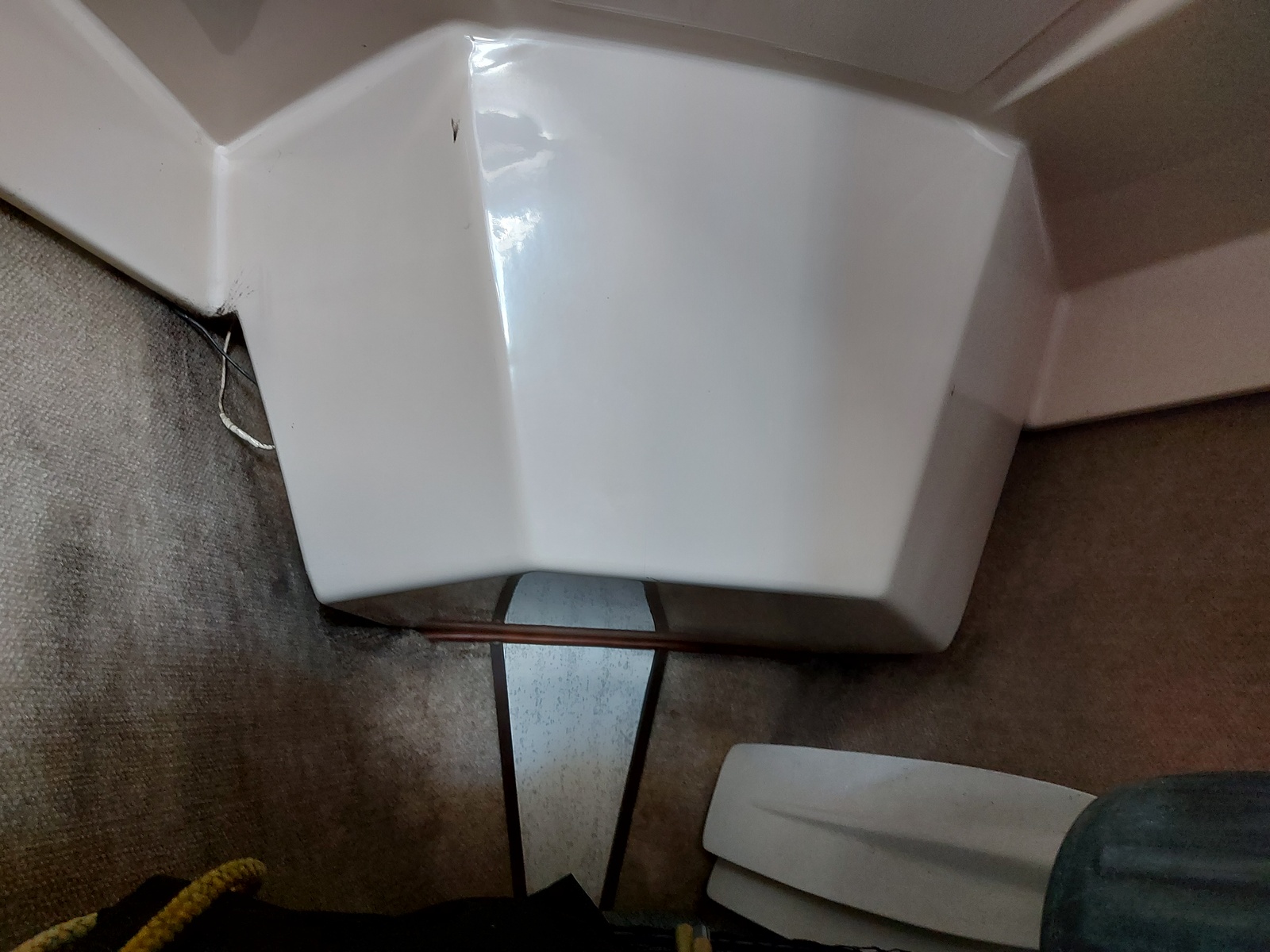

I don't have an access port there, and it's not obvious to me how to remove that bulkhead (see photo).
I'd have to rip the carpet off of it at the very least, and I have no idea how it's attached underneath that. Adding one of those round access ports is an idea, though.

I don't have an access port there, and it's not obvious to me how to remove that bulkhead (see photo).View attachment 217480
If you remove the vinyl trimming you can easily pull the carpeting aside using a putty knife as it is simply glued on. See 1st pix. 2nd pix shows backboard made of cardboard I installed to fiberglass the enlarged anchor well after cutting off the bottom. I simply
On mine, once I removed the vinyl trimming, pulling the glued-on carpeting to the side was very easy with the help of a putty knife. The 1st pix shows its simply a fibreglass sheet that holds it in place. The 2nd pix shows the cardboard backwall I installed as a backboard for the fiberglass used in rebuilding the anchor well. It was not hard to remove that cardboard after the fiberglass had cured. I then re-glued the carpeting and vinyl trimming and re-installed the porthole.

Thank you Claude, that's really helpful. I saw your photos before, but now with your description I understand what I'm looking at much better. What is that bulkhead made of, and what's holding it in place? If it's just the carpet, it would be really easy to remove.
I think my first step will be to install one of those access hatches. Then I can get an endoscope up there to see what I'm dealing with.
