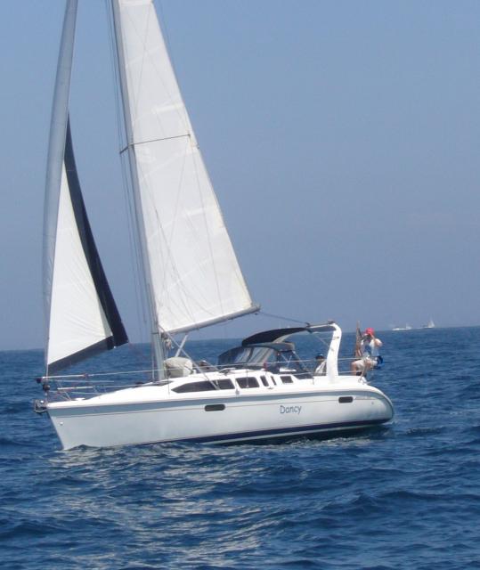

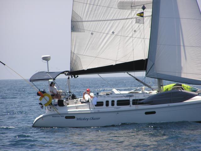

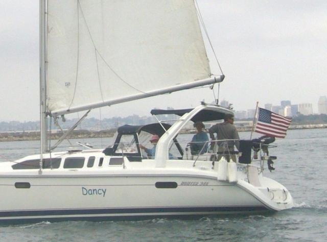

Couple of comparison pics. These are 3 or 4 years old.
If the boat has been taken care of, you cant loose either way.
