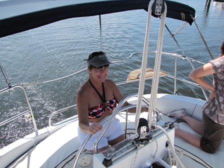

I was speaking specifically about the setup on our 336, which has the traveler mounted on the pedestal. It's mounted pretty much directly below the end of the boom, and it's only about 24" wide, and we've found that it doesn't really seem to have much affect when you can only move it 12" either way from centered. Anytime I've wanted to depower the main in a gust, for instance, letting the traveler out doesn't affect the angle enough, and I end up having to let out the sheet to take off the heel. After a while, I just quit bothering with the traveler, and just use the sheet and the vang to control the sail. We don't race, we're strictly cruising sailers, and we don't have any trouble maintaining 6+ knots in any kind of wind, so we're OK with it. I imagine a serious club racer would want the greater sail control provided by the cabin top mounted traveler. I saw a mention in another thread though that when you have the cabin top traveler and the third cabin top winch to handle the mainsheet, you can't swing a winch handle in a full circle on the mainsheet winch if you have a dodger on the boat. The handle hits the dodger.
My 5'4" wife has no problem controlling the main from the helm with our setup, by the way. Makes a gybe an easy to control evolution for one person.

robertsapp, I had no idea that the helm traveler is ONLY 24" :eek:, in effect it is useless at that size. That's like giving a 6' guy a 2' walking stick. In that case a coach roof traveler is defiantly the better alternative. Dialing in proper mainsail trim with that traveler must be a nightmare.
I'm all for comfort and having things feel nice but when it comes to sailing there's just no substitute for proper sail controls. Hunter should be ashamed.:redface:
May 28, 2009
764
Hunter 376 Pensacola, FL
Here's a picture. As you can see, not much to work with, which is why we pretty much just leave it centered and forget it.
