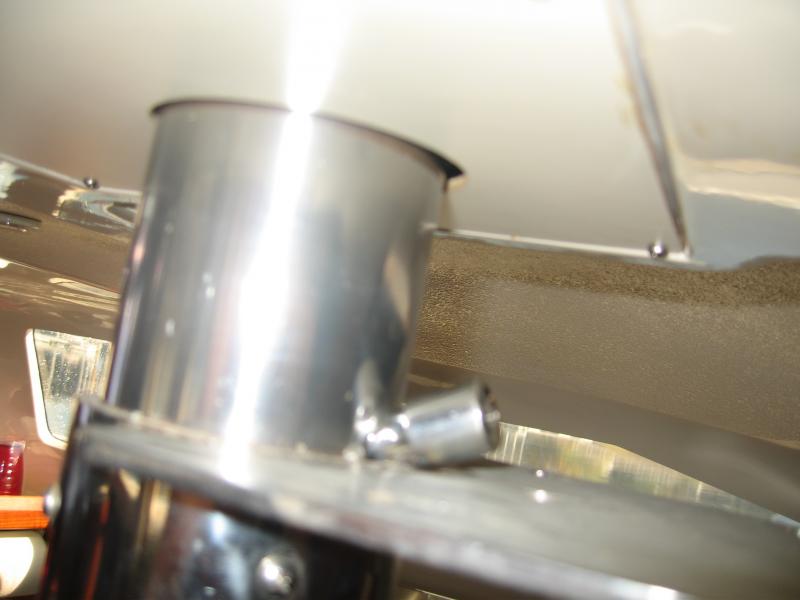

here is my fix with pics

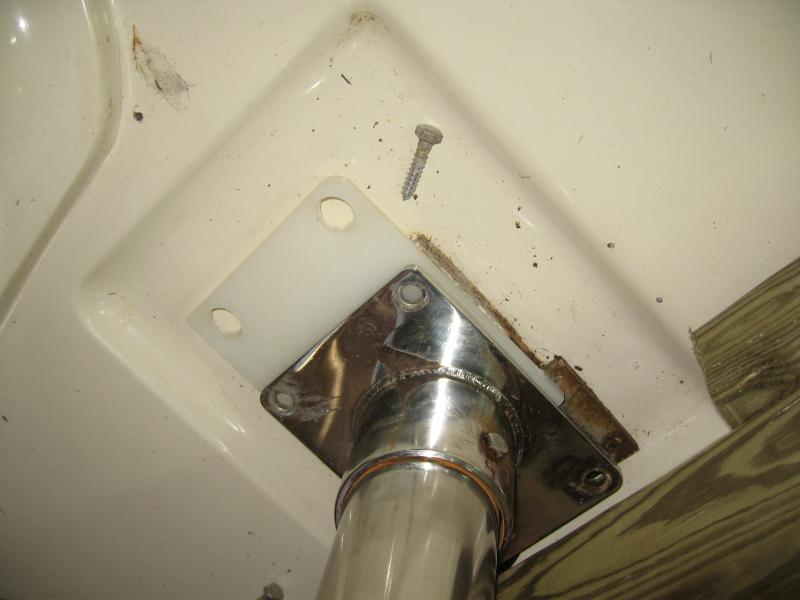

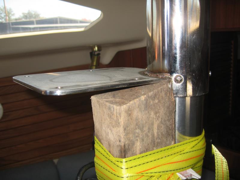

OK I finaly got around to implementing my theory and It worked. I did not have a metal bar fabricated. I used wood and it cost about 20 bucks for materials and worked well. I also cut some 5x7 spacer panels out of some composite type kitchen cutting boards you can find at walmart for a few bucks. I cut several panels with differeing thickness because I did not know how thick I would need so I knew I could use one or two of various thickness to be able to vary my final thickness adjustment. First I loosened the 4 standing rigging turnbuckles as loose as they would go. I kept count of the turns and made all equal turns and retightend equal turns after I added spacer plates so I knew the tuning would be the same. I removed the table from the height adjustment clamp that moves up and down the compression post.

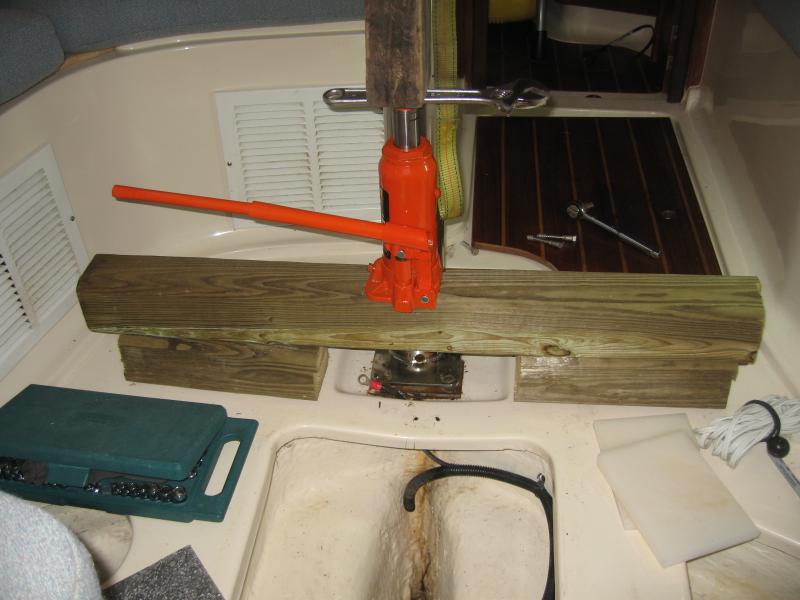

I then cut some 4x4 posts to make 2 risers and one cross piece. I placed the risers and the cross piece just aft of the post base. The risers were placed on solid areas of the fiberglass substructure. This allowed a bridge I could work under. see pics. I then placed a small bottlejack on the cross piece. I cut a vertical support with a slight angle on one end. I lashed the vertical to the compression post with straps. The vertical ran from the jack on the bottom up to the table height adjustment clamp. It is very important to move the clamp all the way up and wedge somthing ( I used a big socket extension) into the little hole at the top of the post where the flat pannel of the clamp device is snug aginst the socket extension or hatever you use for this. This will keep the clamp device from sliding up when you crank up the pressure on the jack. see pics It is also important to cut the top of the vertical 4x4 with a slight angle at the top where the only contact that the vertical makes with the flat part of the support is very close to the compression post so you do not bend the flat support part of the height adjustment device that the table is screwed to. see pics
I then jacked up the compression post just enough to slide in 2 layers of spacers that I cut from common cutting boards. I replaced the existing lag screws with some a little longer to accommodate the additional thickness. see pics I then removed all the support wood and the jack and tightened the turnbuckles down to a point approximately above the point equal to the thickness of my spacers. Be carefull not to raise the base plate to much with to many spacers or the flooring will rest on the lag bolt heads and be uneven. If this happens you can drill some shallow counter holes in the underside of the flooring to allow extra room for the bolt heads.
This whole process took me less that 2 hours and I feel very good that my top deck just around my mast step now does not have the slight depression that held water. The total amount I raised the mast base was about 5/8 of an inch.
Of course this whole correction repair process is based on the fact that the compression post base has settled all its going to. I believe there will be no more settling and what settlement happened over the 20 year life of the boat.
Now on another note. The flooring around my compression post base has rotted because it stays moist from watter running down from the mast. I just wanted to report that I suspected there was dirt in the bottom of my mast. There is a dime sized hole in the front of my mast about 2 inches up from the bottom of the mast. I took a stiff piece of wire and disturbed the layer of dirt that was covering inside the bottom of my mast then took a piece of small tubing and attached it to the end of my shop vac and I actually sucked out about a pound and a half of fine dirt. It is no wander the weep hole was getting clogged. I hope this helps my moisture problem. I think the dirt came from dirt dobbers making nests inside my mast over the years.

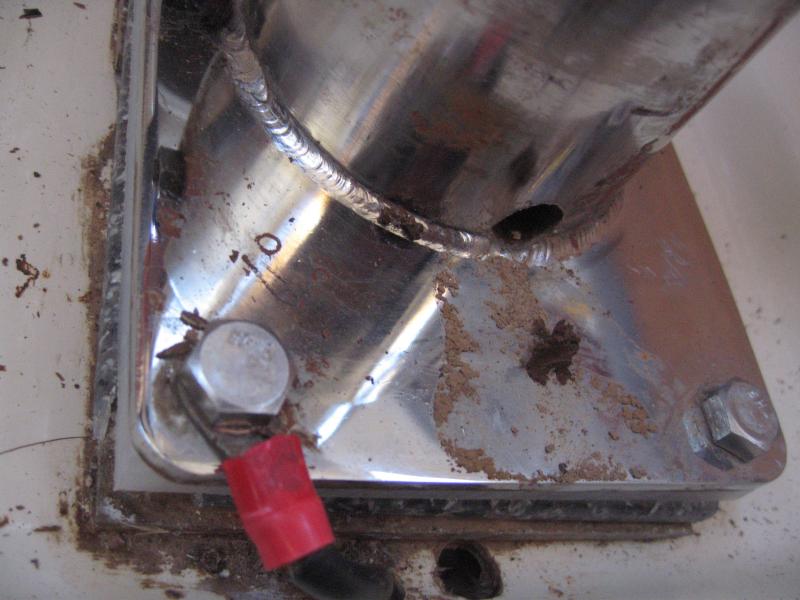

In reference to the cabin sole (teakwood floor) I dont really have a problem. You can see in one of the pictures that it seems that some of the narrow fiberglasss bridge that runs just behind the post base is sagging downward. I assume this was not like this when the boat was new. My sole around the post base does seem to lack some support due to this sagging but the floor boards remain straight. I plan to glue in some thin wood shims under the wood floor to create more support. My main concern was always the slight depression of my top deck near the bottom on the mast.

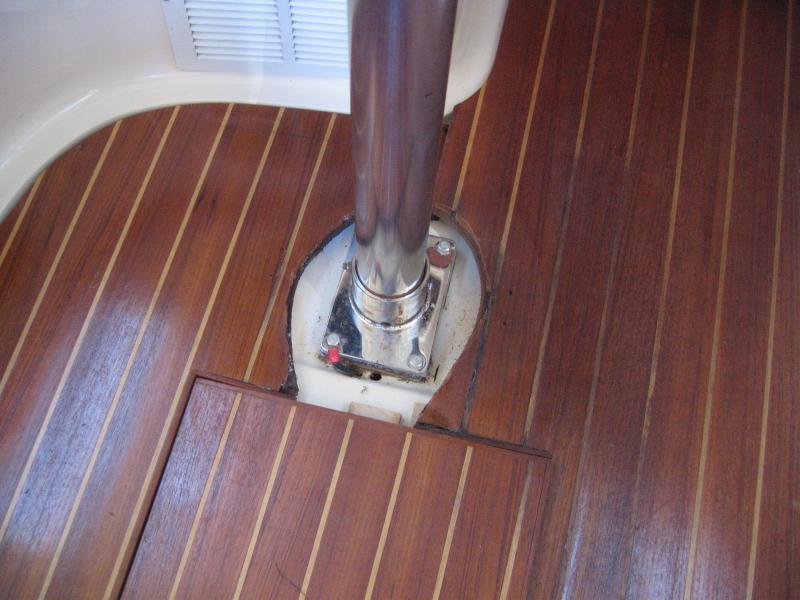

My biggest issue now is the rotting and delamination of the floor wood around the compression post base. It is as if water ran down the post and saturated the wood near the post. I have removed lots of dirt from inside the mast base and cleaned the weep holes and hopefullly this will help to keep the problem area dry. My rot was so bad that I have now cut it out causing a little bigger hole in the floor. I found a nice round peice of wood at my local lowes and it is the perfect coverup for this hole. I will post some pictures of what I am talking about tomorrow when I go to the boat. I can always rebuild some new floor pannels but as log as this big round peice of wood looks ok I will put that job off.
May 24, 2013
23
hunter 336 bear lake

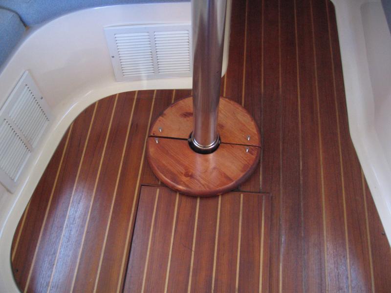

As I said I had a little rot around the base of my compression pole from water intrusion. I had to cut out a much bigger circle to remove the rot then I still had to re-laminate some of the areas. I did this by forcing carpenters glue in the loose layers of the floorboard and the clamped and allowed to dry. (see pic).
I then found this big round wood shape at Lowes and cut, stained and sealed it and use this to cover the ugly hole. My wife says it looks like crap but I say It beats replacing the floor boards for now. (see pics)

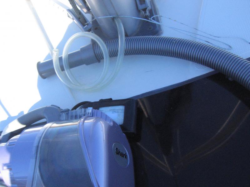

I also wanted to show the sophisticated piece of equipment I used to suck the dirt out of my mast base. ( flexible piece of tubing with my vacuum) I also wanted to show the dime sized hole in the front of my mast. This may be from the factory or some previous owner may have drilled this hole. (see pics)

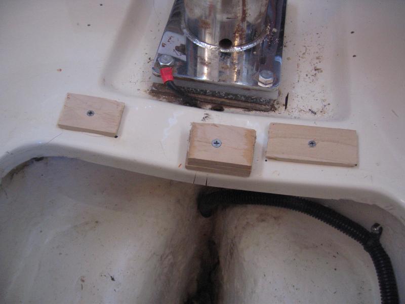

I also attached a pic of the small wood shims I installed to support the floor where a slight sag has occured in the fiberglass bridge just aft of the compression post.
Finally I am happy to report that after all this effort the drain system on my mast, step and post seem to be working the last picture shows evidence of water and dirt flowing out of the weep hole at the bottom of my compression post. I also believe that the fact that the wood flooring has been cut away from the compression post base will allow any water that makes it down the post to run into the bilge and keep it from wicking into the wood flooring and causing further rot.
