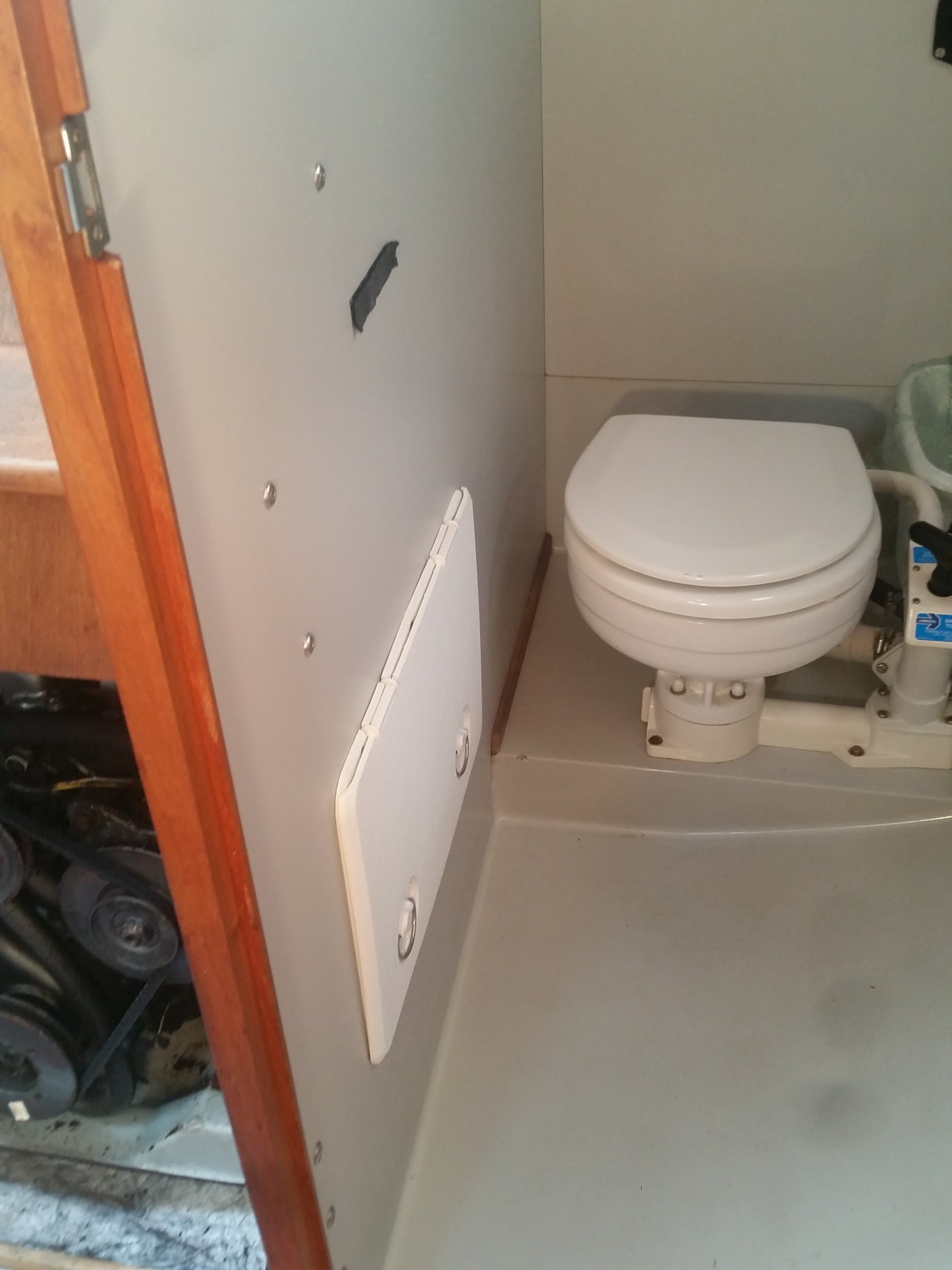

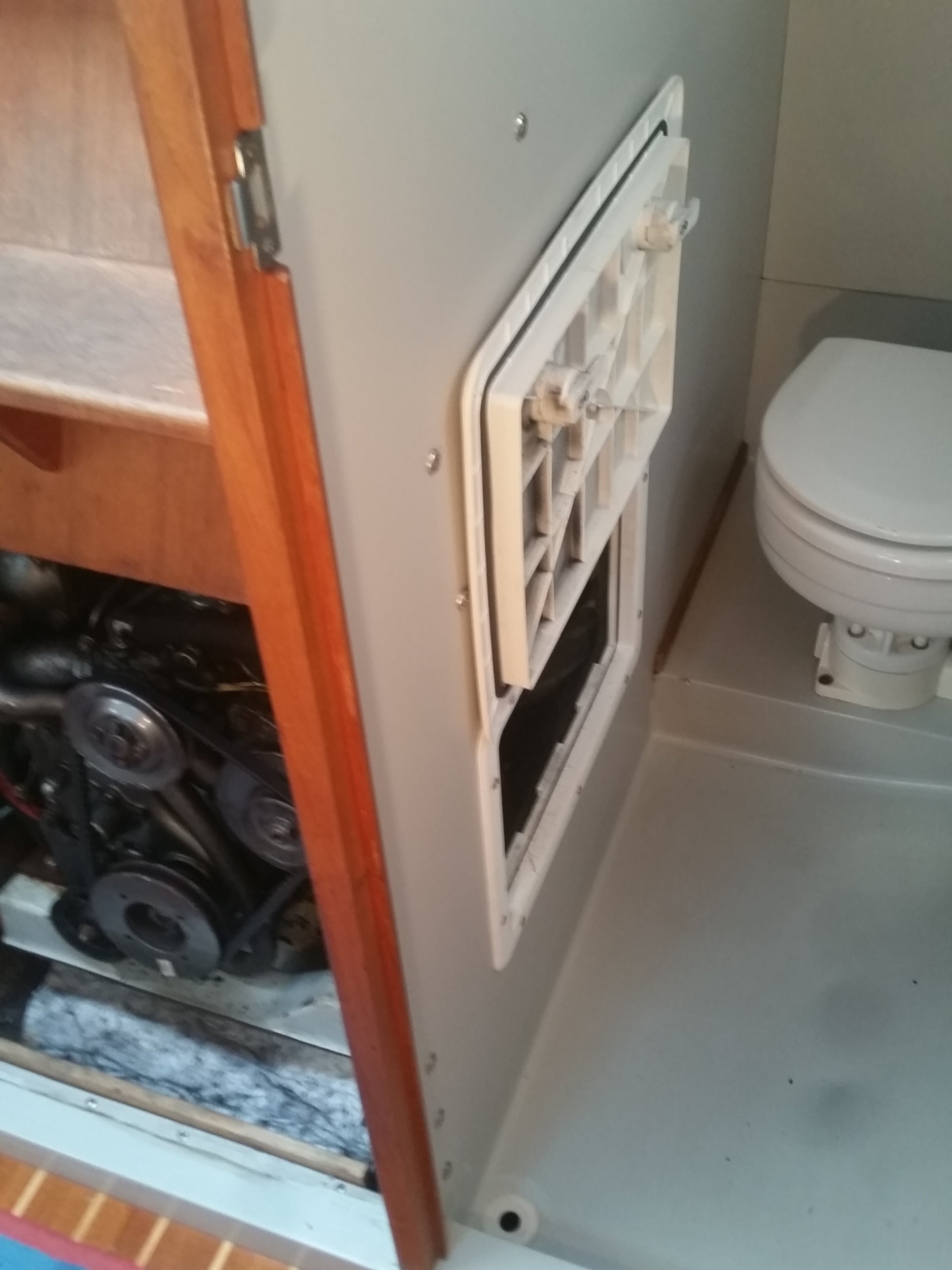

The PO installed this plastic hatch. It provides decent access to the engine and lets in extra light. This hatch style is fairly waterproof too which is nice as it keeps shower water out of the engine compartment. It's mounted so the door swings up, which is hard to keep open - the velcro adhesive lasts 3 minutes before it swings shut. I will rotate this 180 deg so the hatch door opens down.

Nice, but I think I'd rather have it removable. Could have used that access when I replaced my alternator this past summer. It's "on my list!".
