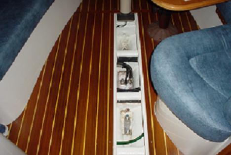

I finally received the required information with regards to the keel bolts and nuts torque setting. The info came to me via tech support from Catalina. The 1" bolts have a 1 1/2" nut and the tourque is 235 ft lbs. this is for my wing keel, the models with the fin keel have an additional 1/2" bolt that requires 39 ft lbs torque
