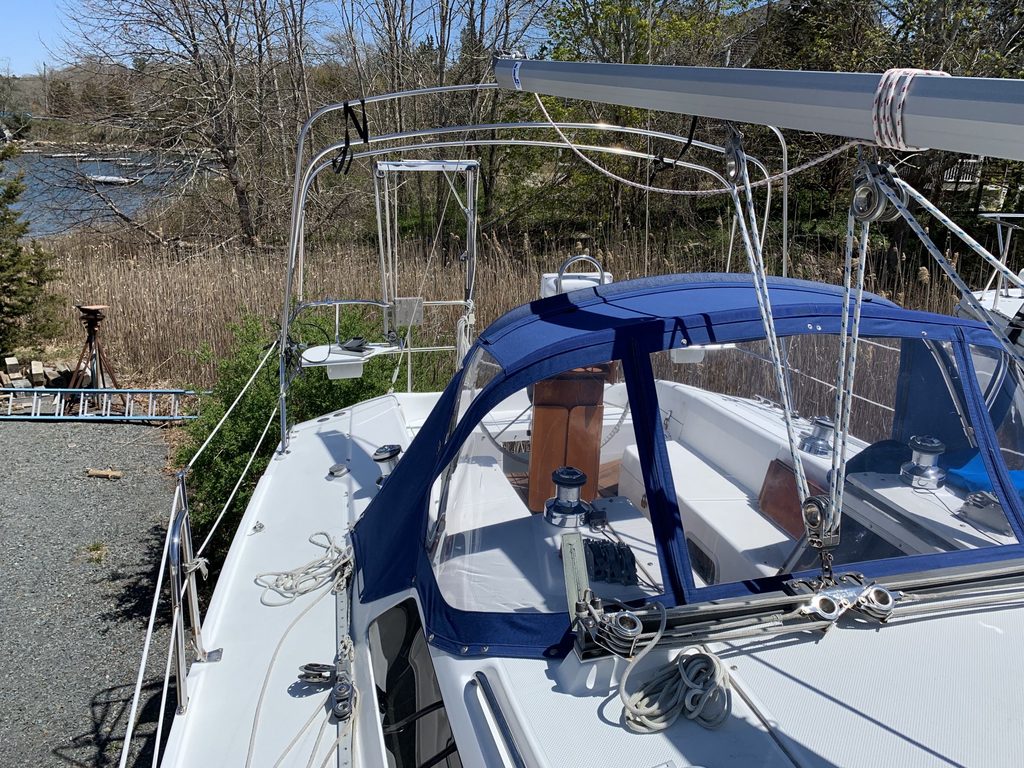

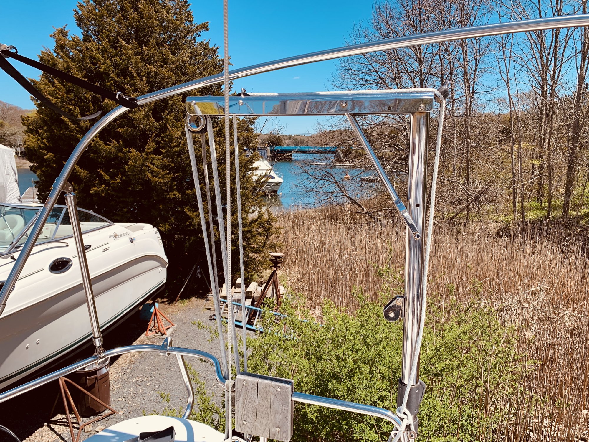

It came with the boat and I didn't choose it - so I'm not exactly sure which model it is. We also haven't used it very often. It's intended to be a lift for the dinghy motor, but I found that if I lift one end of the dinghy rail with the lift and the other by hand, I can secure the dinghy pretty nicely on edge and secured to the pushpit. I don't have a picture with dinghy secured. I have a few photos of the davit. I'm pretty sure it is the LD 6-1M Short. The differences appear to be the arm length and the tube diameter. I haven't measured either dimension but I think it's pretty clear that I have the 26" arm and the 1-3/4" tube diameter. The weights are very light so no need for the beefier model.
I don't have a picture of how it is mounted. Obviously, the top attachment is mounted to the pushpit rail. The bottom mount is secured to the back side of the stern bulkhead below the deck level. I thought about buying another lift so that I would have a lift on both the stbd and port sides and I would spread them out more to the sides (pretty much where the motor mount was (I took it off) to function better as a dinghy lift. I haven't had the urge to do that project so I haven't bought another and the original is still where it was originally mounted. I took the motor mount off because the wood was checked and I don't have a need for the mount anyway. If you mount the dinghy edge-wise across the stern, then you would need an alternate way to fly your colors!
