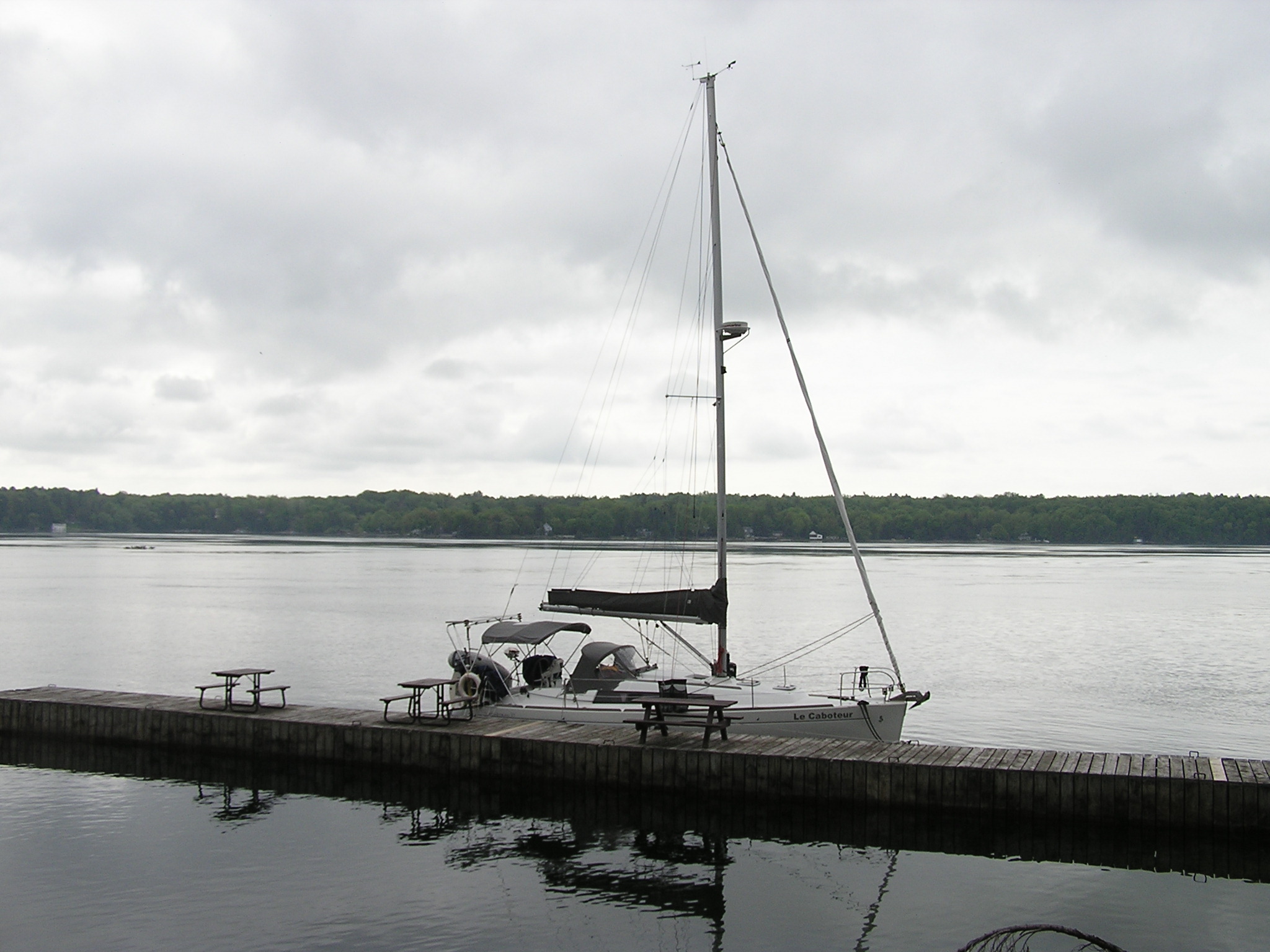

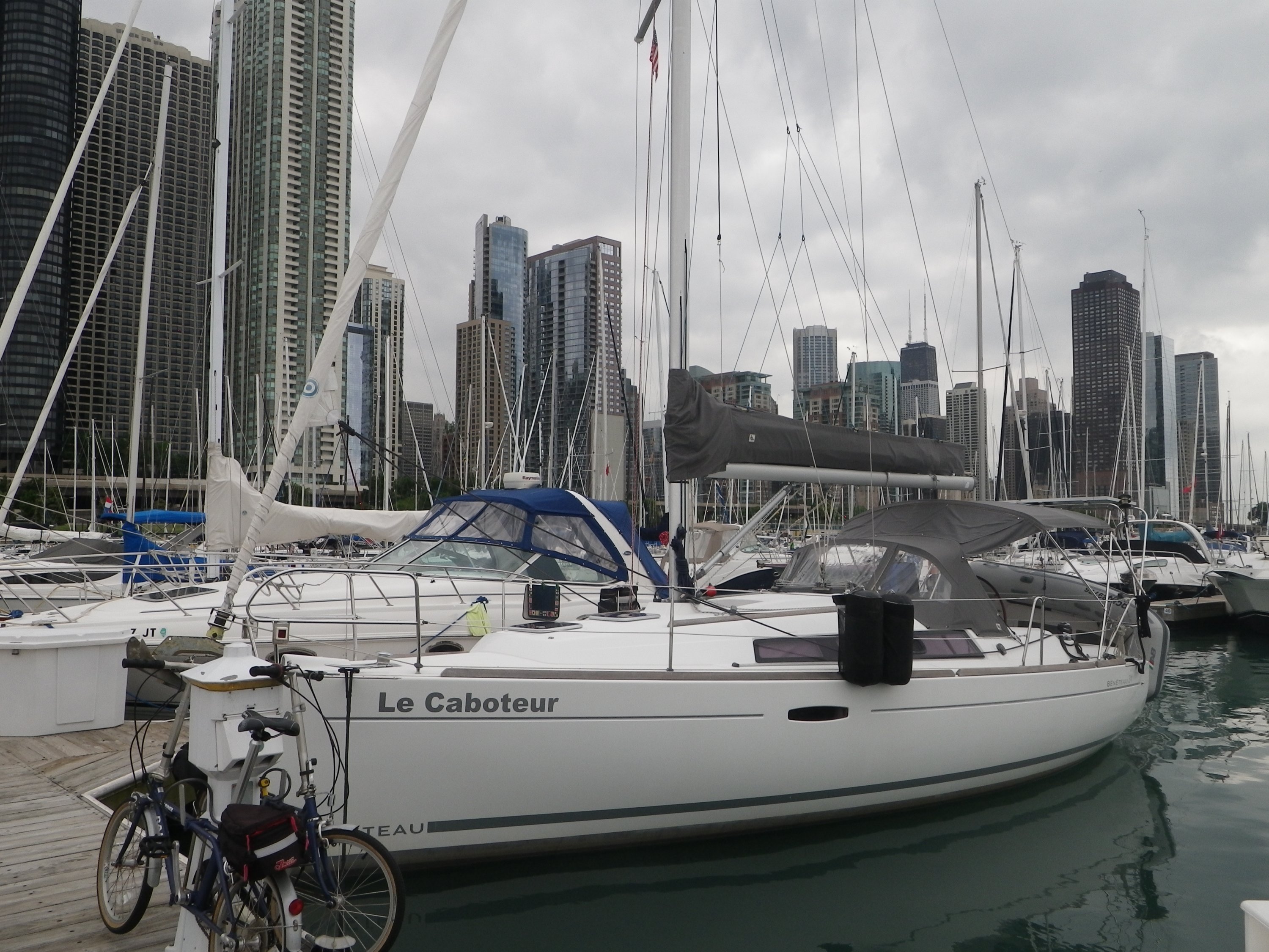

I'm sorry the images are not fantastic for demonstration of the davits etc... My dinghy is a AB 8½ ft hard bottom and quite heavy, it was impossible for me to heave it on deck alone. Because the 31 (a descendant of the 311) is such a small boat (for davits & solar) I opted for the Weaver snap davits with the removable davit heads. This way when the dinghy is in the water and the davit heads removed you don't catch your toes while using the swim platform. I wanted the solar panels to be inobtrusive and keep the bimini removable, they are therefore positionned behind the bimini and are high enough that all may walk through without hitting their head. I attached a pulley system to raise & lower the 8hp Yamaha I use on the dinghy. The 31 has a rather wide stern and the dinghy clears water & waves on every point of sail. The panels are 85W each and keep the fridge working all season long; the boat is on a mooring and beer (water etc) must be kept cold at all times!

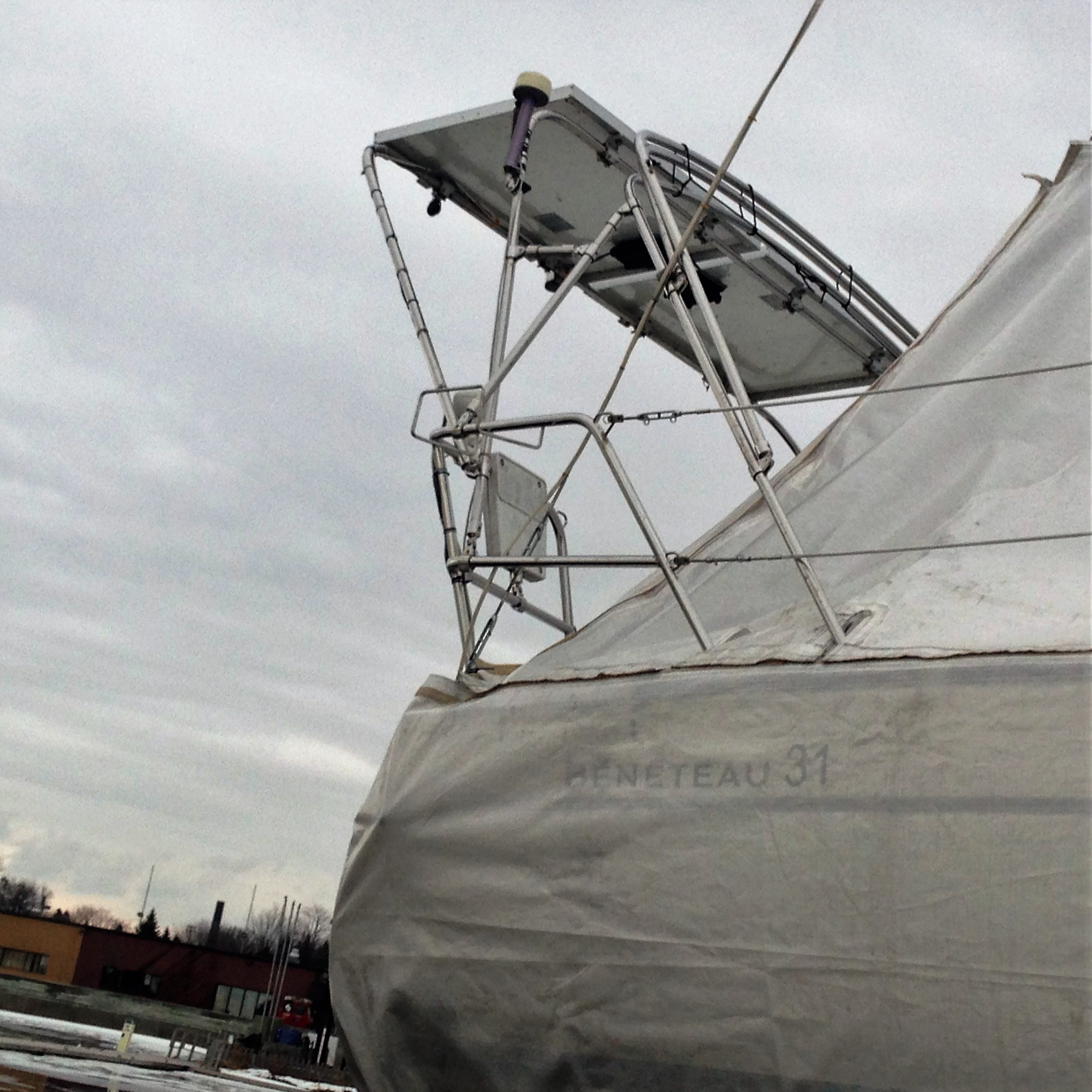

There are only two stainless tubes, they are attached to the stern rail with a hinge. I had a local canvas dealer bend them to my needs. The forward tube is attached to the bimini support.
On this site if you go to "home" "resources (beneteau)" "31" "owner modifications" you will find the solar panels and added batteries along with several other "improvements" I made. The next ones to come are a larger cockpit table and drawers in the galley... Work to be done this spring.

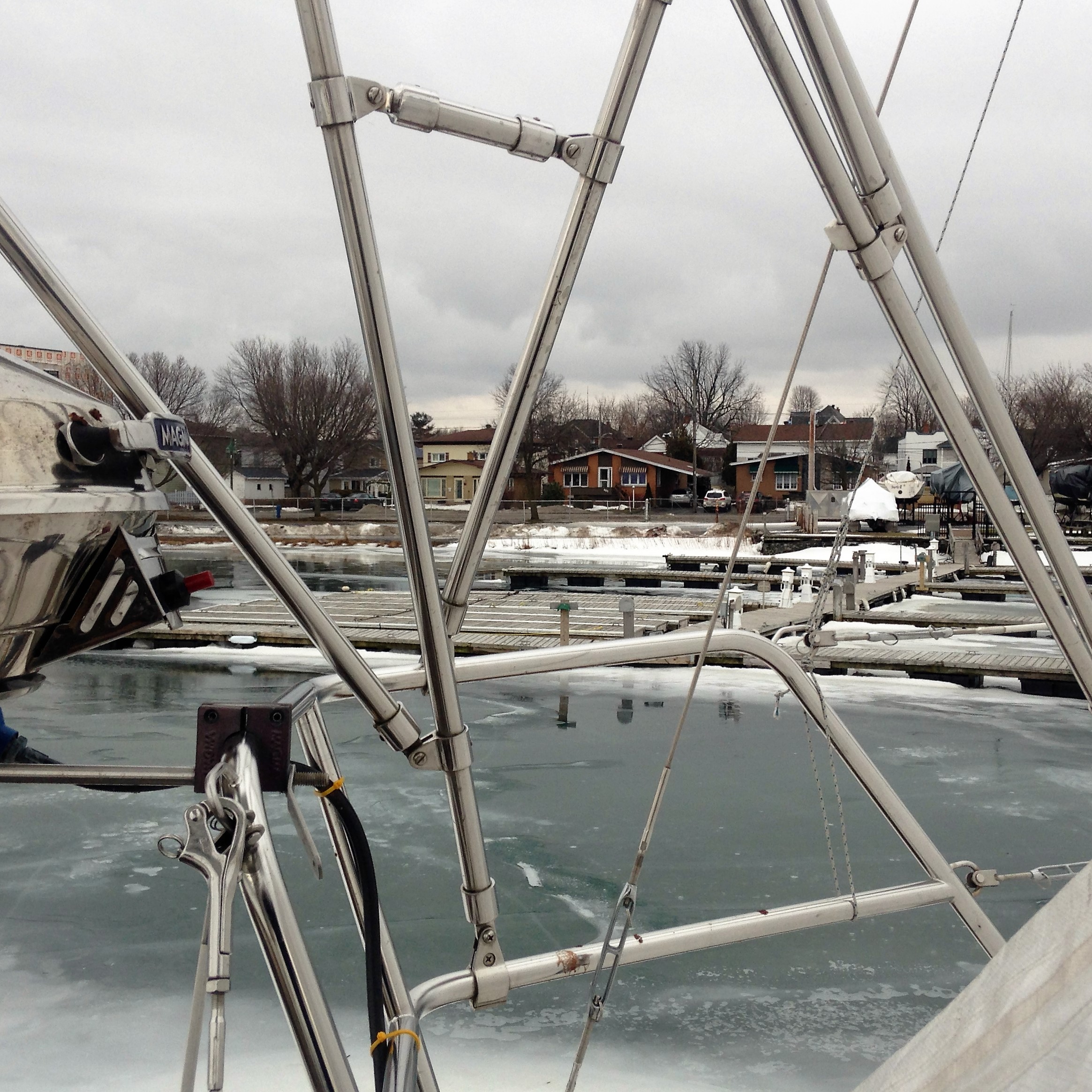

I went to the boat yesterday: pics of the Solar-bimini setup
