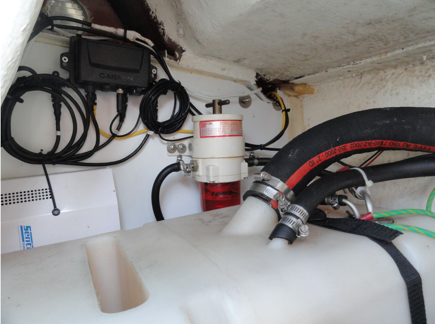

It's the bulb keel. Hauling it on Monday to inspect the bottom. Had to search to find the diesel water separator filter. Terrible location, buried in aft cabin in back of the engine compartment. You have to take out the cushions, and the way it's located you can't see the bowl. Bad location for changing the filter or inspecting it. Has anyone just changed this out for a Racor and mounted it in the engine compartment? Also, has anyone cut an access panel in the head to get at the starboard side of the engine? Would appreciate any 311 owners input on what to look out for on this model.... thanks in advance.

My filter is right at the bulkhead behind the tank. A bit of a pain to drain but not terrible.
