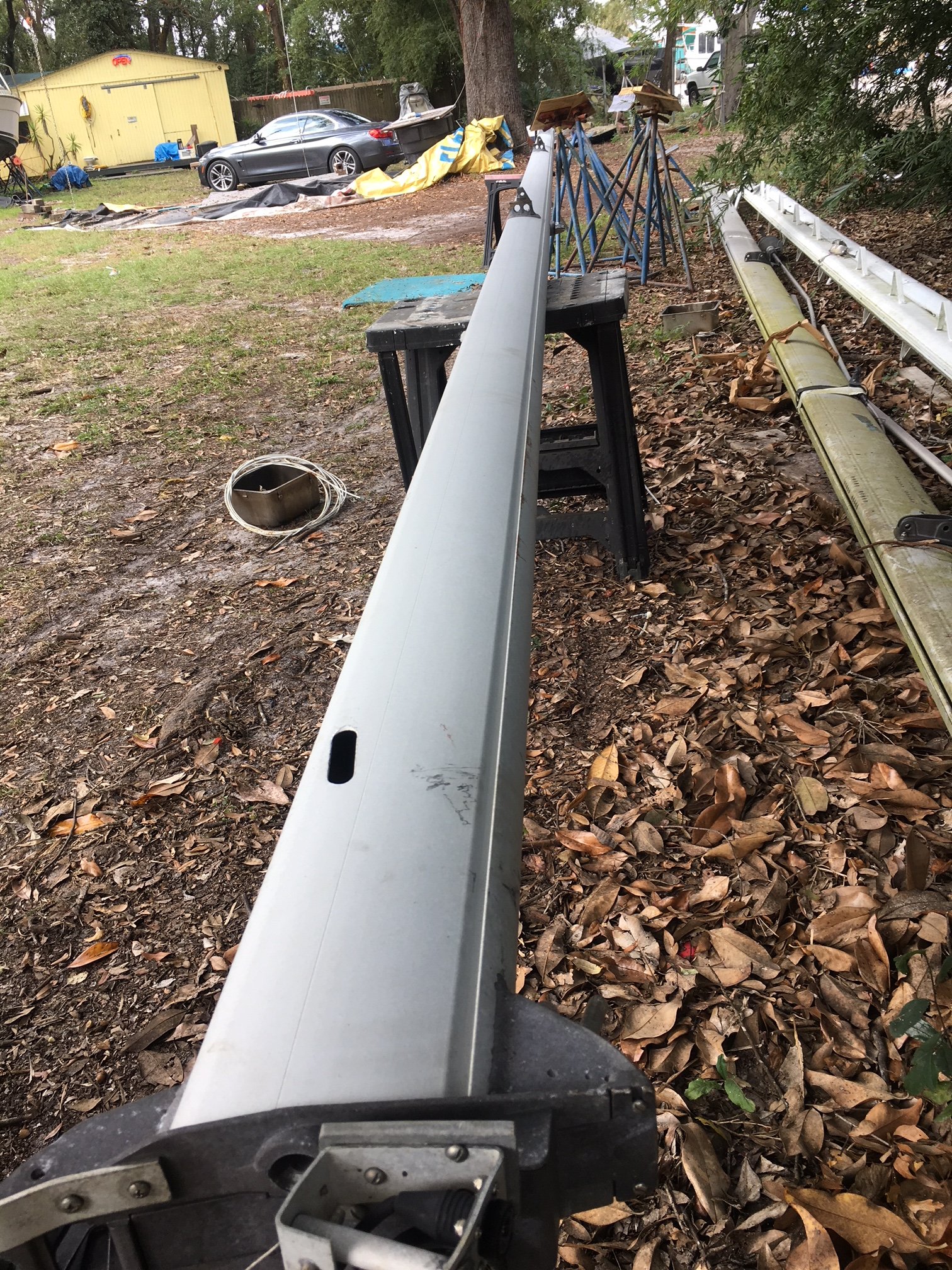

As Bob stated - brackets are welded to mast - zoom in on attached pic without spreaders and you can see bare bracket

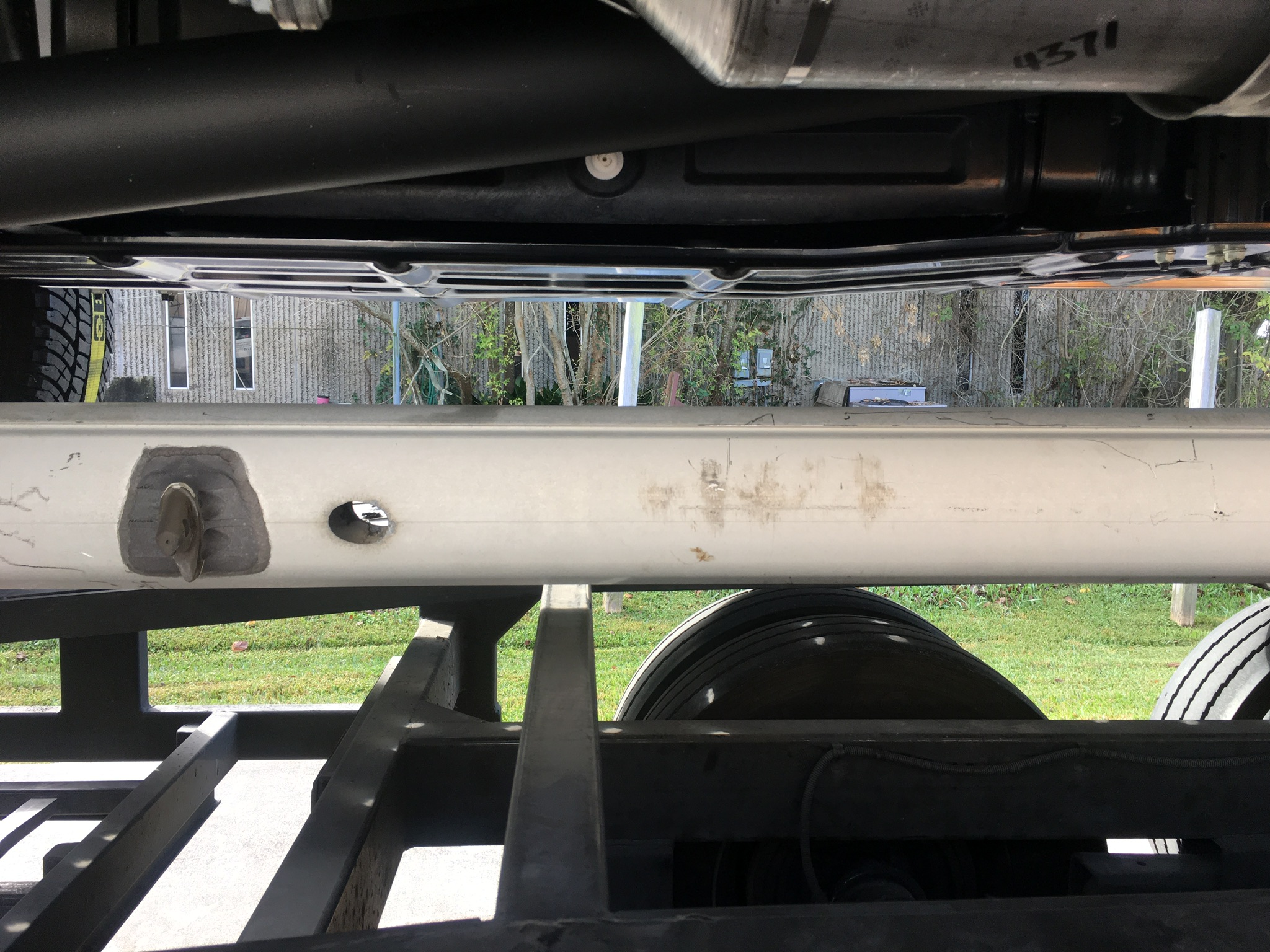

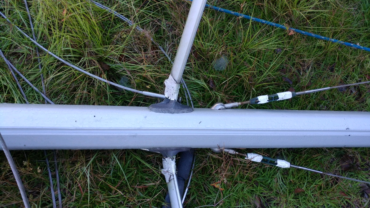

Bob, attached is another pic of a spreader bracket for a replacement mast I'm installing. You can see where the bracket mount is welded to the mast. I have other pics of the mast when off the boat but won't be home for another week to send these to you. The welded bracket is how the spreader mount was on my prior mast and the replacement. This has not been a cause for concern for me and the rigger doing the work has not stated anything to cause alarm. You do need to inspect the spreaders themselves to be sure there isn't any cracking at the ends. If so they need to be repaired by welding cracks. IMG_1321.JPG

Can't speculate on what you're saying. What I can state is my previous mast which was off the boat in April and and thoroughly photographed and inspected by the rigging company as well as my replacement mast look identical with the welded bracket mount area. Both of these masts are made by Isomat.
