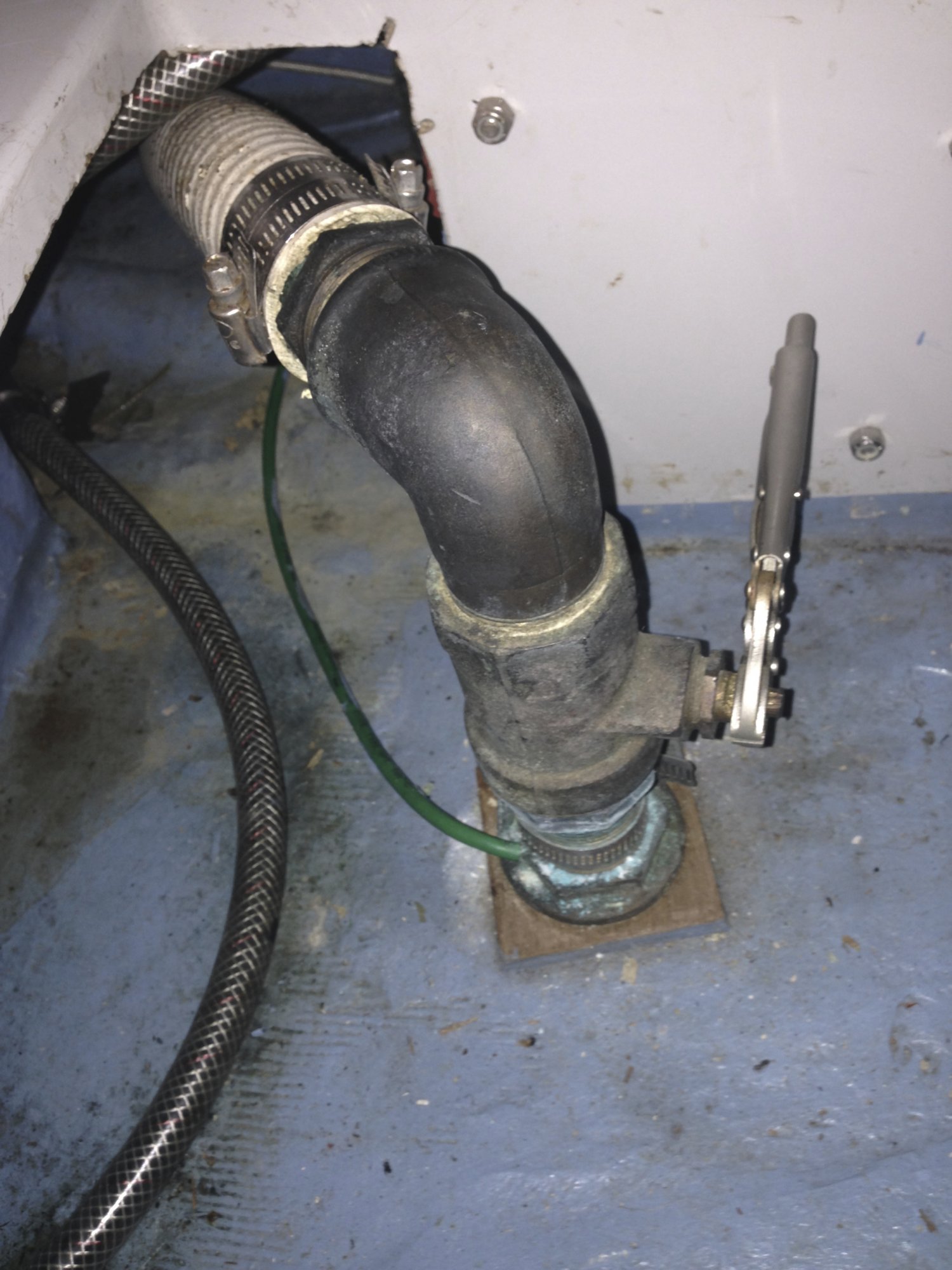

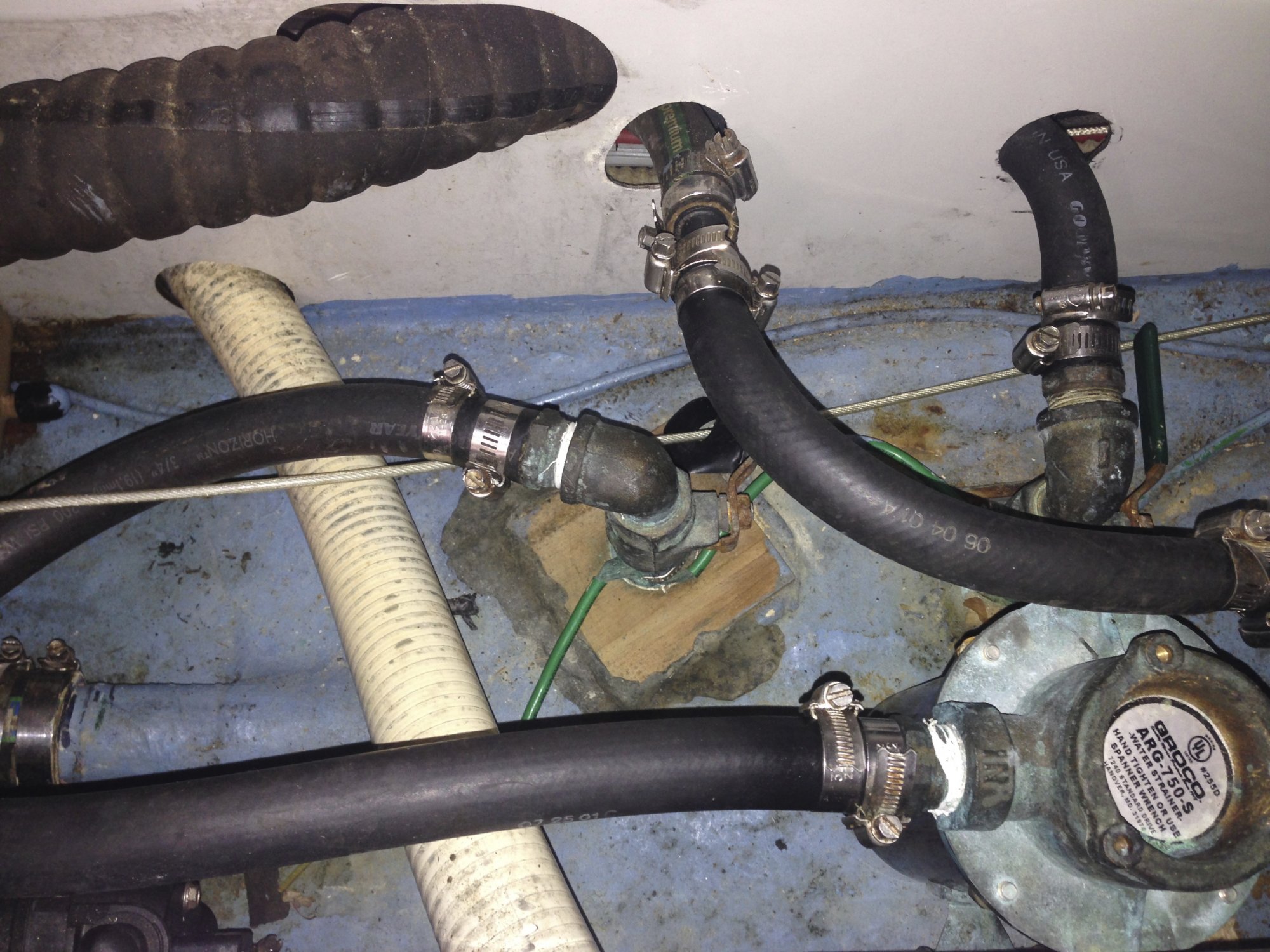

I am curious to see any photos of the raw water intake/system from your 302's. Part of my refit was to redo all the seacocks and hoses as what was on my boat was either original or just done poorly since (photos attached). The original seacocks were quite worn out and many of the backing plates were just wood and saturated. I ordered and am installing all new Groco seacocks and fittings with proper backing plates.
In my case the previous owner had plumbed a deck wash down pump on the same feed as the engine raw water intake using brass T-fittings, so I am going to move this to the intake for the head system. I also am planning to install a second raw water strainer for the head water intake (since I have one). This is a bit of a challenge since space is at a premium.
My new engine raw water intake seacock is now a Groco IBV 750 with a proper backing plate. But the raw water intake hose is 5/8" and I am wondering how to adapt this to 3/4" fittings for my seacock. I can't find a bronze elbow anywhere that goes from 3/4" NPT to 5/8 pipe hose". I can probably force the hose over the 3/4 fitting but this doesn't seem to be the best idea.
Any suggestions?
Any suggestions?
