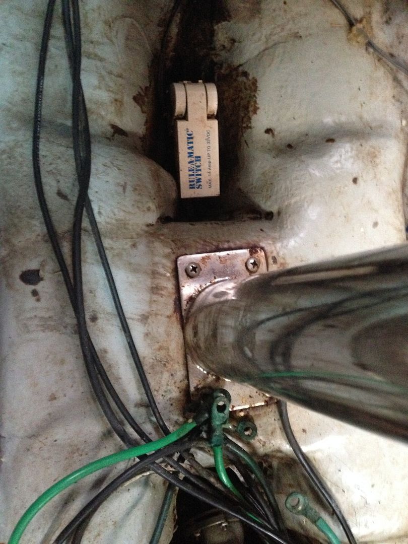

There are 3x1" diameter bolts and 1x1/2" bolt for the 302 keel. According to my O'Day manual, the torque for the 1" bolts is 280 Ft Lbs. The torque for the 1/2" bolt is 70 Ft Lbs. Two of the 1" bolts are visible in the bilge. The third is under the table pedestal. The 1/2" bolt is behind the bilge lying under the pump out line. You will need a 1.5 inch deep socket and an 8" or more extension for the 1" bolts.

Evan.....just out of curiosity, how do you get to the one under the table pedestal? I saw four screws that hold the pedestal to floor....is it hard to get the pedestal out of the way to get to the keel bolts?
Feb 5, 2015
38
O'Day 302 Ottawa
I attempted to torque the accessible bolts this past fall while the boat was in the water. I'll be going back at it this week as we get ready for launch. I am planning to undo the four screws and loosen the connection to the deck to move the pedestal out of the way to access the bolt. I'll let you know how that goes.

As Jibes wrote, the amount of torque and the space in which to work make torquing the bolts a real challenge. I am hoping that moving the table pedestal/support column for mast out of the way will give me access to the 3rd bolt and more room to work on the bolts. All of this makes me wonder how O'Day did it. There are pneumatic guns that have different max torque specs up to and beyond the torque for the 1" bolts but none of them are designed to set torque. So the only way to ensure torque is correct is with a torque wrench.

I have no doubt that the pedestal is designed to support the weight of the mast and that taking it out while the mast is up and under tension would put to much stress on the deck. The mast would have to be down to get the pedestal out of the way and to reach the third bolt.

The manual I have shows a cut away of a 322 which seems to have more bolts. I also have three 1 inch bolts and and one 1/2 inch bolt. The forward 1 inch bolt is under the table pedestal and inaccessible without moving the mast to clear the pedestal.
