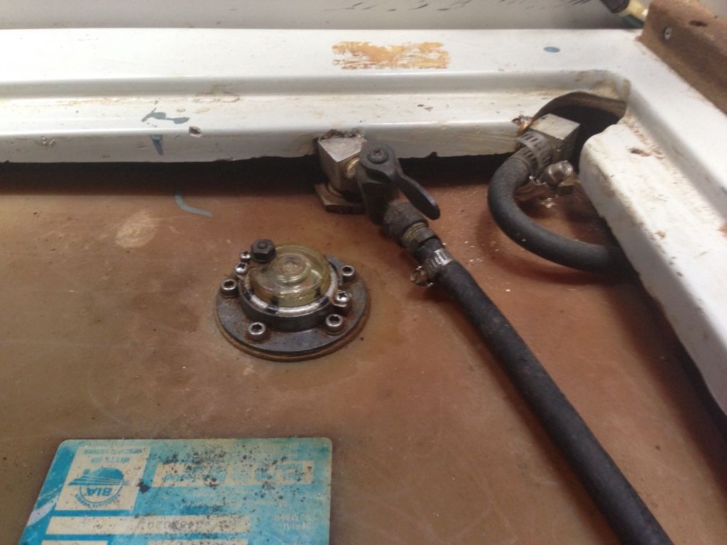

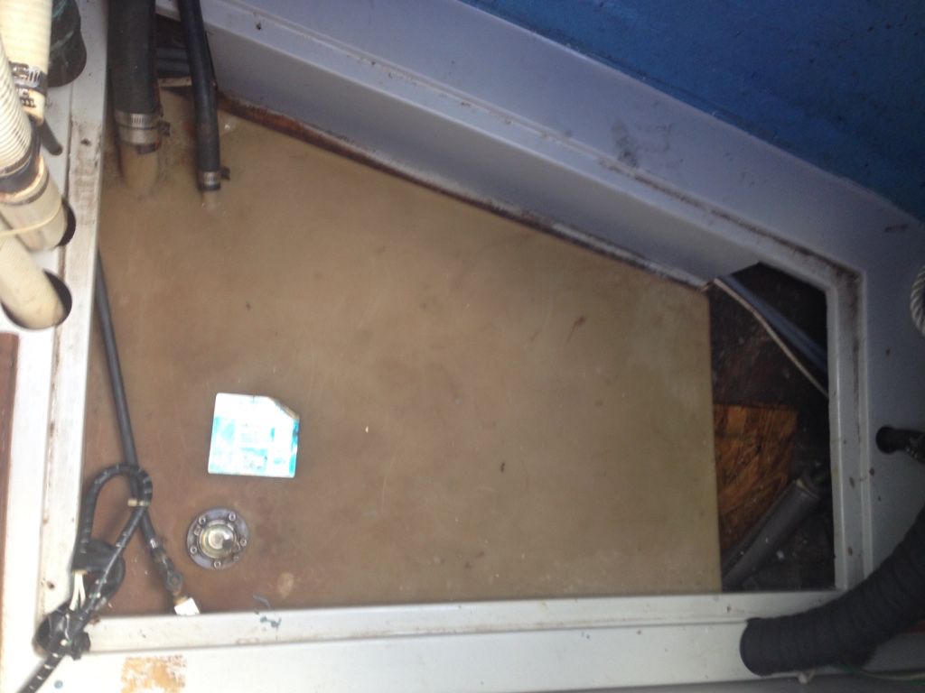

I am curious for those of you who own a 302: Does your fuel tank just sit in the lazarette without any mounts to hold it in, or is there a mounting system? When I was replacing my exhaust hose today, I noticed that my tank was up agains the hose making it difficult to pull the hose through. The only thing I see securing my tank is the plywood board that screws down over top of it (not shown) and the fuel hoses.
Is this normal? Should there be a shim between the tank and the middle area where the hoses pass through (in the bottom of the first photo?)
(The plywood under the right side was just to shim the tank so I could pull my exhaust hose through.)

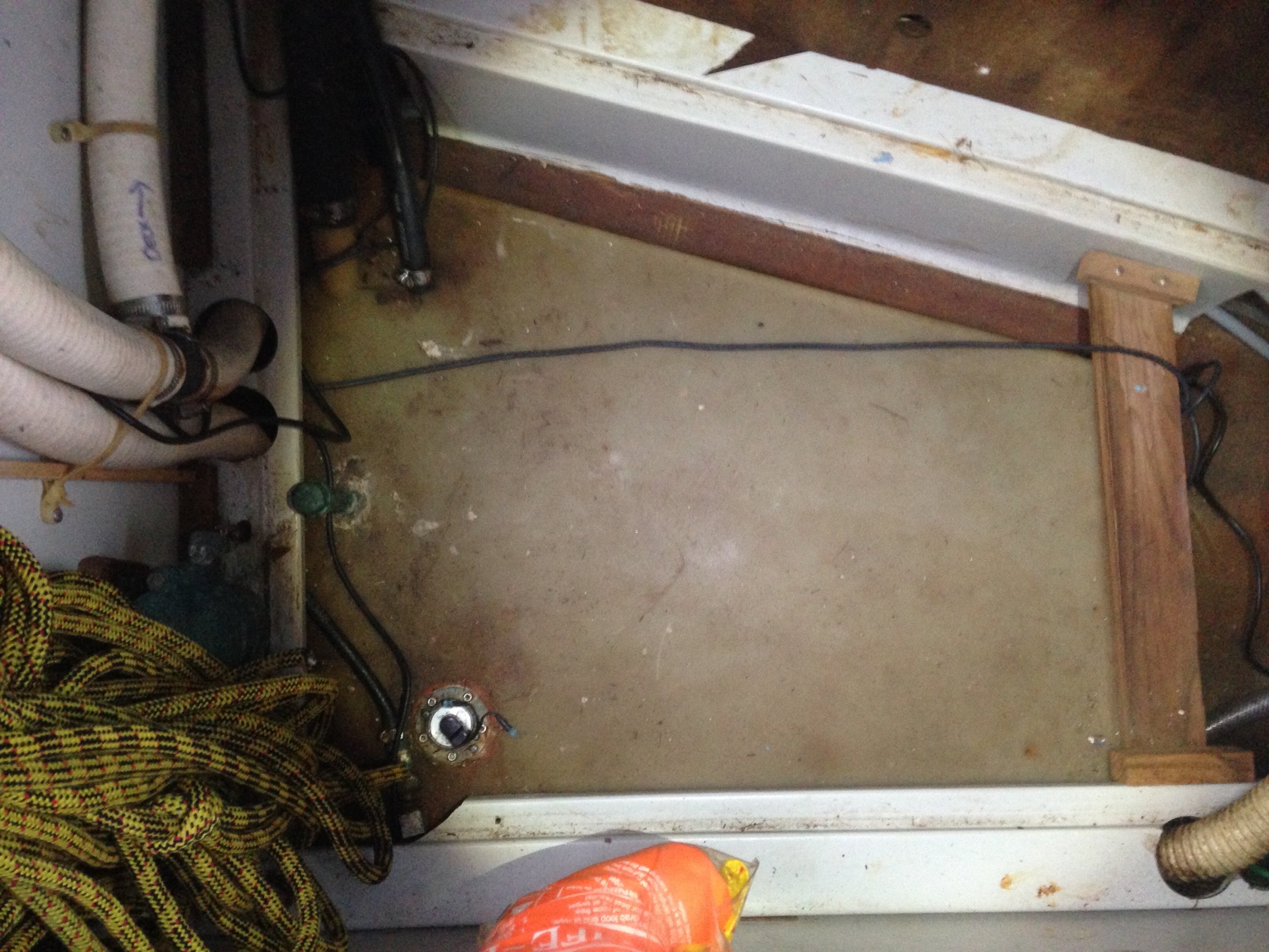

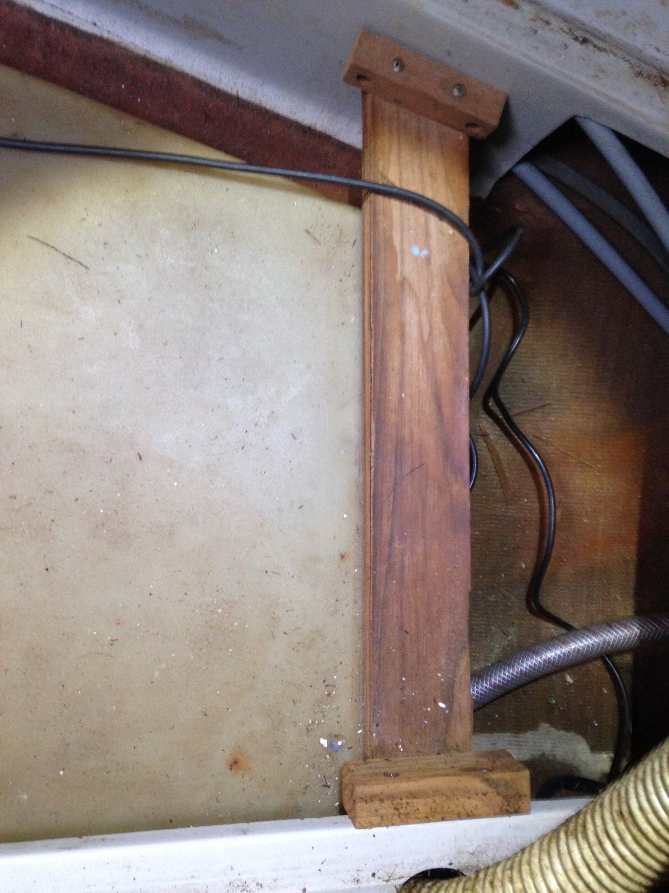

Mack - mine is identical except I have wooden "crossbars" at either end of the tank to pin it down. I have the same setup on my water tank as well. Not sure if its original to Oday or from the previous owner. Ill try to get a couple pics.

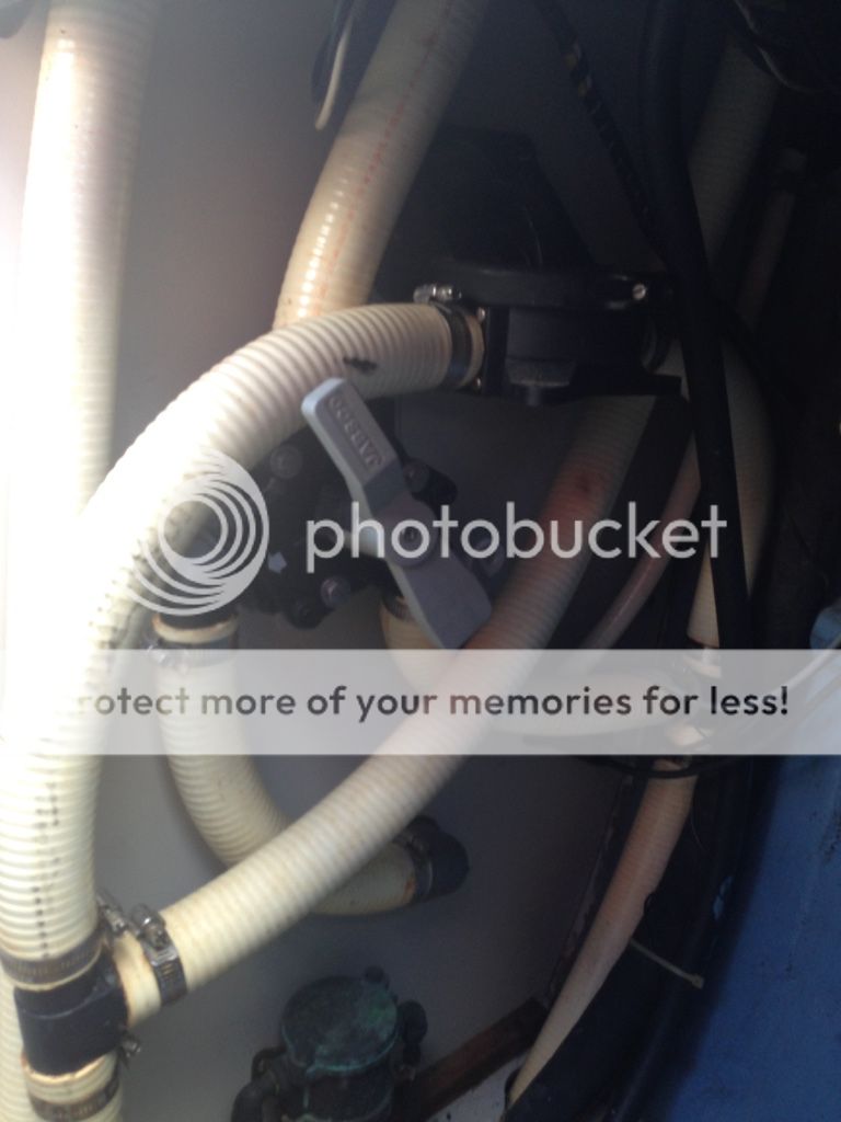

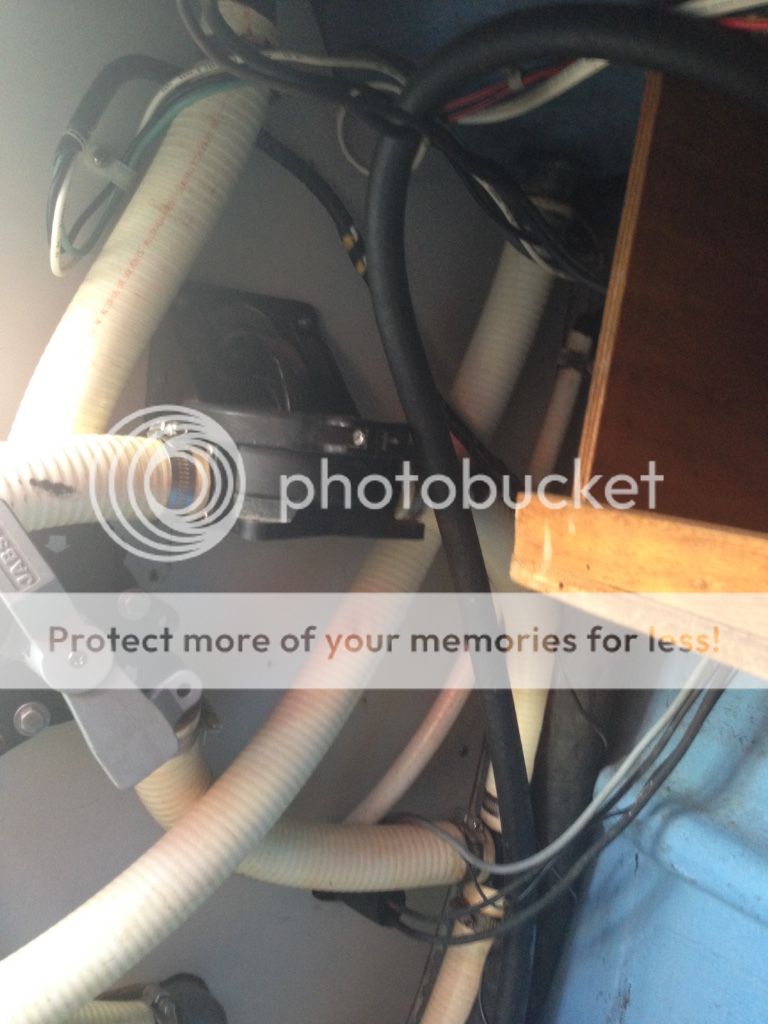

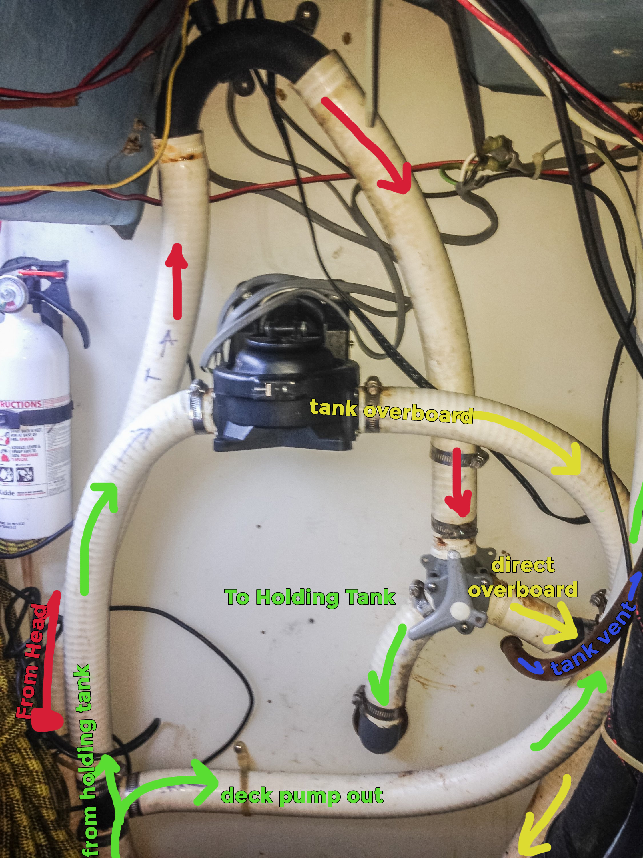

Alpine.....do you happen to have photos of your sanitation system lines in the same lazarette?
Jul 12, 2011
148
Oday 302 st pete

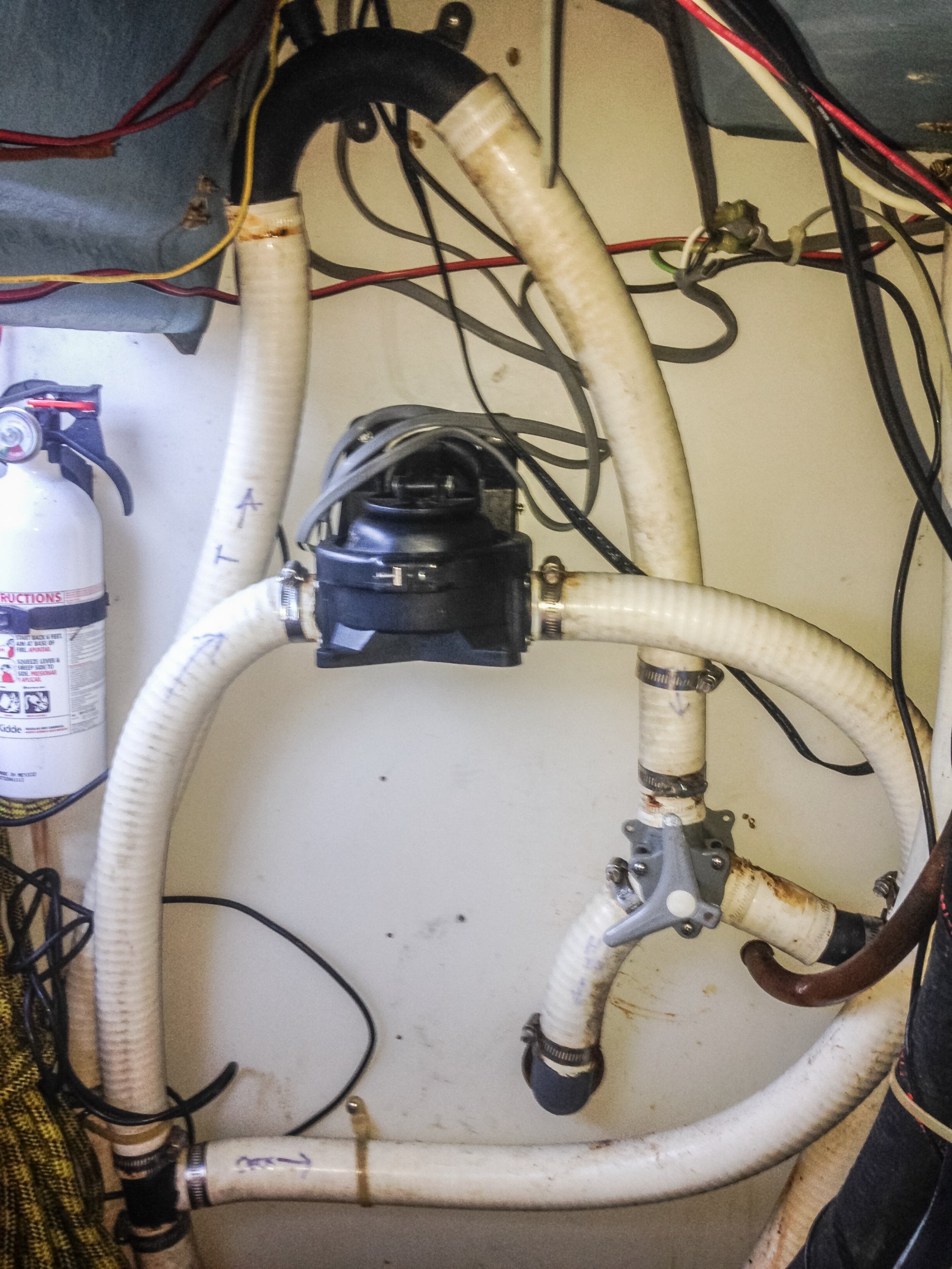

Plumbing pic attached. Not the best photo as some of the hoses overlap. Let me know if you'd like an explanation.image.jpeg

Thanks so much for the photos and the labeling. My installation is almost the same, but just doesn't look as neat as yours because my Y-valve is located differently. I think it was placed there by the PO so he could reach through the hole in the head and move the Y-Valve. I just wanted to make sure that there wasn't a better way to do it before I start replacing all the hoses.
My photos are also not as good as yours.

I'm not so sure neat is the word! Those hoses aren't actually attached in that photo. I was in the process of tracking down a clog and had all the wiring and hoses draped about. Its normally quite a bit more tidy. I found the clog - a piece of the flap valve came off and lodged in an elbow. What hole is in your head to reach the y valve?
My fuel filter is in roughly the same place as yours. You can just make it out in the fuel tank pic above the yellow ropes.

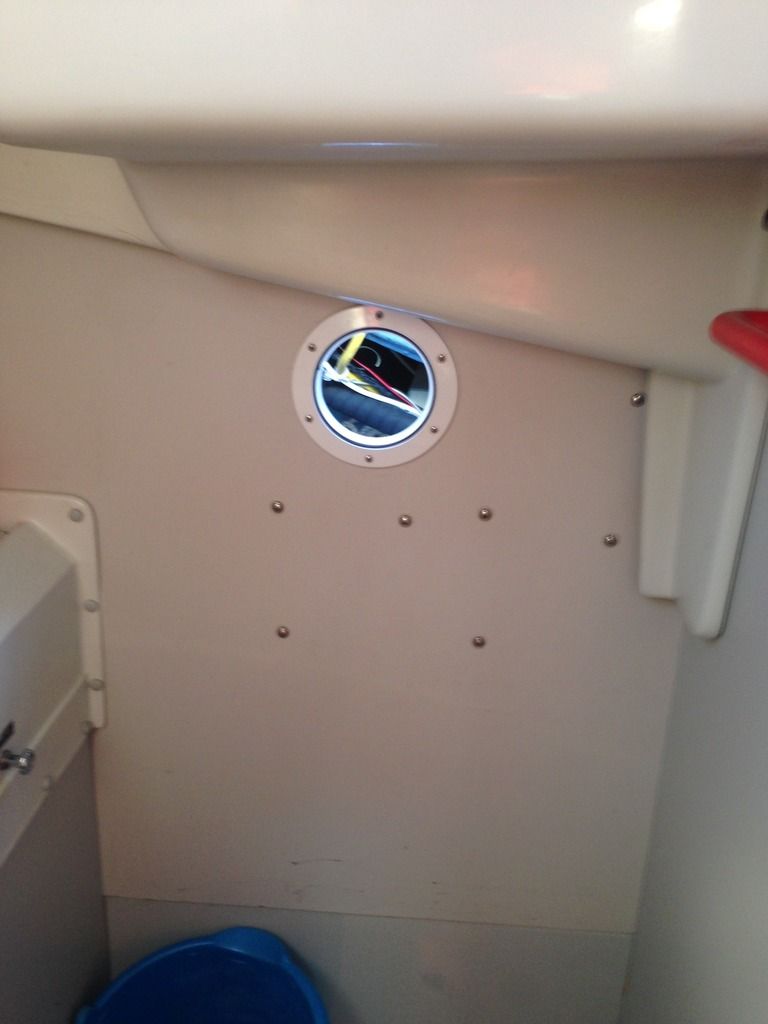

However, I did get a picture of the hole. This is taken from inside the head. I currently have the head removed because it was the only way I could remove the old, old sanitation hose. I thought this was standard on the boat, but perhaps if you are asking, maybe a previous owner cut this so that he could rotate the Y-valve when using the head.

I do not have that hole on my boat.
