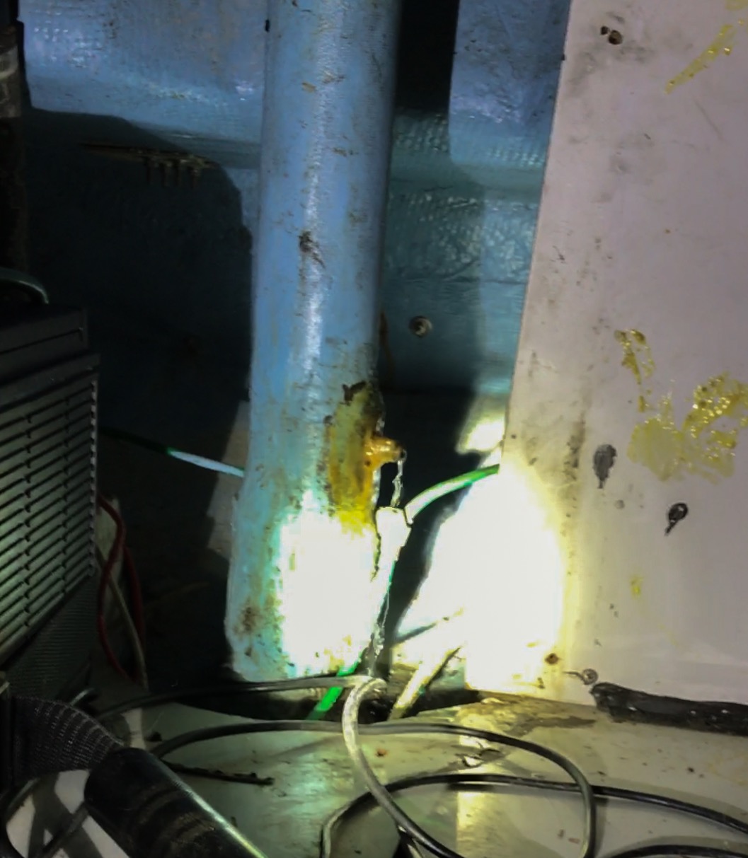

the strut on my 302 does not have any flange or bolts visible. It goes through the hull and is covered by a large half bowling ball lump on the inside. This joint has been leaking slightly due to shaft misalignment/vibration. Anyone ever patch this up? I could use some advice.

Hopefully a 302 skipper will have the best information for you but it sounds like you are going to need a grinder to get to the strut mounting. I wonder if a po just poured epoxy over it to stop a leak. Does not seem that the builder would do that. Do you have a picture of the inside hull view?

Ill get one today, but I have seen a previous post on here with the exact same feature, so I think its factory.

I have the same half bowling ball on my O'Day 302 under the aft bunk in line with prop shaft. So must be a builder solution. Thanks the_Alpine cause now I understand what it is. Has baffled me since day one of ownership. I have not seen any leaking but I have been wondering about minor cracks in antifouling at that location. Not something that the surveyor was concerned about and no leaks that I am aware of. Can't help with a solution but looking forward to hearing how you work this out.

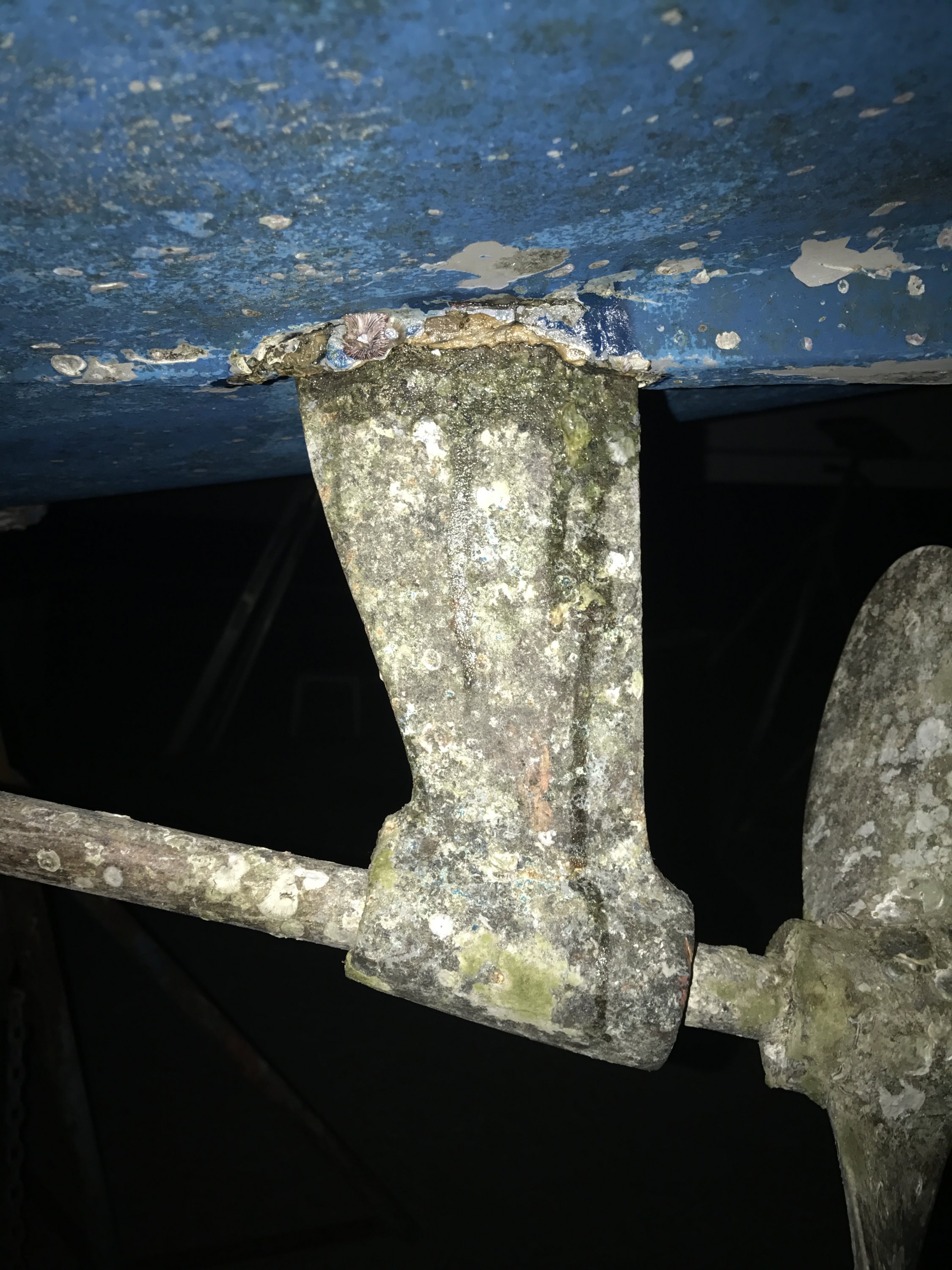

Thanks for that Panta Rei. To clarify - do you have the large half bowling ball lump?
Evan - definitely checkout the exterior strut joint. Seems like a weak point.

My boat is built a bit differently but I believe the problem and solution to be the same. My guess the half bowling ball is a very clever manufacturing technique. I believe your strut to be the universal style strut with no flange. You can see one here. https://www.deepblueyachtsupply.com...boat-struts-?gclid=CN-dtd-H29ECFYWGaQodXh4J4A This is not an exact match but designs mcange over the years. The advantage to this design is that it would allow O'day to install the engine and drive train without the tedious alignment and simply install and align the strut last. strengthening it with the big half bowling ball. Can you poke around to see any sings of a flange that could be bolted to the hull? My guess there is none. I noticed something when I was looking at the photo of your strut. The angle of the shaft does not match the angle of the strut casting. Note that shaft is closer to horizontal and the strut is more vertical. Hard to explain but look at your photo. Maybe the strut is machined at different angle and does not follow the shape of the casting. Can you take a photo of the cutlass bearing from the fore and aft? It may hold some clues.

Panta - I saw the same thing you did. Turns out the shaft hole does not go through the strut at the same angle as the exterior of the strut.

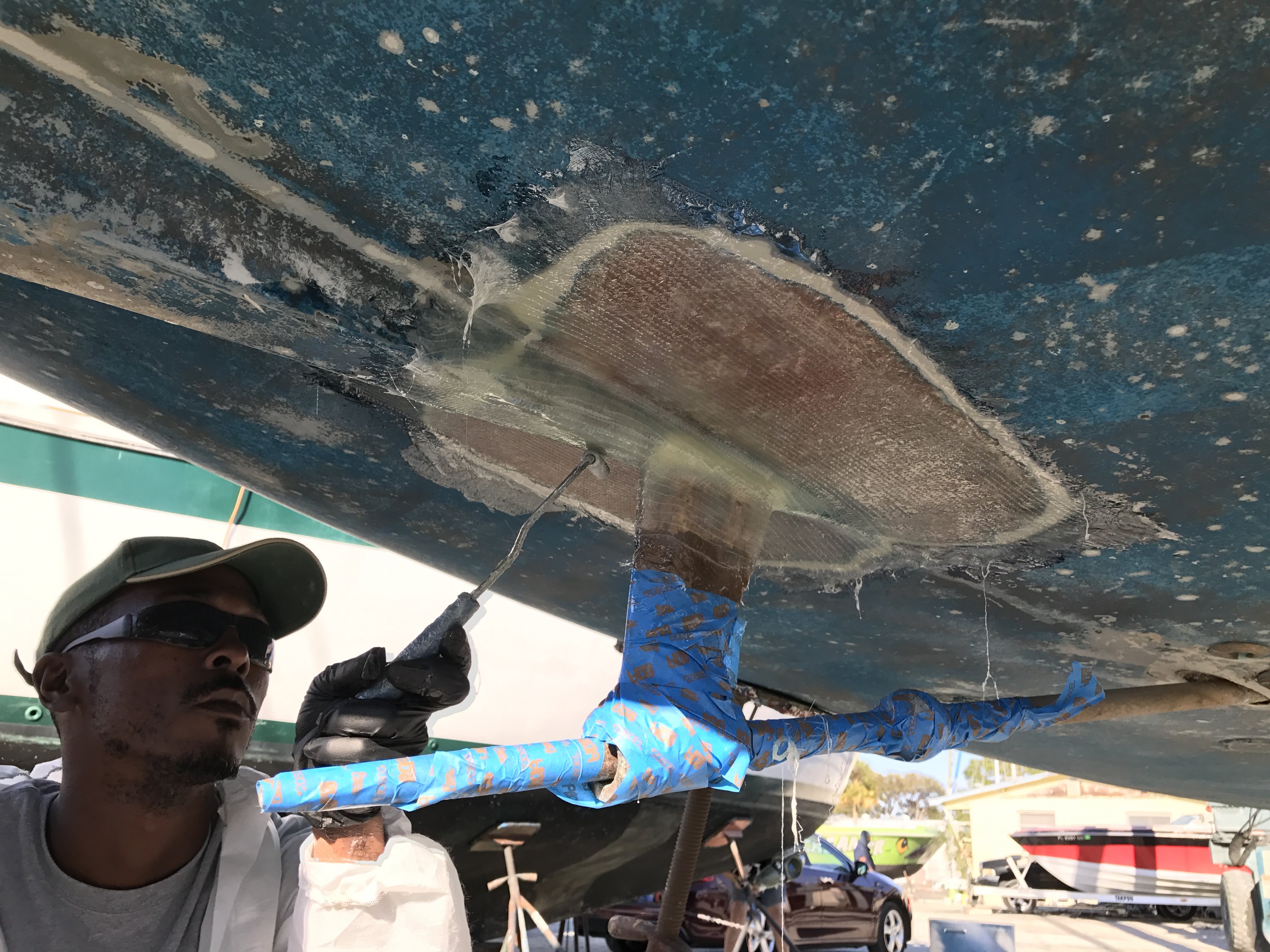

I got the strut joint exterior ground down to good material and reglassed all around her.

Oh ya, while I believe the strut was leaking water, I found the more obvious source: rudder tube zerc.
