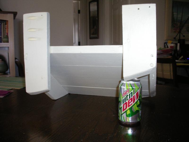

1. Trial fit of tank in space. Whew. Just makes it. Note: opening is much smaller than tank length.

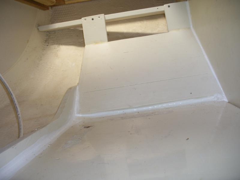

2. Platform made to fit curved port hull and support bottom of tank where it slopes up. It is sitting on an oak table for picture.

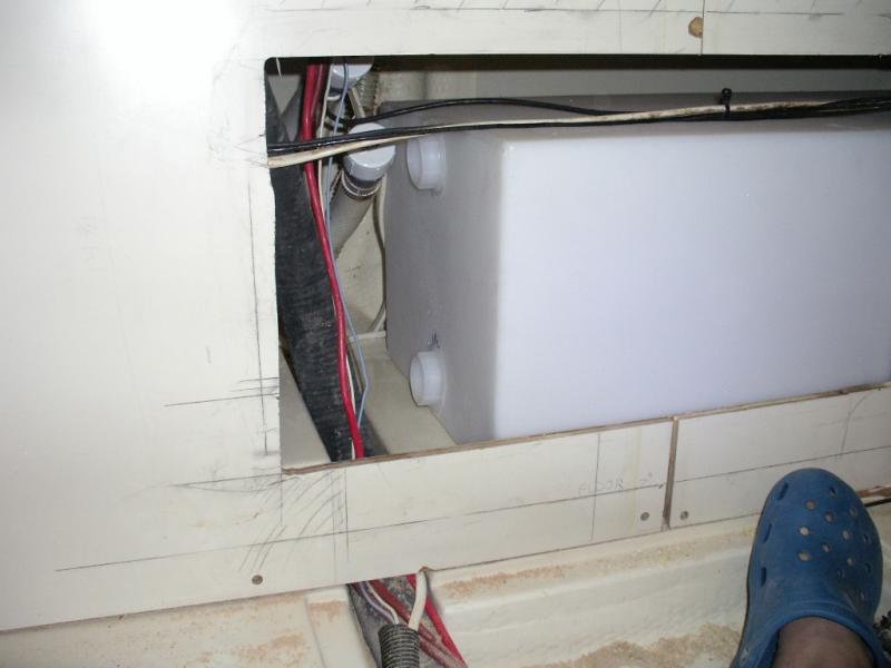

3. View from port stern locker. Note the "stringer" fore/aft that is attached to bulkheads that the tank ramp/platform is attached to. Besides screws through bulkhead and into liner, everything was 5200'd in place.

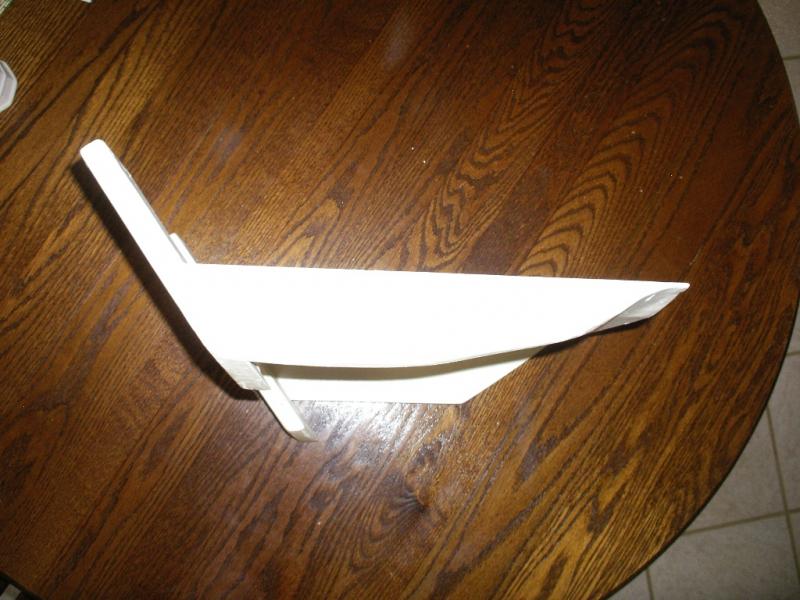

4. Tank with fittings going into opening.

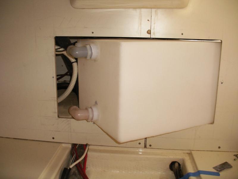

5. View from port stern locker with tank in place.

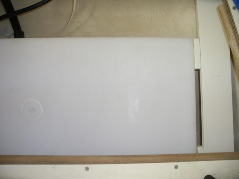

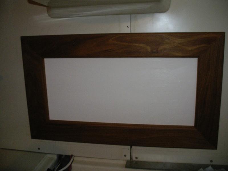

6. Replacement panel. Teak for 1x3 frame was hard to find, and expensive. Color matched paint for plywood later for perfect final match. Used T-nuts in existing panel to machine screw panel in place, for easy removal.

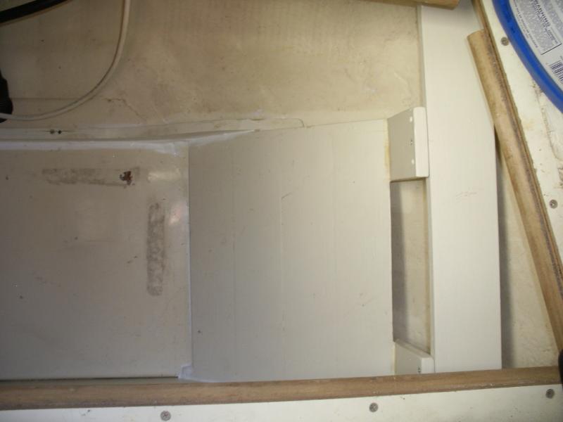

7. Platform/ramp support as viewed from what will be port side of boat.
8. Platform/ramp support in place as viewed from access hatch prior to tank installation.
