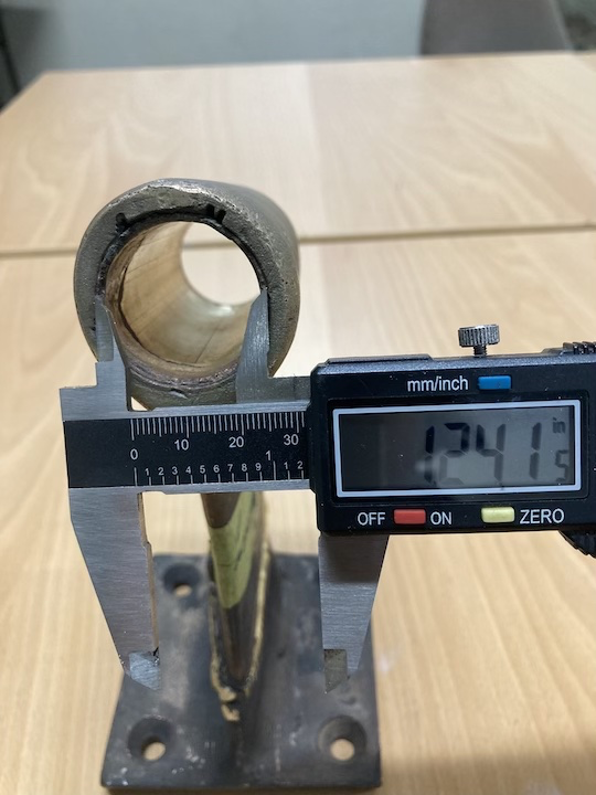

Thanks for your reply! Yes, we're looking into local fabrication - the prices are ghastly! I'm also looking abroad. Here it is!

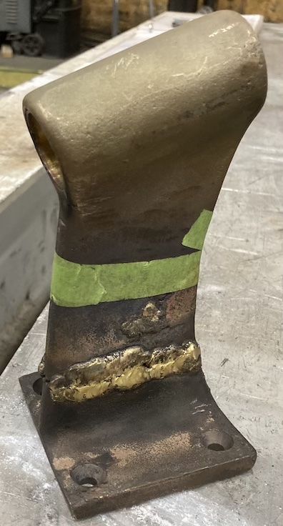

Has yours failed? Looks like it was welded once.
Looks to me like your measuring the cutlass bearing. The old one appears to be inside. Have you checked Duramax Marine for a replacement? They would need the diameter of the strut, the length of the strut for the cutlass bearing, and the diameter of the shaft.

The weld was done to recreate the strut for measurements! The strut was substantially bent and in the process of straightening - it broke! Yes, the measurement is not necessarily in the right place - the pic was sent to me. Have not checked them! will pass on this info.

To get the internal diameter for the Strut you need to remove the old cutlass bearing.
It is a press out part.
