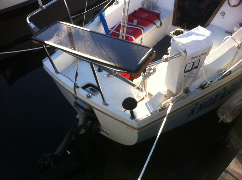

I ended up taking the panel back. I bought a 5 watt panel. This is just for keeping the batteries topped off. I could have gotten a 15 watt panel for a good price but it would have been hard to find a place to mount the panel. It would have also gotten expensive. I will see how this 5 watt panel does for now and re-evaluate later.
That it's what I did on my 27. Used 2 Magma grill brackets to attach it to my stern pulpit. The brackets cost more than the controller and panel. The 15 was good for about 4 days of continuous use here in Florida before we would pull in to top off on shore power. By that time a nice long hot shower in the marina was welcome anyway.
