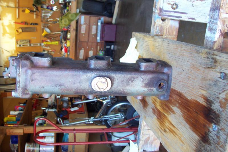

We have removed all the parts for the exhaust system. Two cracks were found and repairs were made. Waiting for the parts I have ordered to put it all back together.
I would like to find a replacement manifold so if the fix doesn't last I have a backup. The motor runs great so way not.
