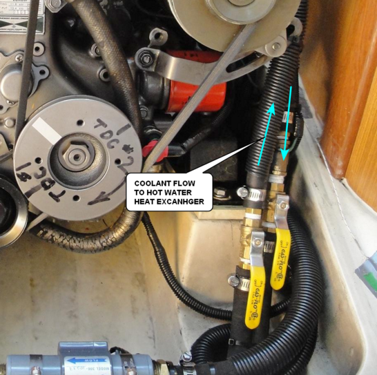

Please advise, if I don't want to have water heater, can I plug up the 2 holes at engine, 2gm20f, that feeds hot coolant to water heater circuit?

Yes. Take a hose connect from one to the other at the engine.

In order to deal with the possibility of a leak in the heat exchanger, I installed ball valves on the two hoses to the heat exchanger :
