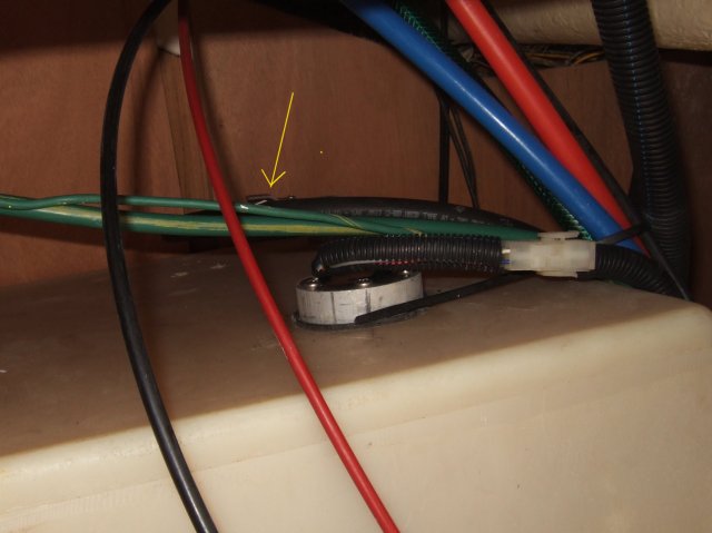

Want to replace the fuel filters before winter storage. I have a Hunter 326 and cannot seem to find fuel shut off from tank. Can only access tank from swim platform compartments and I do not see any shut off lever. Does this model maybe not have a shut off lever since tank is almost same level as motor and fuel filters. Also does Yanmar recommend specific antifreeze to be used.

Bigstick, the fuel shut-off is a small lever at top righthand forward corner of the tank. You need to stick your arm right in. If you stick your head in the locker, you can just about see it.

Thank you Ken. Must not of put head far enough in locker.
