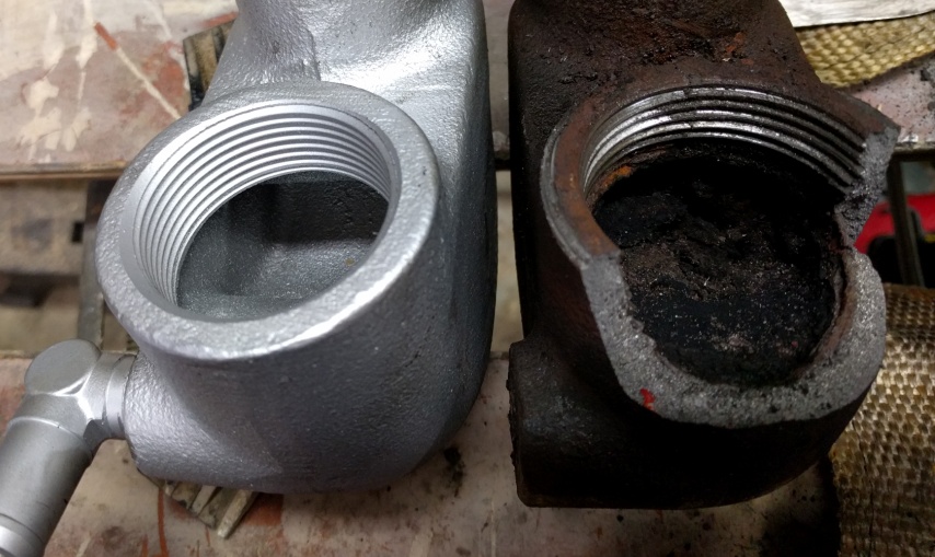

I had a simular problem. The exhaust I removed and ran water through and it didn't appear to have a problem, but when I separated the exhaust parts it was pretty obvious. a 1/4 inch or less passage for exhaust severely limits engine performance.
I'll attach a pic. Please take note. The coupler between parts is a combination of left and right hand threads (like a turnbuckle.)
That's why the old one is broken.
