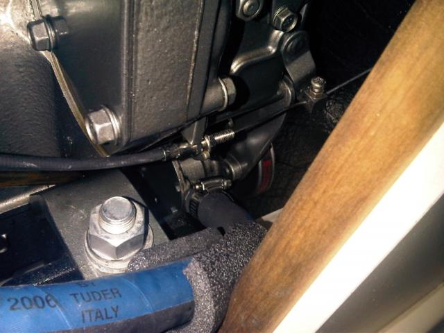

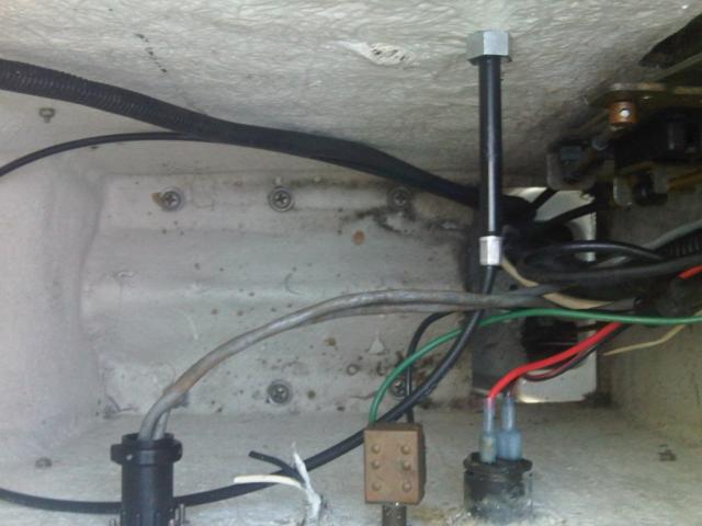

Photos of installation.
1) Cable inside helm with big loop
2) Where it attaches to engine.
You have to remove the deck behind the helm (4 screws) and the wall behind the aft bunk. Then just follow the other cable/wires to the engine compartment and remove the existing cable and replace it with the new one.
Joe
