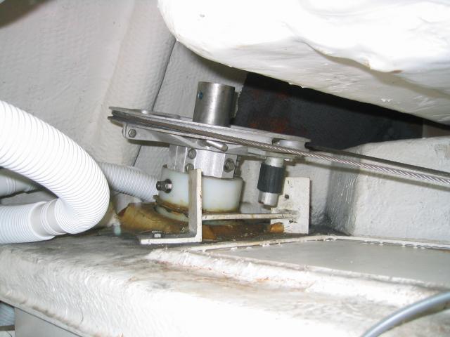

While I consider myself "fairly handy," I didn't think I had the skill or tools to fabricate my new rudder bearings. My boat has two round upper rudder bearings that require center holes cut to fit the exact diameter of the rudder post. I think these bearings were made out of Derlin. Also, on my 1986 H28.5, I could find no evidence that Hunter ever used a lower rudder bearing to support the rudder post where it enters the rudder tube. Shop I used was able to build a custom bearing for that area that I could slip over the rudder post and then into the lower end of the tube. Making this bearing required quite a bit of skill. In this area, the 3 bearings cost about $300 to make. See pic below.

Great photo, thanks. It looks very similar to mine. I wasn't thinking of fabricating my own bearings, just installing them was what I intended to do myself.
