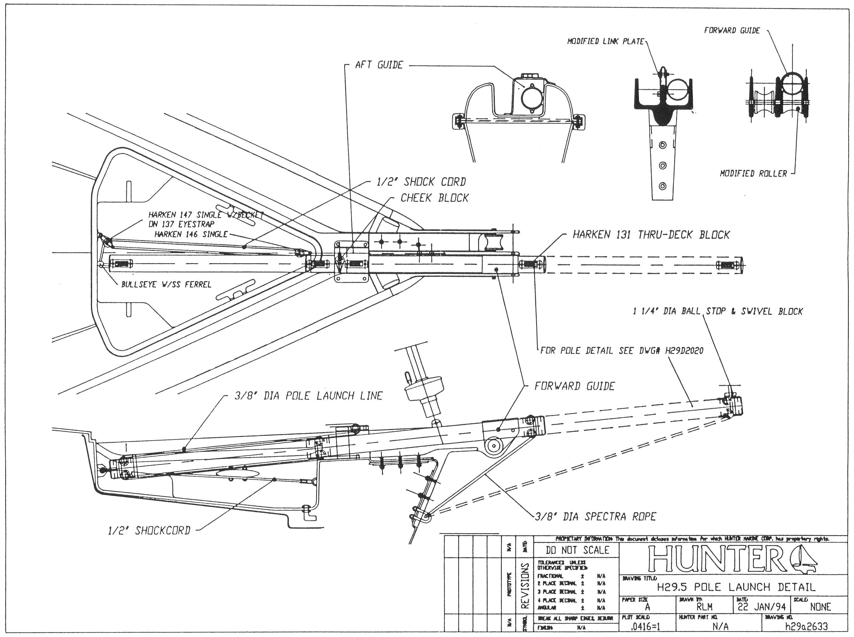

I have asked this before but maybe someone will see it this time with an answer. I have a 1994 Hunter 29.5 that has the optional retractable bowsprint for a spinnaker. The bowsprint was not rigged when I bought the boat. In the owners manual the pole launch detail drawing (see attatched) shows a pole launch line that runs aft to the cockpit, a 1/2" shock cord that retracts the bowsprint when not needed, a 3/8" spectra rope that is the bobstay when flying the spinnaker. There is a note that says for pole detail see DWG# H29D2020 that is not in the manual, nor can I find it in a 29 Manual. Does anyone have one of these that can send pics or knows how it is rigged? The pole has Harken131 thru-deck blocks top and bottom on both ends. Notice the 1 1/4" ball stop.
