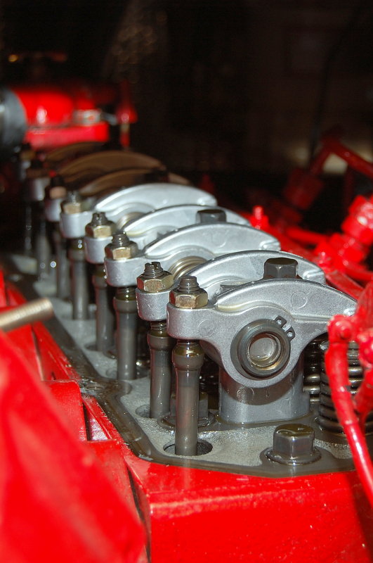

I have been doing some preventative maintenance to my engine and in the process wanted to replace the valve cover gasket. To say I was surprised at the condition and cleanliness of the rockers, top of the head and valve cover would be an understatement. Sometimes it's tough to believe a PO about their oil change/maintenance schedules but I now believe.
I have seen engines with 400 hours totally gunked up and this one has 2800. I think I'll continue my maintenance schedule. This engine has only ever had Shell Rotella 15W/40..

It's not only clean, it appears devoid of ANY oil - did you clean it and/or are you sure oil is reaching the top of the head?

Yes there was a thin film of oil coating the insides and that was taken before I cleaned it. The only reason I cleaned out the oil is that I will be re-painting the exterior.. Plenty of oil is reaching the top of the head, I know this because I inadvertently left my oil cap off last summer during an oil change and it took four hours to clean up... Plus remember this engine has been sitting since Nov so any thick oil drained back and only a thin film was left. I hardly doubt it would have reached 2800+ hours with no oil circulation..;)

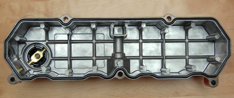

Mainsail, it doesn't [FONT=&quot]supprize me after seeing posts of your bilge that your valve cover would look so clean!

Here's the photo I promised. Don had hinted that perhaps I had cleaned the valve cover, and clearly I did not. There is no way to make the top end look this good at 2800 hours even with a tooth brush....;) Look close and you'll clearly see clean oil on bolt heads and in crevices, nooks & crannies.

With the exception of one valve being slightly open. How did you get all the valves to close at the same time?

It's the camera angle and only appears that way..

Maine Sail, tell 'em the proof is in the puddin'. Your valve trian pic's are like brand new and I must assume the bearings would look the same. Nice job and thanks for maintenance schedule and all your informative posts, I know it takes time. Mike in NC
