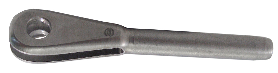

The set up is with common rigging hardware.
the shroud wire is attached to what is called a swaged fork.
I recommend you have them machine swaged if your thinking about this as a DIY project.
A clevis pin is used to hold the plate in place.
Many racers choose to change out the fixed back stay for an adjustable stay.

that's what I thought might be the case, mine is not a fork, just an eye, which did not seem right. I went ahead and ordered new fork fittings.
