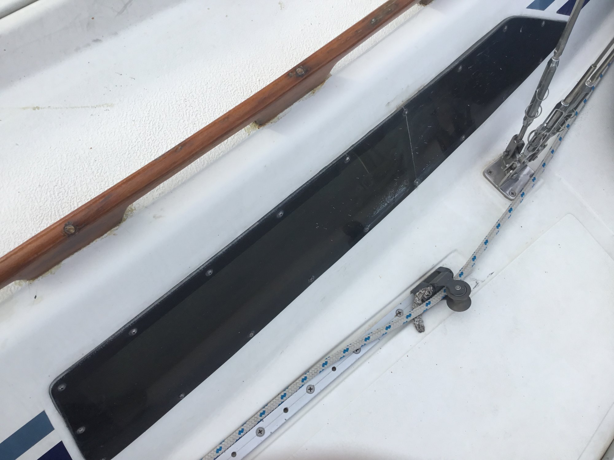

I have a 78 Hunter 28.5. one of the side windows is cracked and I’d like to replace it.
the approximate dimensions Are 7 x 45.5 and is about 1/4” thick.
I can’t seem to find a commercial replacement and I don’t mind cutting a new replacement. Anyone have an idea of where I can find tinted replacement lexan That I could use?

Measure carefully and go on line to Tapp Plastics. They can custom cut smoke tinted cast acrylic for you. I used them for new hatch lenses and they did a fine job at a good price.

I was going to use some Lexan (polycarbonate) but I found this article and it’s completely changed my mind.
incidentally, I think I will probably also replace the lenses on the two hatches of the boat. They are getting pretty old and have small cracks in them.

The SBO store sells ports- if you shop by model, you will see the ports available (yes, I looked for your model and there appears to be something) or you can give them a call. I got one for my 33.5 last year and was very satisfied
