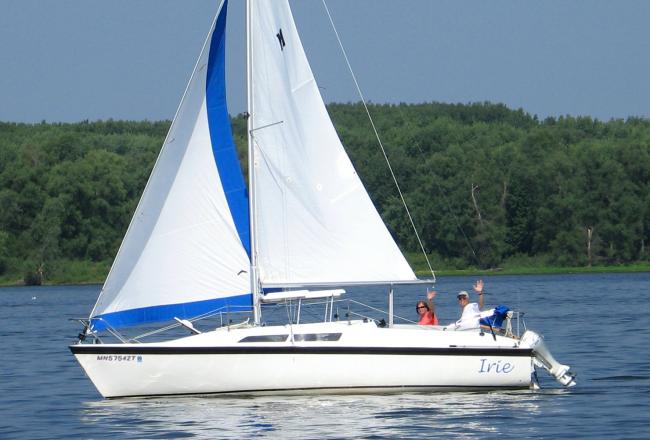

I think weight in the bow kills your speed when you're sailing, and to a lesser extent motoring, into any sort of waves or chop. The more the bow can go over a wave rather than through it, the less the boat will slow down. However, as with everything else in boating, you have to weigh that against other considerations, such as how much you're actually in rough weather and how much the extra weight will add to your enjoyment of the boat. Those are questions only you can answer and there's probably no one answer for everyone. The stern is broader and can rise up better so weight back there probably isn't as detrimental. I doubt the batteries under the galley have much effect, since they're in the middle of the boat. I keep a 5 gallon can of water and a large spare anchor in the bow, but if I'm going into a chop, I move them aft. BTW, that's a great picture.
