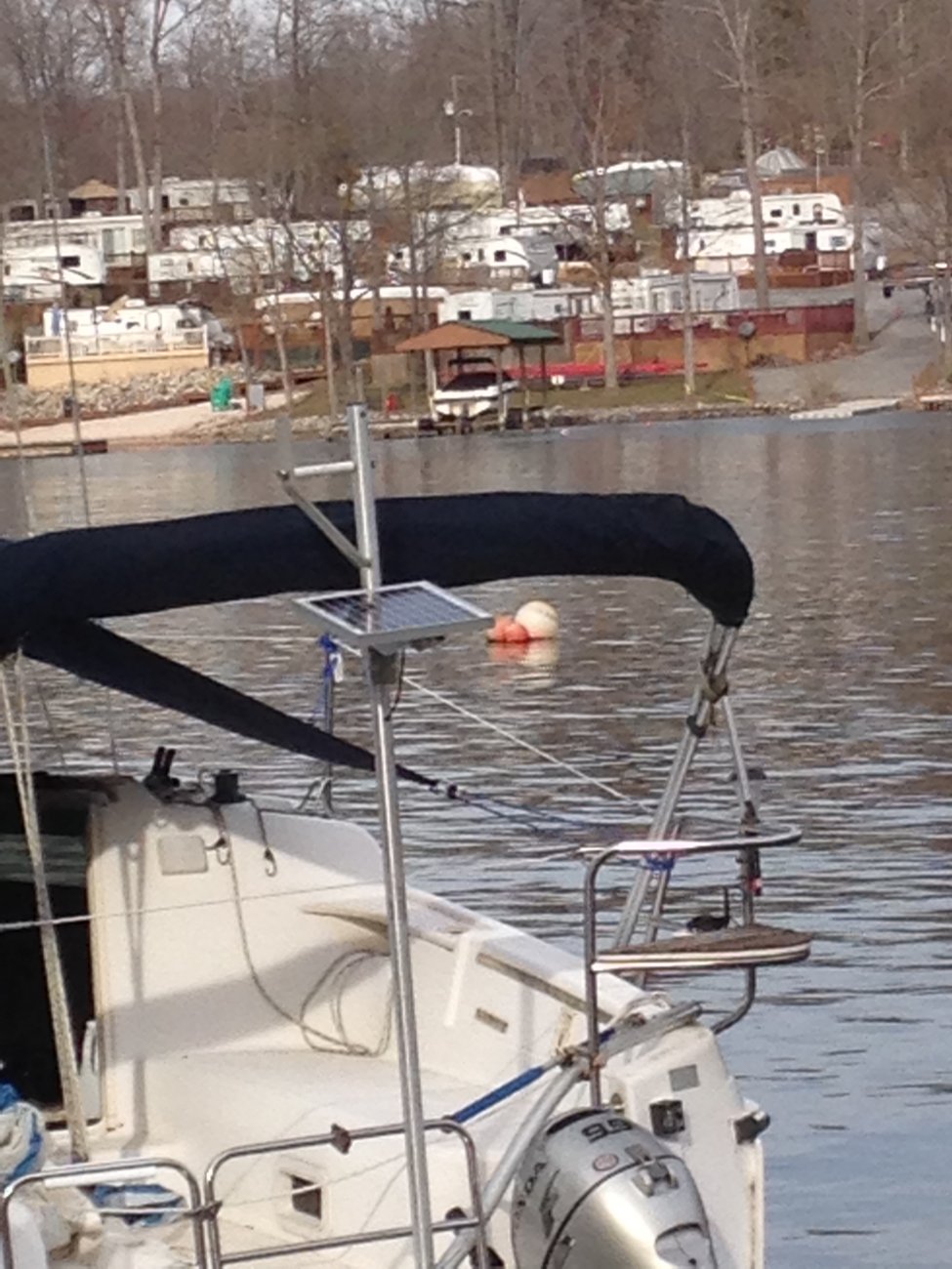

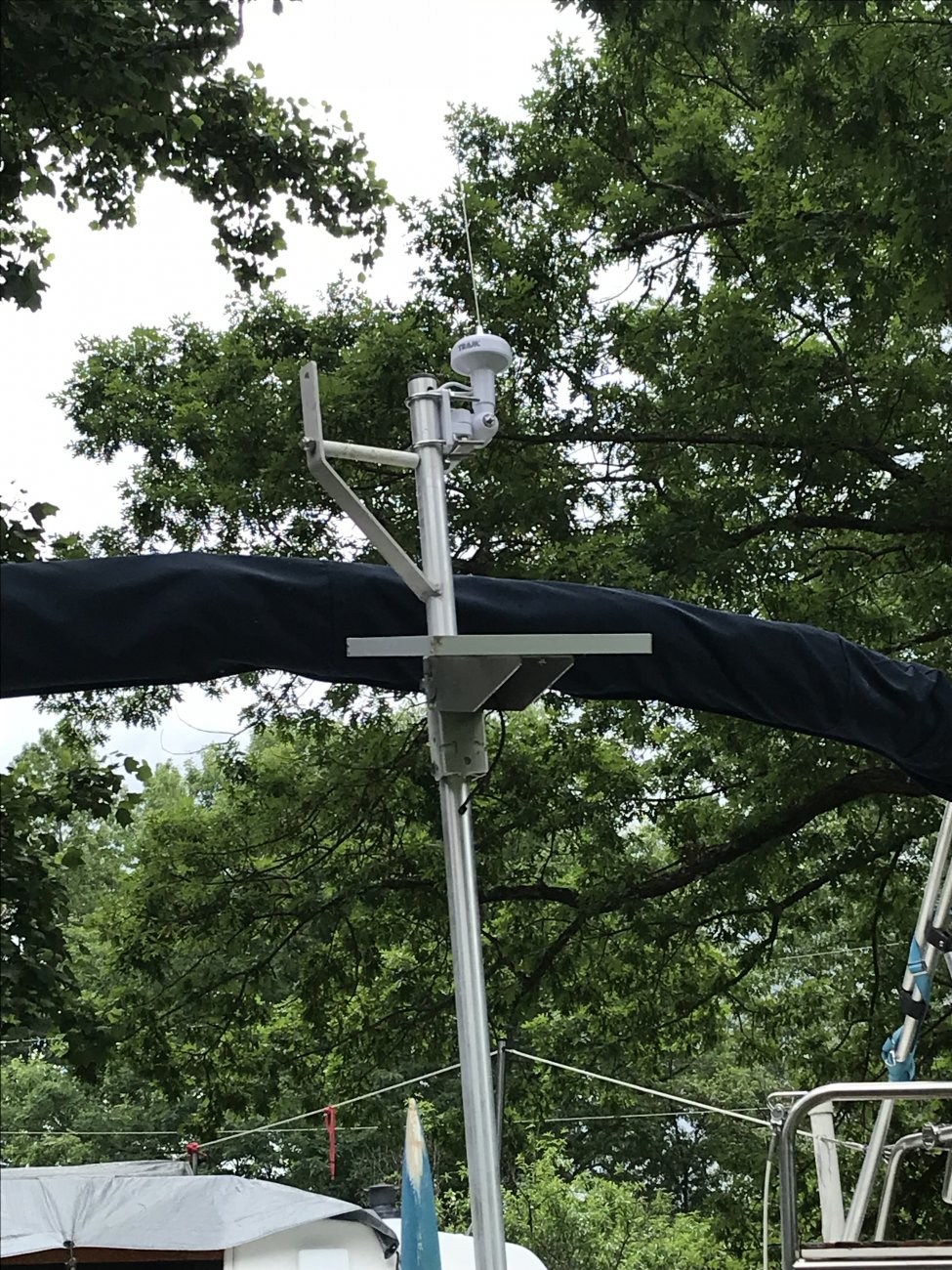

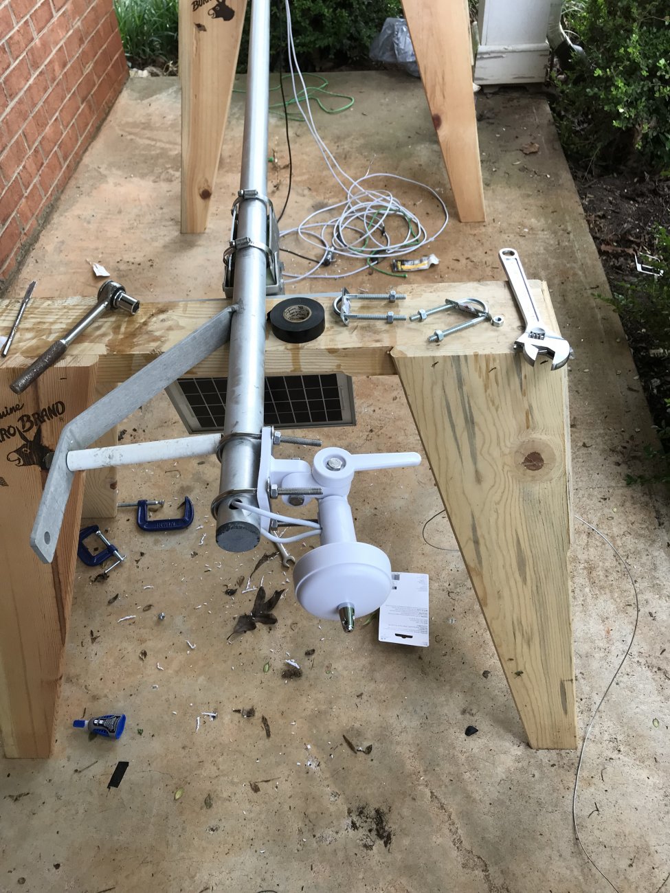

I do want to mount a Solar panel(s) somewhere. I would love to see your idea of how you mounted to the Mast crutch pole. I am thinking I would like about 100 amp panel to start with. We hope to sleep in that back berth. If you mount the charger to the back bulkhead did it put off much heat? also, did you mount it on the wood or the top liner? Dave, I will PM with more questions. I have been a fan of your amazing knowledge of 260 for a long time!! Thanks for all the help everyone!!
12,776
I did not have issues with heat on the charger but I didn't typically sleep on the boat at the slip and the charger is only operating when plugged into shore power. I don't have a lot of power needs and the solar panel seemed to keep my batteries topped off.

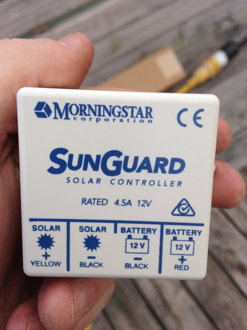

Thanks for the pictures. What is the amp of your panel? I was thinking I would like to start at 100 amp. I have seen that solar mount on Amazon. Thanks again
12,776
I think mine is only a 10. Like I said, I don't have a lot of power needs. I have three fans, cabin and nav lights and a VHF radio. I have already converted my cabin lights to LED as well as the stern nav light and anchor light. So once I convert the bow lights, I'll have even less power needs.
The 10 A panel has been more than enough for a week long cruise.

That looks a tidy set up and I will probably do a similar job. Hope you don't mind or object but this is a pet hate of mine, did you cut the U bolt threads back on the finished project? When I was an engineering apprentice I would have got in to serious trouble leaving all that thread.
I did also notice your tiller in pic#3. I wish my H260 tiller would go as far round as yours does, it looks so much better for lashing off at anchor or at dock.
12,776
.... did you cut the U bolt threads back on the finished project? When I was an engineering apprentice I would have got in to serious trouble leaving all that thread.

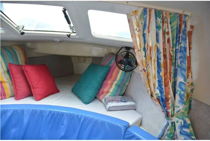

Need some photos of fans with location of wire running
Huh? These were the ones that were in there when I purchased from Jon. There is another on the port side and one in the aft berth. I have no idea where the wires run. They go someplace behind the liner
10,531
-na -NA Anywhere USA
Rgranger boat is a Hunter 26. The 260 took it over in model year 1998 but actually in August 1997 when first built. The wires for the fans are tucked away between the ceiling liner and deck. Drilled hole and fished a snake or wire between the two down to the bottom of the ceiling liner tucked just behind it running aft to starboard. Tricky part is running the wire above the galley. I think on the 260 a channel was put in but in most cases pinched which was a pain. I use to pull back the carpet to run small wires and glue it back in place. The reason for hiding the wires was first looks and second little sticky fingers not getting hold of them.
Running wires or to get to those wires for the light, I would on the 26 channel leading to both sides of the boat in ceiling liner adjacent to compression post, I would drill for an inspection port or a cover by teak or whatever to get access and then snake over to the starboard. Sometimes it was difficult toward the starboard side of the ceiling so I cut a small hole to the diameter of a plastic tan insert that you can buy at hardware stores for example Ace but probably thru the forum store. and then following the above. On the 260, I recall there was access to those channels but a photo of them near the compression post would help.
I spoke to the poster advising to nstall a table style plate on the 260 just aft of the rear of the rear berth bulkhead which can be removed by removing the bottom screws but it is a tight fit coming out down and then turning to the starboard with it to get it out of the way. However, there must be an inspection of the backside for anything attached to the rear of that bulkhead like wires. As for the plate if wood, encase it with fiberglass and then sand smooth and spray paint with tan Krylon plastic paint. There is a channel on the upper right starboard for wires encapsulated by the foam.
If running wires from electrical panel to thru hulls I would get them over to the right side or starboard and running them down underneath the rear berth platform to the thru hulls. I would pull the carpet back adjacent to the galley and glue the wires in place and recover the carpet. IF RUNNIGN WIRES THRU BULKHEADS AFTER HOLES HAVE BEEN DRILLED, TO PREVENT CHAFE, GET THE BLACK PLASTIC PLUM OR CORROGATED BLACK TUBING CUT IN HALF AND PUT AROUND THE HOLES!!!!
