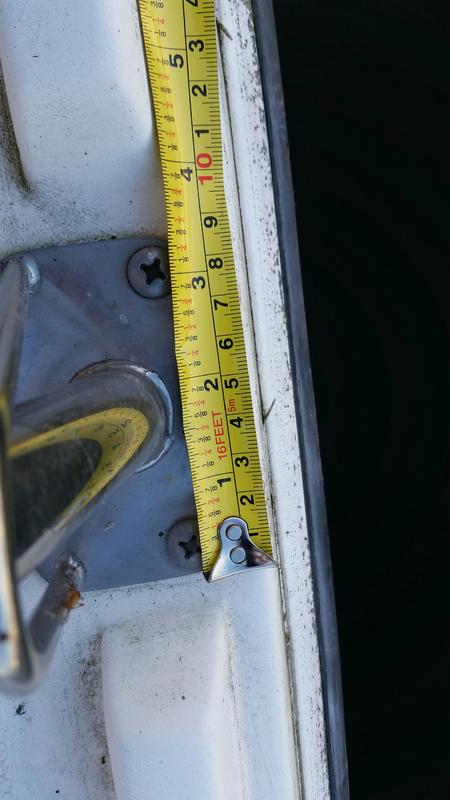

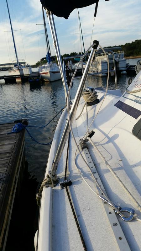

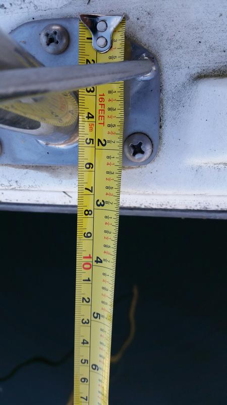

Visited my 1987 26.5 a few days ago and came across a severely bent stanchion. I've included a few pictures for review. Couple of (initial) questions:
What in world did this?!? - my only thought was somebody was taking a fall from the dock and decided to grab my stanchion to stay upright.
It appears to be the base that buckled. I don't think the post is separable from the base so I've begun to search for a replacement as I'm afraid to try to 'bend' back in fear of damaging the deck. The bases are different on the shop.sailboatowners.com site so I'm asking if anybody has suggestions and/or recommendations.

While removing your stanchion may at first seem like a huge project...
It's the first step.
You may need someone to hold a tool on one side while you work on the other.
Once it is off the boat, any good SS Fabrication shop can repair it and buff it out like new. Better, most likely.
I have had bent stanchions and pulpits repaired, and the results are 100% invisible.
If you cannot find such a shop/person in your fair city, I would guess that some of your list-mates can suggest a name nearby.

If you are not able to see any nuts/washers inside the boat, the bolts are probably screwed into an aluminum plate encapsulated in the fiberglass deck structure which was typical for Hunter. I am not sure as it has been many years ago when I sold that particular model but wanted to add my two cents worth. You will hear to use butyl tape, silicon, 4200 and others. Do not use 5200 as a sealant when replacing the Stanchion. Also when going thru the site store, include a photo and diemensions of the stanchion of one not damaged to include the base.
